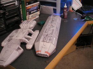

I may be ummmm slightly off on the page count. I just printed pages 6 through 10 of the original file and it came out at 40 pages even... LOL. Just a warning for anyone who wants to follow in my footsteps!

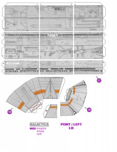

Here's an example of how I split the page into pieces: You can see where I've divided the Part 17 into sections and added letters to the glue tabs for reassembly reference. Each section goes on one 8.5 x 11 sheet. The lower piece part 18 had to be split just at the middle line on the bottom section as shown.
I'm working on the rest of the midsection today, I'll post progress pics later. Stay tuned!

Gearz put together a fantastic model and the textures are outrageous. I can only imagine how sharp it would look if I was using a laserjet instead of inkjet.

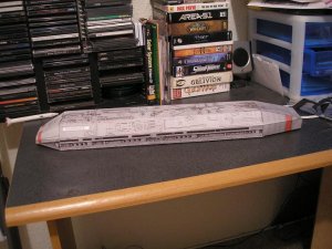

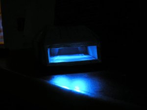

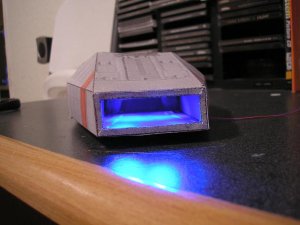

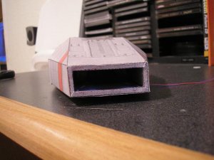

Okay, a few shots of one of the landing bay arms, with lights!!!!
Keep in mind, this is before touch up work, so the end looks rough and the bay cap is still dry fitted.
To light the bay interior, I cut slots in the roof of the bay about .25 inch wide and placed a double layer of cellophane tape over the openings to diffuse the light. Two blue LED's centered over the back half provide the illumination. I covered the LED assembly with a layer of aluminum foil to both increase the brightness and stop light leakage.
Landing bay, lit (on approach to land!!!):
Landing bay, unlit (you can see what a difference the LED's make!):
Shot in the dark:
From the side:
With our original for size comparison. The bay is bigger than the whole ship!

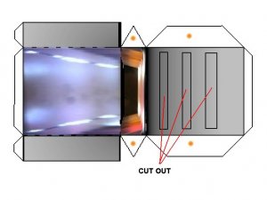

A little more detail on where I put the openings in the roof of the bay:
You can see where I cut out the sections. I then put a double layer of cello tape over the OUTSIDE of the part before gluing.
