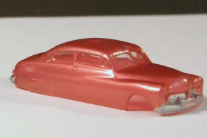

The second car I did was the red one, I'm kind of satisfied with the paint, gave it 3 coats, and the paint came on nice and smooth, so I thought that I finally figured out how to use the paint, 1:1 paint / thinner for airbrushing. So on to the next one, first coat went on nice and smooth, waited 24 hour for the next coat, DISASTER!!, on one side of the car, the paint is nice and smooth, on the other it started to lift/peel??

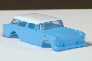

Here is the blue car, and as you can probably understand why I'm NOT very happy with that result

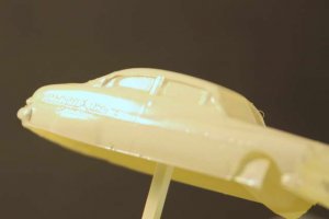

and this close-up of the beige car shows where the paint has lifted a bit. It's weird that it's there and on the back, the rest of the paint looks ok.
I can't decide if I should strip the paint from the blue and beige car and try again, or if I should just finish them, and just make sure to place them correct so they show their 'best' side.

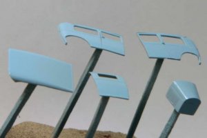

This one was painted using gray primer and some light blue spray paint I bought at Pep Boys today. It's so much more convenient to use spray paint than using the airbrush (if you can find the color you want), no cleaning of airbrush or paint bottle, no mixing paint, no waiting 24 hours between coats. It to me a total of about 1 hour from the first coat until it was done, but only about 5 minutes actually painting, 1 coat primer, 2 coats of light blue. Easy.
