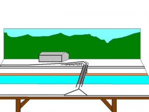

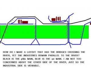

I am starting over, AGAIN. I want to see the layout from the river view, as the mainline parallels the river, and the smaller railroads cross multiple bridges going from blast furnace to rolling mills, etc. The area I model has 3 to 4 bridges that cross the river at a 45 degree angle, making it difficult to make a trackplan. I know that my reach is 2 1/2' at best, how do I make a trackplan to incorporate this all? 11' x 10' area.
If I am correct that your main concern is reaching the far side to correct problems in operation and so forth, have you considered an access hatch behind the factories, or perhaps one of the factories itself if large enough could lift out and give you the needed reach?

- 4 bridges, all (?) crossing at 45 degrees to the river

- Why do you show the bridges at 90 degrees, rather than 45?

- Setting the bridges at 45 degrees will require more length, but might save "depth" by reducing the amount of space required for the curves to get the track back parallel to the river.
Hope that helps.

- 4 bridges, all (?) crossing at 45 degrees to the river YES(I guess I mean 90*)

- Why do you show the bridges at 90 degrees, rather than 45? I goofed my math
