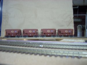

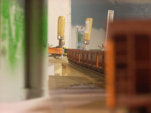

Too much?
Does this liook to big. The engines can puse cars up it fine, and the transition on the bottom was just fine, and let mr tell you, my tunnel motors are FUSSY about the track, but this was no problem, I might be able to raise the ore dock height now, and rebuild that section of benchwork (even though I just built it and used my last piece of wood building it:cry:). I might have some scrap in th garage:idea:(Ive always wanted to use the egg guy) .
But anyway, here are 2 pics of the incline, dont know what happened to the second one, but the layout is way down there and Im way up here and lazy, so no new pic, hope it doesnt make ya dizzypeasoup.

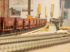

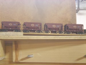

I think it looks too unrealisticly steep and besides, taconite pellets are spilling out of the cars on their way up:eek:! I think Ill tone it down a notch.​
This look better? I tried again. Dont be confused, both pics were taken from oppisite sides, the second one better shows the incline.

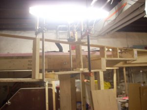

Here is what the first three feet of incline looks. This should workout fine.
Acctually I think it worked out great, the train Gods were quite impressed and visited, hence the bright light in the final pic, or that might be my flourescent light?
