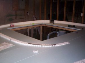

this is how i am making mine its woodlands secnics foam risers system the one in the pic is the 2% grade one part of the risers is 16 feet long so the hole thing you see is 24 feet long end to end and at the top of the grade its 4" high
they make a 3% and a 4 % also the 4% is 8"feet long so with the up and down it would be 16 feet in all . and remember to buy two one to go up and one to come down
