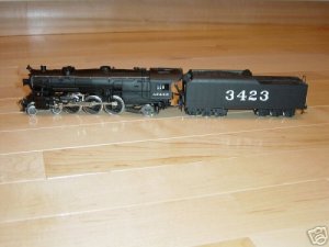

How difficult do you think it will be to DCC equip the Rivarossi 4-6-2 heavy pacific steam loco with decoder and sound?

I think it should be fairly easy. If I remember correctly, Rivarossi uses a wire from the locomotive frame to the motor for one pick-up and a wire from the tender to the motor for the other pick-up. If that is the case, unhooking the wires from the motor isolates the motor from the track pick-up. You should have plenty of room in the tender for the electronics. Just install your decoder and wire it up per manufacturers instructions. One of the guys in the modular club I belong to hides his speakers under the coal load on steam engines. He drills small holes in the coal load to let the sound out, and then glues individual pieces of scale sized coal over the holes to hide them from sight.
Russ's advice is right, put the decoder in the tender (which definatly has enough room for one and a speaker).
Probably be a good idea to get a small quick disconnect to fit between the tender and loco, since you'll have 5 wires leading to the engine (2 for the light, 2 for the motor and 1 for the pickup). Of course you could also get a firebox light and have a 6th wire between, so best to get at least a 6 socket quick disconnect (Loy's sells these, but you have to solder the leads onto the female end, of which i have problems doing ;) )

Any suggestions on which brand of decoder with sound will work the best with my MRC Prodigy Advance DCC system? How expensive are the decoders with sound? this will be my first install so I am a little nervious. Also I heard something about Rivarossi locomotives having a history of poor power pickup and wonder if I should bother equipping this one for my layout...any input on this issue?

The Prodigy Advance is built by Lenz. Thus, it should be compatible with all NMRA compatible decoders.
MRC builds a steam decoder, it's relatively cheap. But, you do get what you pay for. Soundtraxx builds a steam decoder as well. The Soundtraxx unit is expensive, but has much, much, much better sound quality. You might also look at MRC's stand alone sound systems. They are remote from the locomotive, but the sound is much better. They really aren't synchronized, but again the use of real speakers allows for really good sound reproduction and you can have sound with all your locomotives, not just one.

Rivarossi uses the old system of having pick ups on one side of the locomotive and the other side on the tender. Make up pick ups for the other side from brass shim stock rubbing on the backs of the drivers. Solder wires to this shim stock and hook it to the same wire that comes from the tender. Use a piece of thin styrene with plastic Kaadee screws to insulate the brass from the frame. Then if you want to, mount one tender truck backwards so the tender picks up from both sides of the track as well. You will have to isolate both tender trucks from the tender frame and run wires to the decoder input from the tender as well. That will improve the pick up tremendously. If you choose the MRC stand alone sound system, you can use a t1 decoder, under $20.00. The t1 works fine for two functions-speed/direction, & lights. I'm not sure if the MRC sound decoder will run the train or is just sound. I heard one demonstrated in Carson City for diesels and it sounded great, but I don't know if that was in the locomotive or a stand alone.

WOW!!! That sounds a little complicated for a novice like me to accomplish. Maybe I should just buy a unit that has everything already equipped?
Adding the extra pick up isn't as difficult to do as it is to write. Do you have any hobby shops near by that has anyone to help you convert it.
