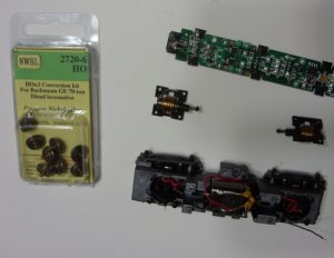

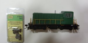

I also have a Bachman HO GE 70 ton diesel which I am about to narrow with NWSL wheel set, following the article by the Hauf brothers in the August 2008 RMC . @ our the Club I have been keeping a MDC 2-8-0 on the narrow gauge at the club , as none of us want to leave any of our shays there. The top end of the grade is too steep for the consolidation, so I'm building the diesel, so we have a resident locomotive that can make the grade

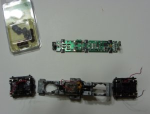

SML GE 70 Ton diss #1.jpg SML GE 70 Tonner diss #2.jpg With the article as a guide, this is going pretty quick, and isn't as scary as it would be other wise.
I got the trucks off and chopped up. tomorrow , or the next time I get back to the engine shops I need to make the modifications to the wiper plates, trim down the spacer bars on the truck side frames, and make styrene spacers to fit between the trucks frames and the wiper plates.
so far it has been easier than I thought, a fun project.

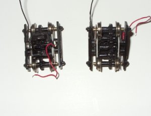

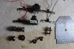

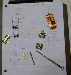

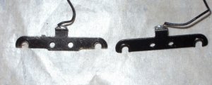

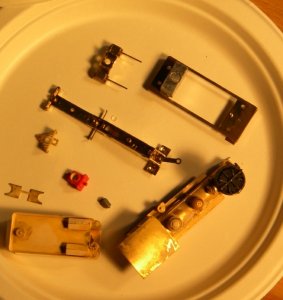

SML nrw gua trks.jpg SML pickups.jpg SML trk pieces.jpg work on the trucks
The way the truck is set up on the unmodified locomotive, is the axles are cradled in the truck frame with a brass contact strip with u shaped openings on the outside of the frame, and the axles retained by a clip on cover.
The modifications involve cutting off the end of the truck part of the contact strip is cut down and a brass bar is soldered on so that the contact strip has axle holes instead of U slots. Plastic shims are added onto the pins that hold the contact strip and the side frames on the truck, pushing the contact strips outward, making them the outside frame for the wheel sets made out of the factory gears and the Nwsl wheel set.
The top picture shows the assembled Hon3 trucks. the one on the left is right side up and the one on the right is upside down, sorry that black plastic sucks up the light so the detail on these photos is not as good as I would like.
The second photo shows two of the contact strips. The one on the right is unmodified and the one on the left has been notched for the brass bar than encloses the axle hole.
The bottom photo shows most of the truck components ready for assembly, one standard gauge axle , one narrow gauge axle and a set each of the factory wheel, and the NWSL replacements.
The locomotive will be ready to reassemble after I do a thorough cleaning of the truck mechanisms, to be sure some plastic or metal debris din't land it the grease around the gears. perhaps I can get it ready to go to the club tomorrow night.

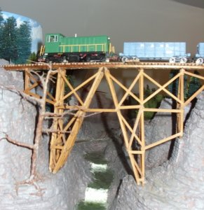

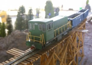

SML GE  70 tn.jpg SML on the nrw ga..jpg It is together! putting couplers on it was as hard as narrow gauging it bit KD 714's are a challenge even with the jig.
here are some pictures of it now. I'm calling it finnished, although it may go to the paint shops at some time.
here are some pictures of it up on the narrowgauge
. the lower photo was taken without a flash, but is somewhat washed out anyway. the rail head @ this location is about six feet two inches above the floor, and way to close to the tracklights for photography at that angle, but that is the angle that shows that this thing actually sits on the narrow gauge.

In the photos of the little GE unit, it has the glare on it because it is just too close to the track lighting to make photography easy.
Bill Nelson
The little ge is at the club. I tested it on the steep part of the grade, and it could handle five hopper cars and a caboose, I ws going to add a flat car or a coach, but the power went out. I took my camera, but it was out of batteries. maybe I will add photos next week.

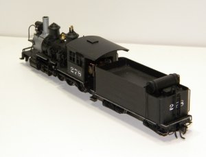

SML 278.jpg not much of a project!

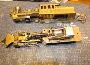

I have acquired a Westside C-16 #268. I was surprised, as it ran ok right out of the box, and after it had had the brushes on it's open frame motor splashed with contact cleaner, it ran quite well.
This locomotive has a quite nice paint job. Luckily the tender wasn't lettered as if it had it would have had to be redone anyway. It is numbered, and 278 might look slightly out of place on a railroad which has only single digit numbers so far. For the State Line I usually paint the cabs green with a red roof.
With HON3 locomotives I almost always add extra electrical pick up right away, but I may wait a while with this one, as it seems to run OK as is.
Locodoc makes a remotor kit for these that turns them into fantastic runners. this one runs well enough right now so that I don't have to make that step right now. The Locodoc kit for my FED will take prority.
Time to light the fire to burn some chickens, and maybe I can get couplers on this critter while the fire gets ready to BBQ.

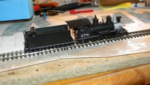

SML 278 #2.jpg SML  #278 no more..jpg SML GE W trn.jpg here is a photo of the GE unit on the switchback at the club, and a photo of my C-16 before and after the cab painting (acrylic craft paints via brush), and the obscuring of the 278 on the tender and smokebox number plate.
I often change the details on a brass locomotive to obscure it's origin , but 278 is one of my favorate locomotives ever, as well as being the single most identifiable C-16, since it had a sand dome that was altered to give it more capacity, making the sand dome taller than usual. The green cab with a red roof will help give it a "family resemblance" with other State Line Railroads .
Besides lettering and numbering it for the State Line Railroad, I will probably give the smokebox the #2 pencil treatment to make the smoke box less silver and more graphite .
It runs very well as is, but I plan to pull it down to add electrical pick up to the insulated side of the locomotive, and to add a hardwired connection from the locomotive to the tender, and I will consider adding pick up to the insulated side of the tender trucks as well. When the budget allows it will get a remotor kit from Locodoc, but the FED 4-4-0 will probably need that more I will have to complete the electrical pick up modifications to both locomotives, and the one that runs best will get it's Locodoc motor last.

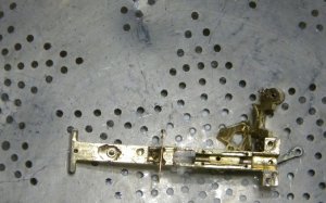

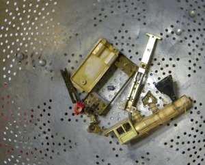

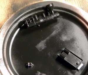

SML prts in the strainer.jpg SML prts nt pnted.jpg SML undr th hlgns.jpg SML wht mtl prts.jpg paint shops!
The C-16 looks good, and a little less "Colorado". with couplers, it can go into service for now. later it will need improved electrical pick up ( a good idea on all brass, and on all but the best engineered locomotives).
Before the C-16 showed up the next project on my list was my little FED 4-4-0 .
These were imported in the late 70's by Far East Distributors, which was a division of NWSL made to sell inexpensive products, without diluting the excellent NWSL. FED imported HON3 2-6-0s and 4-4-0s
They cost about $38.00 new, about a third of the going rate for brass at that time. They are tender drive, and have no pick up on the locomotive, and this made them horrible runners as the tender rock from the torque of the tender drive would break the electrical conduct making the operation very jerky. Due to this they got horrible reviews, and they just sat on hobby shop shelves
Years later it was figured out that you could add electrical pick up, and a better motor and make an exceptional running if somewhat plain locomotive out of them, and with some extra brass castings they could be made into stunning models. Boone Morrison wrote some articles in the Narrow gauge and shortline Gazette, and they disappeared off of the shelves.
When they came out I was planning on buying one a week until I had lots until I read a review. I wish I hadn't seen the review, cause at that time I was routinely adding pick up to brass locomotives. Now 35 years I have one each of the 2-6-0, and 4-4-0. the 2-6-0 is already painted , reworked with better electrical pick up. and equipped with a Loco-doc remotoring kit. I'm painting the 4-4-0 right now, will add the electrical pick up as it gets put together, and the locodoc remotoring kit will follow as funds for it become available.
I have several steps to painting brass. the first step, which I left out this time, and if it bites me in the *** I will deserve it, is to take the parts of the disassembled (excluding the motor gears and axles & wheels) locomotive. and soak them in paint striper to remove varnish that was sprayed on the locomotive to keep the brass from tarnishing (some brass models were sprayed with brass colored paint, to hide differences in color between various brass parts). after they have been soaked I scrub them with a decommissioned tooth brish to remove any remaining varnish or paint.
Then I boil those same part (still excluding the motor ect) in soapy water to remove any grease, or remains of flux. after bathing in boiling saopy water for ten to fifteen minutes, and then put them in a colander, and rinse them in hot water. (after they have been boiled, rubber glove go on so the brass does not get contaminated by oil from my skin)
from there they go into a pan full of vinegar, placed on the stove and heated for another 15 minutes, then it is back into the colander, another long rinse, and then I put the pieces on paper plates, and put them under my halogen work lights, and leave them under the lights for a half hour or more which will dry all the remaining water, and get the brass warm so the paint will dry fast and bake on .

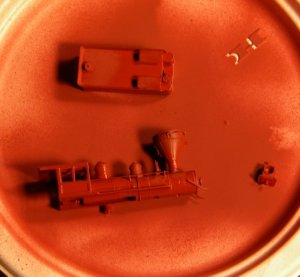

I spray them with red or grey auto body primer first, let them sit under the lights until the paint set's up. and then turn the pieces over and hit the other side. after both sides are primed, and the primer is set up hard, I spay it with a high quality spray paint can. I used to believe in flat black, but now I do satin black (years of excellent management has made my railroads much more profitable, and thus the amount of maintenance that can be afforded has been increased greatly.
I pulled the locomotive frame and cowcatcher out of the vinegar quick, as I don't have much experience with the vinegar on pot metal so I pulled the pot metal locomotive frame, cylinder saddle, and cowcatcher quicklt from the hot vineger.
Bill nelson
more later.

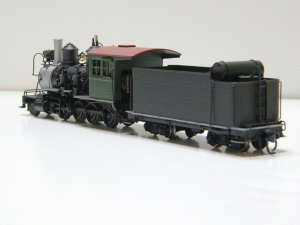

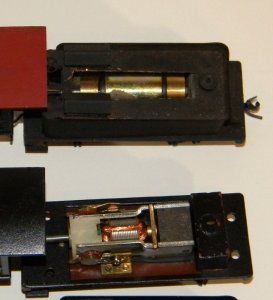

SML 2 FEDs.jpg SML blk spry pnt.jpg SML mtr comp .jpg SML rd prmr.jpg well the 4-4-0 is black now. I have photos of it with the 2-6-0. the 2-6-0 had the cowcatcher removed (it will fet a freight pilot when I can figure out how to do it), and the stack and bell replaced. The 4-4-O got a new headlamp and stack. both locomotives got a numberplate for the smoke box with their # on it, which is a nice touch.
I took a picture of the 4-4-0s tender with the shell off next to the 2-6-0, so you can see the difference between the Locodoc remotor kit's motor and the factory motor. The locodoc motor is just slightly too wide to fit in the tender shell, thus the slot, which will eventually get covered up by a wood load. The locodoc motor, besides the twin flywheels, as a lower start speed and top speed, and is very much worth the pricey price.
Next thing to do is to give the 4-4-0 a red roofed cab, and to paint both cabs green; and do the #2 pencil trick to the smoke box for the authentic graphite look. Then it will be time to start adding electrical pick up to the 4-4-0. lettering the C-16 , and these two for the state line RR will be a bear, but it must be done sometime.
