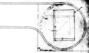

Here is a basic blue prints that I have drawn. I am using 32" and 34" radius. I think that is the best. Now the drawning.
This is the "mountain" end. The helix will be enclosed. In the center of it, will be cut out for someone to get inside. (I was wondering how I would get the trains if they derail back by the wall!:cry: :eek: :mad: )
The back tracks will be elevated from the front. Next question: What should be the grade of the helix? I only want to go a few feet from the front. Speaking about the front, I used 32" and 34" radius for the snake. That should be good for the passenger trains!;)

Gary: your grade is the product of your radius and how much clearance you need+thickness of road bed & track. Check Hoss's thread on the helix. How much grade you can stand depends on your pulling power and train length.

Atlas says.......
Jon:
I added the information to Atlas's program. Here's what came out of it.
Radius:34"
Total Height:39.4"
Height Between Levels:3.9"
Gradient:1.1=1.8%
Total Stories:10
Height of one story:3.9"
Total Lenght:2136.3"
Radius:32"
Total Height:39.4"
Gradient:1.1"=2.0%
Total Stories:10
Height of one Story:3.9"
Total Length:2010.6"
If you compare the number, they are the same or very close. I think this might work!
