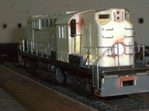

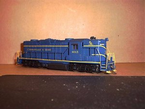

Here's an AHM GP18 with railings I made and a Model Power RS11 that I am working on.
I've been looking for a bell like the 1 on that C&O GP. Can you give me any info about it? Never had much luck w/the SV stanchions. Found them about 3 scale "'s too short which just does'nt look right to me. Also the lip on the back did'nt fit Athearn's GP38/40 etc.
Don
Don,
The bell on the C&O GP is a Detail Associates bell on a scratch-built bracket. Details West makes one similar but it didn't look close enough to the C&O style.
