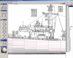

HMS Norfolk bridge sections
Hi All
Added the main blocks of the bridge to the design, changed tactics a little each piece is tested individually in Pepakura to ensure it will unfold it helps me a lot.
Trying to use someone elses drawing is confusing, as I use Metsequoia to help me see how I will assemble the various bits.They are helpful in seeing someone elses visualisations
If anyone is having difficulty in starting with metseq I will try and set down the crude methods I have used so far.
barry
Wotcher, bazzer!:)
Very interesting method of checking the fit of parts, explains a bit how you develop your awesome designs, mate.
She's looking superb! I am just amazed at how you pull these model designs together. Yes, do explain how you do it! I, for one, would love your explanation and tips on using Metsequoia; God knows I need all the help I can get working with computer programs.:wink:

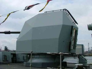

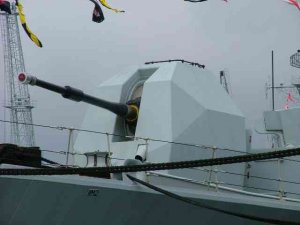

With regard to the main gun - later Type 23's such as Monmouth have a faceted gun, much the same size at the rounded version on Norfolk. I think i included a few photos of this gun on the CD I sent. Is it possible to include this instead as being faceted it should be easier to assemble?
What do I know about designing!!!!! Let the experts do their job Carl!!!
Seriously though, I am very much looking forward to the release of this. Magnificent work Barry......
best regards
carl
Kryton gun
Hi carl
don't worry it can have both providing the rest of it works out (should do now).
