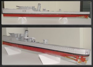

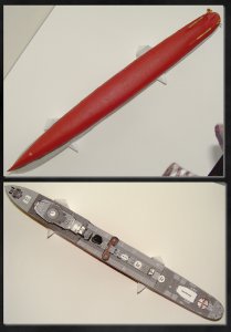

Here are some pix of the HMCS Ottawa II build I am working on. I started with the HMS Glowworm kit from GreMir.
The ships are almost identical so there are not many changes to make. Hull number, Maple Leaf on funnel and hedgehog projector. I am presently trying to locate info on the type and location of the hedgehog projector.

Thanks for the picture, now I have a 3rd possible configuration. Hopefully the museum can provide some definitive information.

A little more progress. This model has very good fit and I have experienced no problems. If I had one complaint about this design it is the layout of parts on the various pages. The parts for a single structure can be spread out over several pages. I could understand this if the parts were very large but for the most part they are in the small to tiny range.
Hello B-Manic.
Great progress, and very precise building of "X" gun mounting but please note that for accuracy, the aft set of TT were landed before she entered service with RCN and 20mm single Oerlikons were fitted on deck, port and starboard of their location, as per my fitting list that I sent to you earlier.
Very best regards
beejay

thanks beejay. The aft TT and X mount are just dry fits.
It's the build them all and fit the best to the model theory. I appreciate all your input and the information you posted. I have started scratch building the depth charge rack(s).
