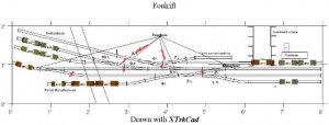

Here is my track plan and I indicated where I think the feeders should go.I would appreciate it if you would check it out for me Thanks-Bob

OK here's my slightly changed version of you plan.
The two feeds with squiggly red lines through them are not needed.
You need insulated joiners in four places where I've put the red lines across the tracks. It's safer to say put them on both rails at these points though this may not be necessary .
As a rule of thumb you need to use insulated joiners at the opposite end of the switches where you would get two feeds "colliding". This is an absolute necessity for the live frog points and advisable for the dead frog ones.

Peco switches
Tom-Thanks-In a reply from Peco they state that nothing has to be done to the switches unless I'm running DCC or powering the whole layout instead of power routing then I would need insulated joiners but since I'm not and I have tested the track and so far so good. Thanks Bob
