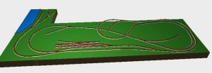

Here is a 3D view of the layout. This is to scale and was created with 3rd PlanIt, so this is what she would look like.

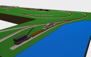

Here is a better view of the port. This water line was drawn in about 30 seconds and you could make it much more interesting with a possible stream entering it, giving your trains some bridges to cross. The shore could be longer too, giving you way more detail along the coastline.
Well, there you go. I hope this gets yer brain juice flowin'. :thumb:
TrainClown :wave:
Oh Wow! Thanks for taking the time to design that, TrainClown. This is exactly what I was looking for on what to do with my layout. I can't wait to get started and I will definately be posting up pictures of my progress. I like the idea of a river feeding into the coastline and adding the coastline to the layout is something I hadn't even thought of and now that I've seen it, it's a great idea.
Thanks again TrainClown and everyone else's input!
