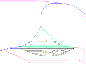

I’m having troubles turning the actual track in Green Bay into a feasible layout. I really want to incorporate the GB&W yard into my model. It’s a very interesting yard, but small enough that you can almost do it to scale in HO on a 16x4 area. I’m not too concerned with accuracy to the nearest foot or anything, but I do want to use the general layout of the yard.
The first picture is the actual prototype design. The blue line is the GBW mainline. The green is the A/D tracks. Black is the main yard, engine tracks, caboose tracks, and RIP tracks. Purple is the CNW yard and mainline. Red is the Milwaukee Road mainline and yard. The orange was used to connect to the old GBW yard along the river (just west of the purple/red mainline) and to interchange with the Milwaukee Road yard. It will be used as the drill track in the model. Most trains did not by-pass the yard on the blue mainline, but stopped at the yard to drop-off or pickup cars, refuel, etc.

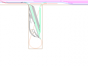

I attached one of the possible designs I drew up. The red and orange lines drop down to the lower level before going under the yard, but I'm not sure of their grade to get the needed clearance.
Lastly, I'm not sure how I would setup the reversing district in the yard, since its a giant wye.

The peninsula in my design is was supposed to be close to 16'x5', with the wrap around shelves of about 2.5'-3' wide.
