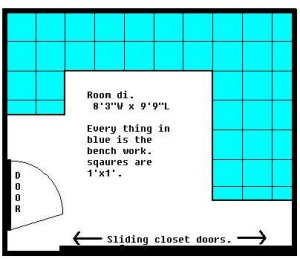

Hey guy's. I'm in a bind something fierce. I haven't started building on the bench work yet because I am completely stumped on the track design. I need something for an operational layout rather than a continuous running because of the lack of room. I've tried several track plan's but none worked so they have been scrapped. I'm using the Atlas RTS freeware layout design program. I'm not sure if I want to go with a "layered/multi level" layout and not sure if it can be done because of the small amount of space and not sure if there's enough room to run a train from up to lower levels without sever grades. Any track plan design's will be greatly appreciated and maybe if I can get a few of them to gather I can combine a few idea's from them. This is for HO and I won't be running any 6 axle locomotives and car's no longer than 60' scale feet but I would like to see a 22" curve go in there somewhere if possible. Thanks in advance.

Could I do a great N Scale layout in that space. :D
In HO you are very limited. no space to turn around, hence you are stuck with a point to point layout with no continuous running trains. I see no way to incorporate multi levels here, unless each level is a totally separate layout.
I would divide it into 3 sections and essentially build three dioramas, one on each wall.
Ask yourself, "What do I want to see?"
what era do I want? modern, transitional, 1920s, 1890s?
do you want one big yard? steam servicing, diesel servicing, both.
do I want a rural industry? Lumber camp, sawmill, mine, cattle pens, grain elevators...
do I want urban industres? oil refinery, steel mill, manufacturing plant?
do I want a town/city? Passenger and freight station.
Once you find out what you really want to do with it, designing it will come easier.

Deciding the industries, landscape, era, and other features will help to define your track plan. Also, depite your closet doors, it may be possible to close the loop with a narrow bridge/shelf across the closet.

Charles - this could have been designed to fit that room - you can always have an "add-on" board that extends into the closet for the "fiddle yard/storage tracks"

Any way you can do an around the walls layout and use the closet area for hidden staging??(remove the doors and use a backdrop)
A lift up section could be used at the entry door.
This would give the ability to run a full loop at leastand a second level could be gained using John Armstrongs technique rather than a helix or nolix.
Another option for second level operation would be a train elevator hidden in the closet.
I should have mentioned I can't use the closet because it is packed with box's and clothes. I store most of my trains in there been about 50% of it is trains along with a dresser etc, etc. I also should have stated that this will be a sectional free standing bench work because it's in a mobil home. Next would be concerning the layout being to high across the bedroom window. I own an extremely large drum kit and the bass drums stand the highest when everything is tore down and the tom's etc. can be double stacked under the layout because I also have to store these drums here when there are not at the practice room. as for the questions. what era do I want? modern. do you want one big yard? diesel servicing about 2-3 tracks, long enough for about 3-4 locomotives each. Do I want a rural industry? small grain would be nice. A trucking terminal, a concrete plant with a single siding that doubles into two before a dead end. not sure on the rest yet. I guess that'll go as space allows. No passenger service therefore I don't own any passenger trains. I can't go N scale because I'm already involved in HO. Once a track plan is made up I will add in dead end tracks to add on to later in time once I move. I am including a couple pictures of the drums so there's an idea of how much equipment will be stored underneath but also because of my concern with the height. The bass drums from top to bottom stand 2' 1/4" and the window seal is at 2' 3" from the floor. So I'm trying to figure out how I can get the drums under the bench work without modifying it being 1x4 bracing with 3/4" ply wood base so the bench work is at window level so the sliding glass window is not obstructed in anyway and the bench work can't be seen from out side, just land scape. Also back to the closet ordeal. Even if I did clean it out which I can't because I don't have any other place for this stuff the closet is only 2'-2'1/2 feet deep at the most.

Will, I have a space almost identical to this one. 115"x91" with a 28"door in the corner just like his drawing. I am planning an n scale layout around the room. I too am having a very hard time with a track plan. I am planning to model modern day Norfolk Southern trains. I want both around the room long run and lots of switching. I have a lot of prototype maps, but, I can't seem to get over the hump. I checked out your web site and your plan looks great. Do you have a knack for doing track plans? If so, let me know.
