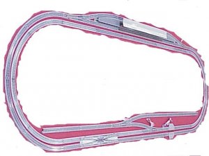

I think my plan is similar to 65gasser specs, but squeezed onto a 32" x 82" N scale rollabout.
I don't usually do this but for some reason I decided to give your room a try. I rotated your room 90 degrees but you can orient yourself by the door. I used your measurement of 36" all the way around the outer edge of the room with the minimum clearance for humans as 36" aisleways as well. I started to get crazy and then thought I better get some feedback from you before I went any further. I see a nice double mainline meandering around the layout (24" minimum radius) through some hilly or mountainous scenery with a big old yard (or some staging) on the top. You may even have room to do some over/under stuff if you like with those big circles out on the peninsulas. You did say "all the way around" so I figured you were going to have a duckunder or a lift out or something... that is shown as well. Your switching branch, I see as running against the back wall with possibly some towns down the middle of the peninsulas above the double mainline. I just threw this together as an idea and the family is bugging me to get out the door for ice cream and so I must go. Hope this gives you some ideas.
