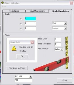

Well, after reading about 3D Canvas, I thought I would DL it and install it as it is freeware.
After I did that, Model Calc loaded, but the first calculation I entered, I got the following...
Sorry, Steve, my conclusion is that Model Calc is not ready for public consumption. I do not think it is a good policy to have "customers" beta test your product. That is what your friends are for.
My suggestion would be to go back and do some more tests and come back when Model Calc is stable and does not need other products installed to work.

Will,
You won't get any arguments from me on beta testing. It's been through a lot. But it's a freeware program, and the folks helping me test it have been just like you. Model Railroaders interested in helping out the hobby. There not professional QA folks, just folks willing to try to help.
I appreciate the help you've been so far. I'm working out a couple of other issues with the program. I should post a support page later today with fixes to the app. I'll post here when I do.
Again, Thanks for attempting to get the program running.
Steve
