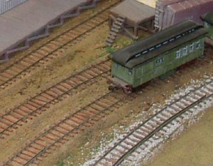

code 55
I love the look of code 55. my biggest problem, finding spikes with heads small enough. Kemtron used to make some real nice ones. I like the Micro-mark small spikes, but need to test them to see if there is enough clearance for the flange, my biggest problem with code 55. on my railroad ( picks in the logging section) I used code 70 on the main and code 55 on sidings, except in Harlow, which is code 55 throughout.
Pictures of my railroad are in the Logging and minning area.
Bill Nelson
