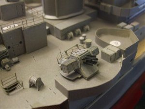

Worked on the gantry cranes and star platform today. The kit is missing the "wedges" for the mainmast star platform, so I will have to fabricate those. The gantry cranes were about half size as well! I had to fix that, too. :roll:
-Ski
I'm making slow progress on the ship as work is taking up most of my time, unfortunately. I did get the mainmast just about done including adding the star platform supports that were not in the kit (the black part). I also worked boats. The secondary turrets are just set on the deck for the shot. I didn't cut out the sight slots on them and went with adding shutters to them instead. I found photos of the Hood with these shutters installed. I didn't like how flimsy the turrets looked with the slots cut and it isn't accurate with them in the stowed position.

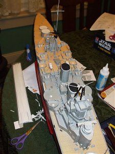

I pretty much finished the foremast top. I just have to paint the railings and add some others. I had to completely refabricate the roofs and turret facing of the mast top as they were grossly undersized. I also scratch-built the radar as the kit featured sight "wings" which were incorrect for the 1941 ship. Thanks to the HMS Hood Association website for the reference graphics!!!
I finally took the ship outside for photos for a better look. So close yet so far.....:thumb:
-Ski

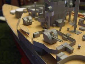

I finally started working on the ship once again. Night shift has really taken the sails out of my building! Very bad!! Anyways, I completed the 4.7" gun turrets and finished one of the pom-pom guns. I shuttered the sight windows on the turrets as I've seen photos with them installed. They also keep the turrets from looking flimsy.
It's easy to forget how fun this hobby is.
-Ski

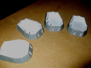

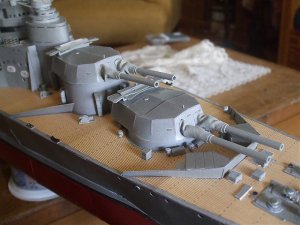

I started working the main turrets. They had the tabs on the roof pieces, and I know that they would be really tough to fit inside the turret sides without making a glue mess. So, I decided to tab the turret sides instead. This will make it a lot easier to get the roofs right, if you know what I mean.
I also am trying something new to me. For the blast bags, I cut out a piece of the gunhouse opening at the top of the arch. I'm hoping that I can draw a piece of the blast bag in and glue it on the inside. This hopefully will set up the rest of the bag for gluing with watered down glue, as I do with 1:400 ships. We'll see if this works out.
I'm now having a quandry over barrel sizes. I know the stuff I have should be big enough, but it looks small. I think everybody has this issue with barrels. I know that if I go larger, then the ship will look cartoony :rolleyes:.....
-Ski
ps. I cut down the 4" gun barrels to make them shorter. They look far more realistic now....

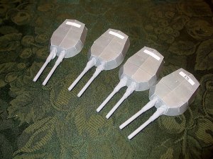

I completed the barrels and installed the turret roofs. Over-all, I'm happy with the blast bags. I used some of my wife's fabric which is really difficult to control. I couldn't bring myself to use the glue/paper pulp method. I painted the blast bags gray as it was mentioned on the HMS Hood site that they were gray and not white at the time of the sinking. I'm happy I'm done with them!! I'm thrilled with the barrel size. 5/32" tubing is perfect for 1:200 scale large caliber guns! :twisted:
-Ski

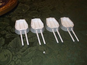

I finished the turrets. I'm really happy how they turned out. Now to finish off the ship's boats, railings, a few AA guns and rigging. I still have a lot to do!!!:rolleyes:
-Ski
