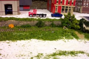

I use the same method as Allan...EXCEPT.....Instead of masking tape, I use Plaster Cloth from Woodland Scenics to cover the cardboard. Then I add the Sculpta-Mold. Allan's right, Sculpta-Mold can be shaped, carved, sanded to what ever you need.
Here's a pic of a retaining wall I did, using a nail to carve out the individual stones, and a tooth brush to rough them up.

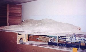

If Gypsolite is Gold Bond then I believe the intention is to use it to create a very strong shell. Sounds like a good plan. Since others have mentioned their preferred technique I'll throw in my two cents. I construct a web of corrugated cardboard as mentioned above but cover it with paper towels dipped in a slightly diluted solution of Elmer's Glue. Its cheap and easy to use although you might get a bit sticky! :) The shell takes two or three coats of paper towels but it dries strong yet flexible so the surface doesn't crack or break. Installing trees is easy by puncturing the surace with a nail.
Here's a photo of a hill I made this way....
