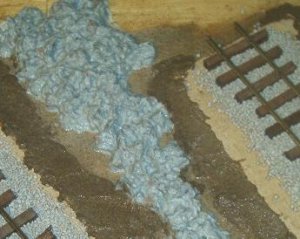

I tried the cellulose insulation method, albeit without the flour, and found that for finer contour work, it just didn't work for me. It clumped into glops, was difficult to work, and I wound up scraping it off and chucking it out.
I do suspect, however, that it would be okay for larger, rougher contouring.
