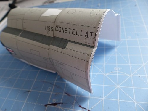

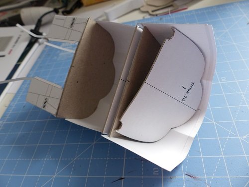

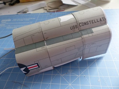

Here as some snaps of the fuselage badly joined, with a loose bulkhead

Never use that tabs that come with a model. Cut them off carefully. The glue strips on the inside on one side of the part first. Make sure no glue gets on the part at the edge of the section so you can then line up, check for fit, then glue the next section onto the strip. This will put each part on the same plane. Tabs that are part of the model throw the adjacent part to a plane the thickness of the model. That's why they should be cut off. Always dri fit, and cut glue strips where necessary. Many times "less is more', if you know what I mean. Alwways try and get those edgest tight before you glue. It makes for a much more satisfying model, and will encourage you to keep going. Welcome to Zealot! )

Thanks Zathros. This model has separate glue strips that you glue to the inside edge of one skin, so the next skin is aligned in the same plane. But it is impossible to use these strips and also have a bulkhead that is glued directly to the next bulkhead, the bulkheads giving shape to the section. If you use the strip to get good surface alignment and a bulkhead to get the section shape, there is always a gap of 2-3mm, which gives a slight dip in the skin surface. Tricky!
