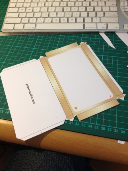

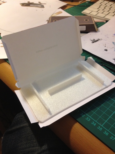

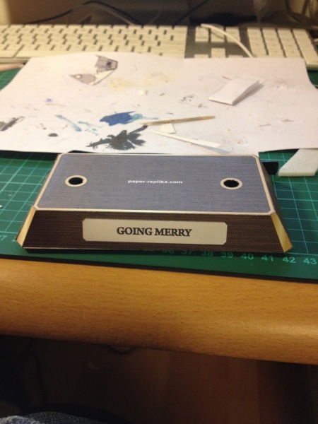

part 41 won't be holding anything as the ship's weight will be on the parts 40 which rest on part 37. But 37 needs to be reinforced. I glued some 3mm depron on the back of the top side of 37 and 3 "legs" of depron which were cut to the right height (8mm for a total of 11mm). I think it should be sufficient reinforcement.
The photo bellow show those 2 parts next come the 2 40s which are the pillars which will hold the ship.
I will finish the complete stand with the 160g/m2 paper before I redo it in the heavier one.

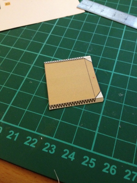

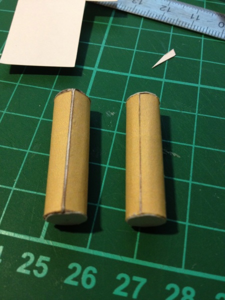

for part 40, I think that all the little tabs will be hard to fold individually so I fold them after the rough cut and before cutting them one by one. This is the first time I do that, we'll see if the result is worth it.

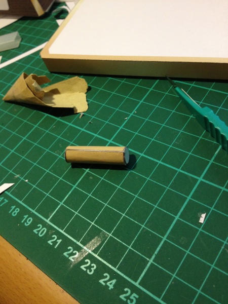

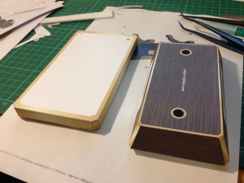

OK first part 40 is done and having a practice build first is paying its dividend. I just learned that I should not have glued part 41 before being done with the part 40s. I need to fit them in the holes and once the part is glued, increasing the size of the hole is very hard.
I wonder if the part should be build in order of their number?
Also as you can see in the picture I removed the tab of part 40 and instead glued a piece of paper inside. However I didn't perfectly join the side of the cylinder so there is a seem where there should not have been any. Well that is why I have a practice build. In any case the second part 40 (to the right in the third picture) is much better, the only seam that can be seen is actually the cut line as I cut in the middle of the line so the difference in color shows
Zathros, you are the one who advices me to forgo the tabs for folded strips. Is there a good way to replace the tabs for the top of cylinders such as those part 40 (sorry you would have to refer to the model, if it is to much bother, just tell me).

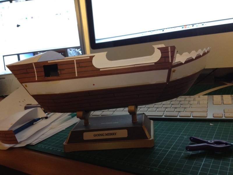

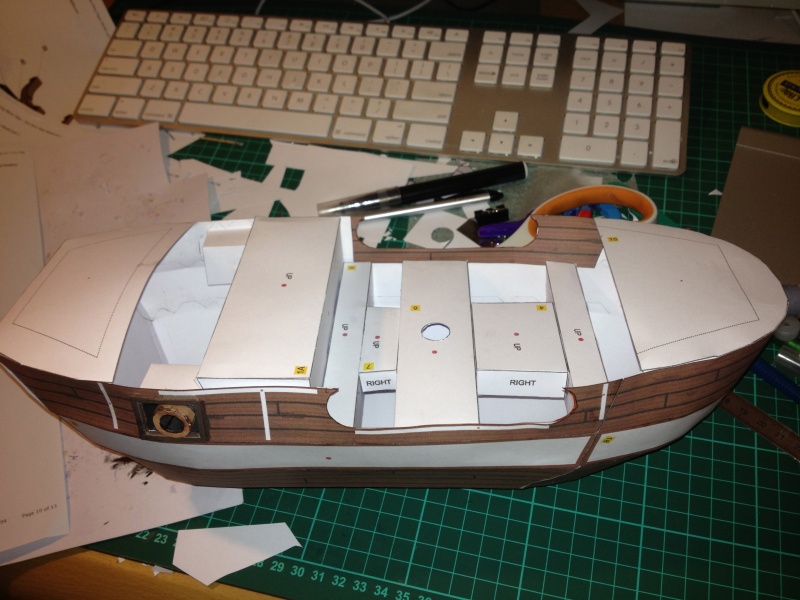

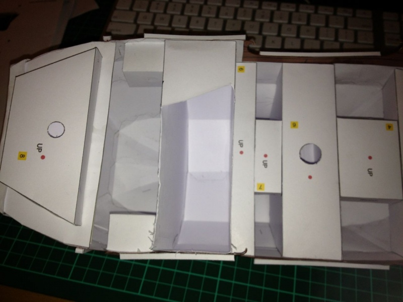

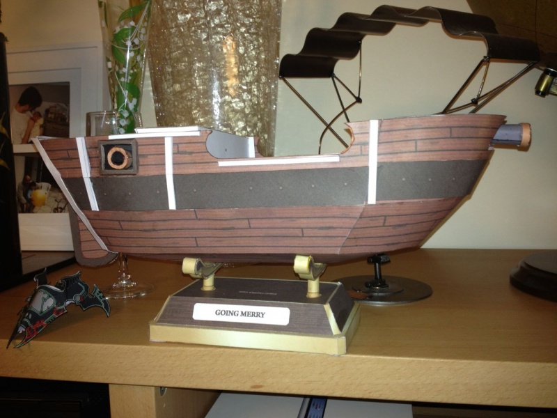

Hull is almost done. Note that I have made a big mistake when positioning the internat structure. I tried a new kind of glue! UHU Creativ for polystyrène. It is a kind that you have to lay on both side wait for 10mn and then bring them together. The problème is it sticks instantaneously. Hence the structure is not correctly positioned, as I was putting it in place a part on the right touched the hull and got stuck and now on the right side the structure is 3mm too high. Hopefully I will keep my resolve to build a second one to take into account all the mistakes I made on this first one.
Otherwise I still have the keel and a few pieces of bellow deck reinforcement before part 1 is done, hopefully tomorrow morning

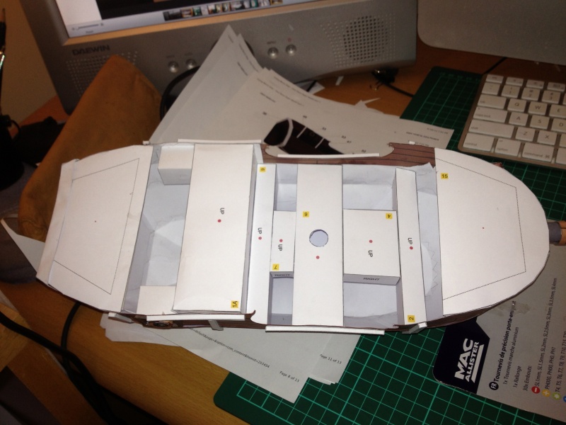

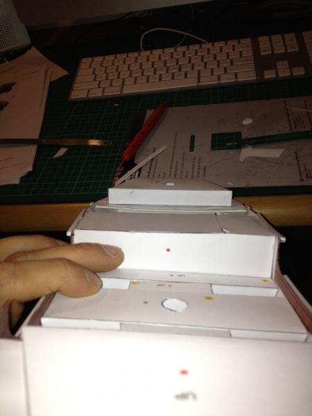

what do you mean cut the piece out, how would you do it? I'm attaching another picture so you can better see what the part looks like and advice.

1st) Are you referring to part 1A?, if it is, I would lightly scribe a line from across the deck on the front and back of the piece to be cut, referencing from the sides of the ship, to make it flush, and take a very sharp ex-acto knife, cut by making repeated scores on the lines, lightly cutting until it releases. Then fashion or reuse the top, making some new tabs to attach it by. top, and you will be all set. If I am referring to the wrong part, a variation of the same technique should work.

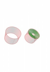

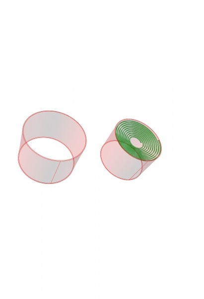

2nd) I am sorry but I missed your question about tabs in cylinders. What I suggest is taking scraps pieces of paper and rolling this 2mm wide or so scrap piece till it is wide enough to form a gluing surface. Slip that inside the cylinder, having put glue in there first, and this will allow you to glue the cylinder cap in place. If you let the piece unroll (see picture below such that is sits like a spiral inside in the cylinder, you will have a better surface to glue on. Just run a bead of glue across the spiral where you feel is necessary. :)

thanks to Zathros's advice and some surgery (I use a surgical knife), the going merry's internat structure is repaired.
I really feel like Usop! Anyway the 2 pictures are part 1A after it went under the knife then part 1A being dry fitted for a prosthetic top. I didn't include a picture with the top glued as there isn't much différence compaired to when it is being fitted
