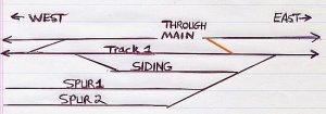

Looking at my layout's track plan for the small yard at West Mill Jct. I decided to convert this little used yard into an engine facility. I planned to use the yard for making up small locals or as an interchange yard, but mostly I use it to store freight cars. Time to see if I can make it more interesting.
Here's the plan:
The siding can hold six freight cars while the spurs accomodate up to nine. These spaces will work great for my locomotive lash ups since even my three unit U28Bs will fit on the siding without a problem. I'm imagining operations like this:
1. A train from a hidden siding emerges from a tunnel from the West. It stops before the East end of the yard so the locos can uncouple and back into the siding.
2. A serviced set of locos on Spur 1 or 2 rolls out and couples onto the train, and away it goes.
3. The locos on the siding move to Spur 1 or 2 for service asnd wait for the next rotation.
4. Sand cars and a tanker of fuel can be spotted at the end of spur 1, adding to operational interest.
I need to build sanding towers and fueling hoses. Stay tuned! I can't wait to get those locos out of the drawer and see how they look gathered together in the yard.

Ok , second try on uploading the track plan for the engine yard.....
Locos coming off trains and needing service will be held on the siding while newly serviced engines roll off of Spur 1 or 2 and hook up with the train on track 1.

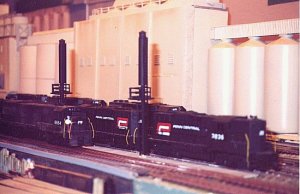

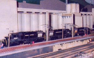

I've done a little bit of work on this project. I isolated two blocks on spurs 1 & 2 so I can park up to four powered locos on these tracks. The siding was already blocked. I've also added a concrete walkway between the tracks of the siding and Spur 1 and installed twin sand towers made of various parts from my scrap box. Now the former freight yard is full of black locos with mating worm logos. I'll make fueling stations and add details such as oil drums, workmen, etc. next.

Here's an updated picture with the twin sand towers (now silver so they show up better in that sea of black locos....a fueling standpipe (I guess that's what it might be called) is visible to the left near the oil drums.

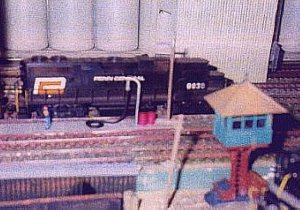

Not a great picture with my cheap camera but this water standpipe and hose are a fun little detail. The hose is a piece of spaghetti shaped, dried, and then painted black and cemented to a plastic sprue. :)
