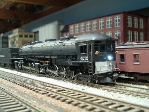

Make sure all your drive rods are free and not binding, there may be a driver slightly out of quarter or a popped rivet in the linkages. Finally, clean and lightly lube it. This may sound like a lot of work but the cheese eating grin on my face during Run Night at the club marks how well worth it it was. My 35 year old Grand Dame pulls full freights with the best of them high dollar, blue blood Kato and Spectrum units. Here she is in McCue city yard sporting her super bright LED headlight.

Here a pic of the engine
