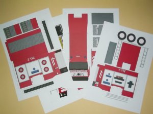

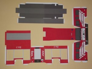

I turned the plans into *.pngs to change two things: The light blue windows looked a bit unrealistic. I recoloured them and made them dark grey. Second, I enlarged the plans by 40% to print them on A3 size. Since the original design is 1/43 the new scale is about 1/30 now.
I re-arranged a few parts to avoid visibe seam lines on the front and back compartment. I left the line on the undercarriage because you won't see it if you don't display it upside down. ;)
One thing that took me completely off-guard: I had major printing problems with Gimp. The red came out inconsistently, the scale of a few pages was completely off. I checked everything three times, made several test prints and wasted a few pages for nothing. I had absolutely no idea what was happening. I restarted the PC, checked the resolution and colour values, nothing helped. Then I tried something else. I loaded the pages on a canvas in Corel and printed them with Corel. That helped. Scale and colours were perfect. It was the first time Gimp let me down this way. Strange.

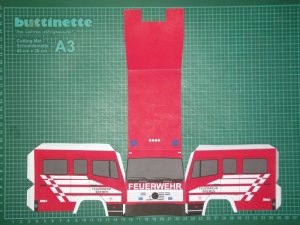

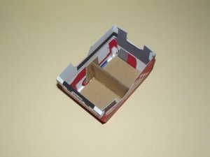

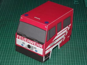

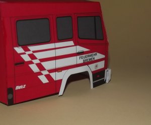

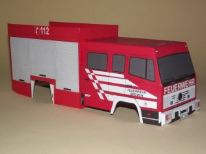

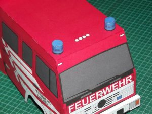

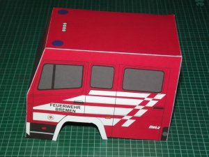

The driver's cabin:

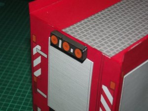

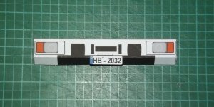

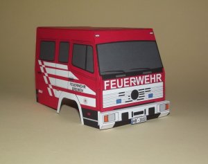

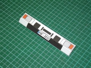

The bumper and the license plate are attached:
There is a visible gap at the back of the bumper:

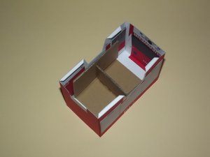

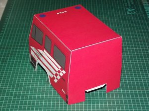

I reinforced the inside with corugated card.
On the inside you see the previously misprinted pages. Never waste a piece of paper! ;)

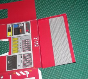

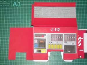

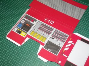

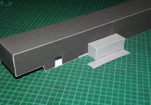

The back compartment is constructed in a similar way. Basically it is a big box.

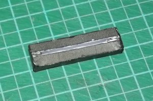

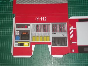

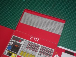

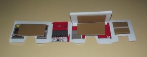

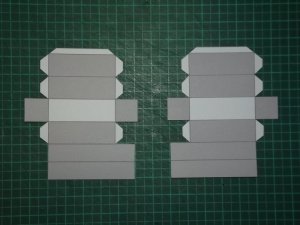

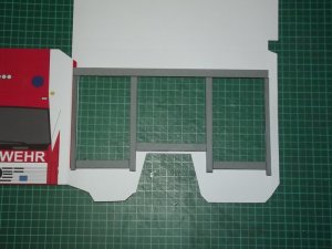

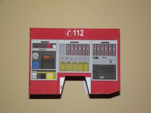

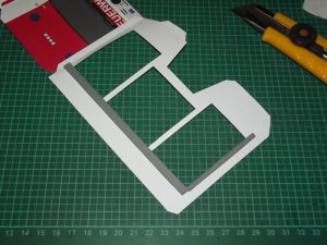

Volker designed the kit with a variety of display options. He provided separate plates which show the interior of the model. If you want to use these plates or not - you'll have to cut out the white spaces on the side parts because they contain relevant parts for other components. If you want to display the interior it is best to add a self-made spacer like the one I made. I used several strips of card and laminated them to a thickness of about 2mm.
These were glued to the back side of the compartment.
By adding only cardboard strips instead of using complete plates I saved a lot of card.

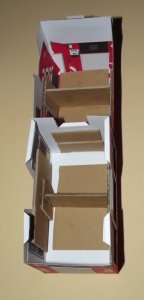

The interior plate was glued to the frame. The spacers add some depth to the model.

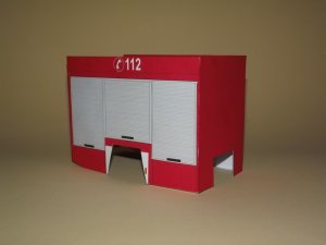

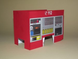

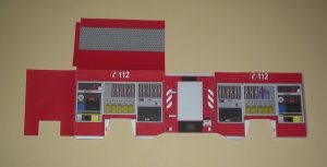

All components of the back compartment together:

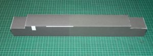

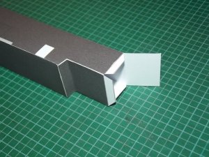

Another ingenious design element is the top tub. Its sides serve as glue tabs.
I reinforced the interior with corrugated card.
I chose the right side to be displayed closed. To do so I glued the covers to the side.
The back side gets a cover, too.
A view at the inside:
To add some realism I cut off the top portion of the covers of the left side and attached only the bottom showing the grips.
I really like the texture. Of course you are free to flesh out the interior by laminating the single elements or even replace them with 3D structures.

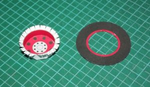

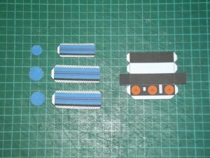

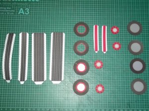

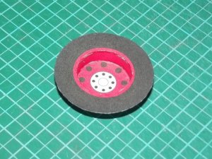

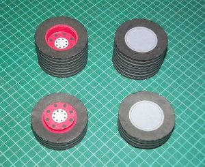

The wheels:
The front wheels get the thinner profile part, the back wheels get the thicker one.
The fully textured wheels are the back side which is glued to the undercarriage later. The center of two front sides must be cut out. These will be the fronts of the back wheels. There are two thin red strips in the kit. These are glued to two of the hub caps:
The other two hub caps are laminated to 2mm card and attached to the remaining fronts. The finished wheels look like this:
When you compare them to the real ones you realize major differences. Volker's design is good for what it is, it is very easy to assemble without going overboard. However, with some small changes you can achieve a much more realistic look:
The front of the front wheel must look like this. The center must be coloured red. Only the ring is raised, not the complete circle. The center circle is flat.
This is a change I'm not sure to make because I have already assembled the wheels (I just had an idea how to do it without doing too much damage, so we'll see). I will however update the back wheels since the fix only requires adding a new center plate. The center plate must be completely red and feature a laminated center circle.

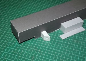

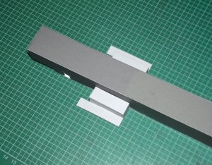

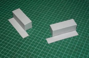

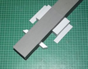

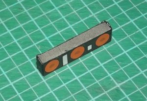

When I looked at the parts I found these two structures. At first I was unable to understand what they were supposed to be. The build on kartonbau.de gave me a clue: they are steps helping you to get in or out of the vehicle.
They are glued to the undercarriage. There are even marks indicating the spots.

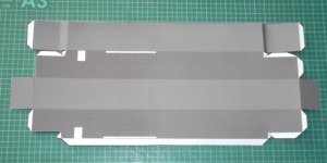

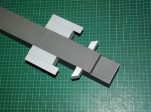

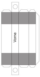

When I found out which side was the front I noticed that the white rectangles were meant to be cut out.

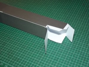

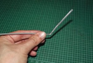

Volker provided two different front axles. One is straight, the other is angled. He even added center marks to push a rod through the parts if you want to make the wheels spin. I chose to use the angled axle.
The circles show where to attach the rod if you like.
You may even choose the direction the wheels are going by turning the axle upside down. Another of Volker's clever ideas. :)
The axle is pushed through the hole and glued tight.

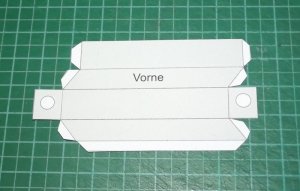

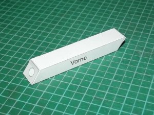

This is the optional straight axle:
Use this if you want to display the front wheels in a parallel position. The hole indicates where to insert a rod to make the wheels rotatable. If you use the angled axle like me this part can be omitted.

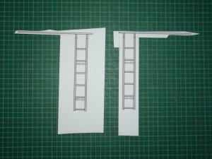

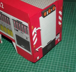

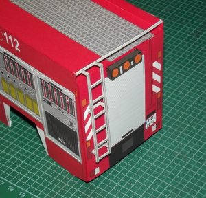

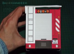

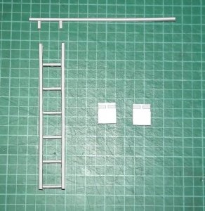

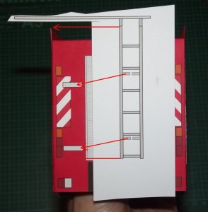

This is the ladder leading up to the roof. It consists of one front and one back side. Both are supposed to be laminated together
and attached to the rear of the vehicle like this:
The long horizontal beam on the top serves as an anchor for the four big ladders which will be stored on the roof.
The original features a hook-like structure on the top allowing the climber to reach the rooftop more easily and to fully embrace the rungs. The small rectangular structures between the rungs are supposed to be folded down and serve as spacers but they are in the wrong place:

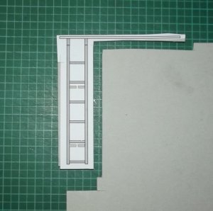

So I laminated everything to 1mm card, skipped the back side print, cut the spacers off and repositioned them.
I attached the ladder to the spacers first and then added the beam. Everything looks great now! :)
