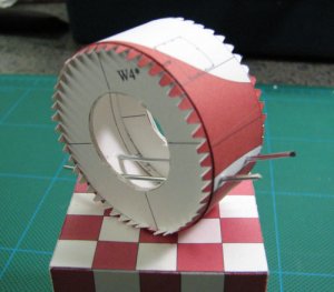

Finshed 4th section. The wing support wires are in, held firmly in place with a small bit of CA glue. This is 1mm wire.

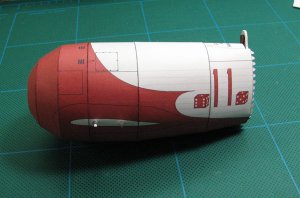

Well, here we are back at the cockpit section - time to find out what if anything was not fitting right before. I rolled the 5th skin section and test fit it on the forward cockpit former. Perfect fit. So it was the 6th skin piece that will be tight. Good thing I waited instead of shaving that former down. ;)
But now I've got an odd sequence issue. I'll have to slip the cockpit section through skin 5 and slide it backwards. I decide to maybe get a better seam match I'll tackle that cockpit skin first. It is indeed barely long enough, it needs a good tight fit and tug to pull it all the way around, starting by tacking it down up top. You'll need to notch a bit of the cockpit hole (the one that says cut out after assembly) to fit around the back former.

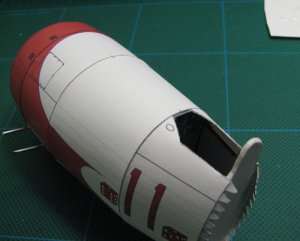

Finally (for now), CAREFULLY cut out the cockpit hole. It's starting to look more like an airplane and less like a bomb!

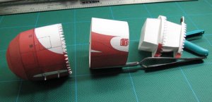

I'm back! I hope everyone had a good Thanksgiving holiday!

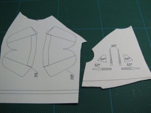

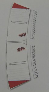

Continuing on with the fuselage. The fuse section at back of the cockpit has an issue with the free model. It appears that during the rearranging of things from the printed version, the glue strips that go at the back of skin section 7 and former W8 have gone missing. I see from the pics on the Kartonmodell thread that they are there, and used the pic to deduce the general size. The picture below shows a hand drawn set of strips, done by tracing the curve of the skin part 7 (this is a rough cut one - I had already cut and glued the real one).

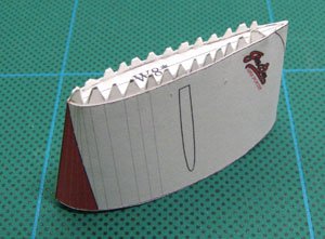

Another problem. When dry fitting this section I found that when the bottom seam was lined up, one side's pattern matched up fine, but this side was off by a bit more than 1 mm. I ended up cutting the section back apart at the botton seam and trimming it to work.

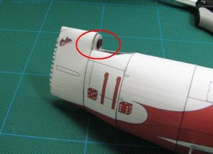

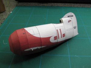

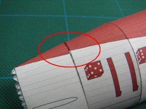

Section 7 glued on. The place indicated by the red circle here concerns me a bit. The top of the skin section is just sort of free floating here. I'm assuming the canopy will cover the "hole" here.
