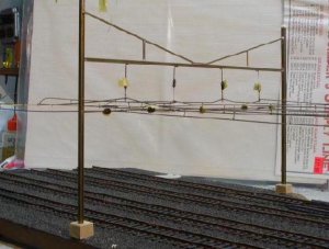

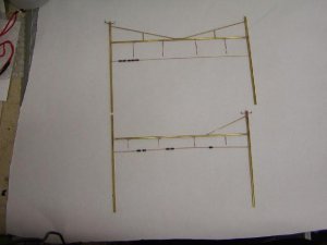

I'm in! I actually started this a couple months ago, but have a ways to go. I have to disguise where my west end main line goes thru a wall to staging in another room. The stairs to the basement start down over the far end of the room. I decided to model the NE corridor asa dummy scene. Here is a picture of early stage progress. I've purchased the catenary towers and am checking placement.

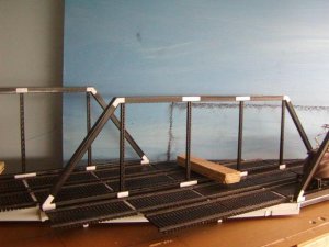

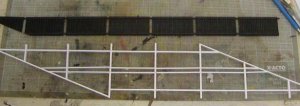

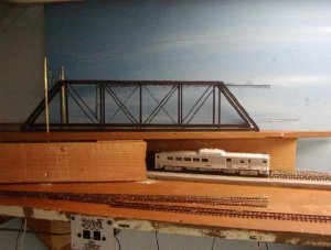

I became concerned that where the corridor tracks hit the backdrop was going to be impossible to make look ok. It was suggested that the busyness of a truss bridge replacing the concrete deck bridge would help disguise this. So I took the superstructure of a CV bridge I built for another location and used it to see how it would look. It would need to be shorter and skewed, but I thought it was a good idea. Here is the mockup.

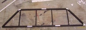

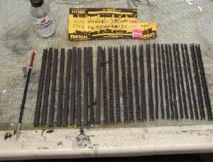

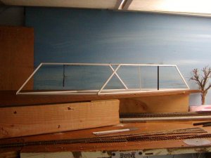

And here is one of the trusses (?) I made molds from leftover CV bridge kit parts for the splice plates so I could cast a bunch. I was going to make four of these, to make two double track bridges. I wound up only making three, and using the one in the center for both bridges. Not at all sure if this is kosher, but was being lazy!

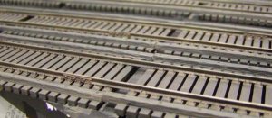

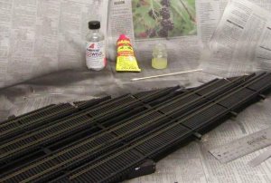

It was time to glue rail down on the ties. I used Barge cement thinned with Ambroids Pro Weld and applied it to the bottom of the rail with wooden q tips. I was starting to like the results.

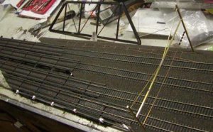

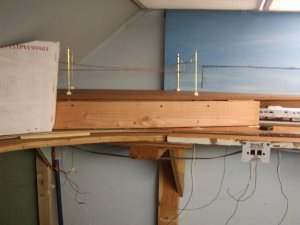

I had of course attached the deck of the bridge to the roadbed for the adjoining section, using epoxy. The whole deal needs to be removable for access to the turnouts beneath it. It was time to measure out where the catenary bridges would be in relation to the truss bridges. This is the scene on the workbench as I tested fit.

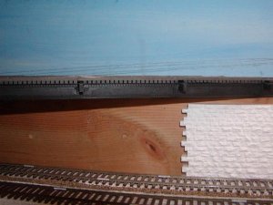

Now I've added rivit detail to the bridge frame, and I've started making castings of the stone wall. I needed 10 of these wall sections so elected to buy just one and make plaster copies. You can also see the rail joint bars glued on the flex track. Oh, I used n scale cork roadbed on top of homasote, on top of plywood. I placed the corks edges where they needed to be and filled in the center gap with spackle.

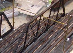

I have a question though. Not being a traction fan..Wouldn't they have hung the cantanary on the top crossmembers? Instead of having a seperate cantanary bridge?
Thanks folks. Kurt, a friend and fellow modeler gave me some sprues of material that he in turn had received from another modeler, a custom builder I believe. He was closing up shop and gave Jim a lot of material, which I used some of here. Most of the material was in a scale too large for HO use. There were several lengths of angle with rivets which I used top and bottom of the main girder. Also, on a sheet there were rivit patterns for various configurations of rivets, one of which I chose for use around each of the crossmembers. So, sorry, but I have no new easy way to add rivets!
88, I have no idea! The skew and length of the bridge allowed use of that catenary bridge clear of the frontmost and rearmost trusses, going thru the center of the middle one. A photo of that will come along. I did use the truss bridge top members to hang insulators to support the catenary itself as well, as I needed to support the ends near the backdrop where there is no catenary bridge, just a post in the front, just clearing the backdrop. Again, future photos will show what I mean.
This photo shows I've attached the catenary to the bridges. What an ordeal! I started by soldering but had a lot of trouble with it, not being able to get nice clean joints. It was difficult to keep the parts together while soldering, and I also was having trouble with solder flow. I've never been great at sodering, but this was particularly difficult. So, since this is a static model which will never see operation, I simply super glued the parts together. I now have great admiration for those who build working catenary!
