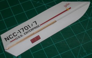

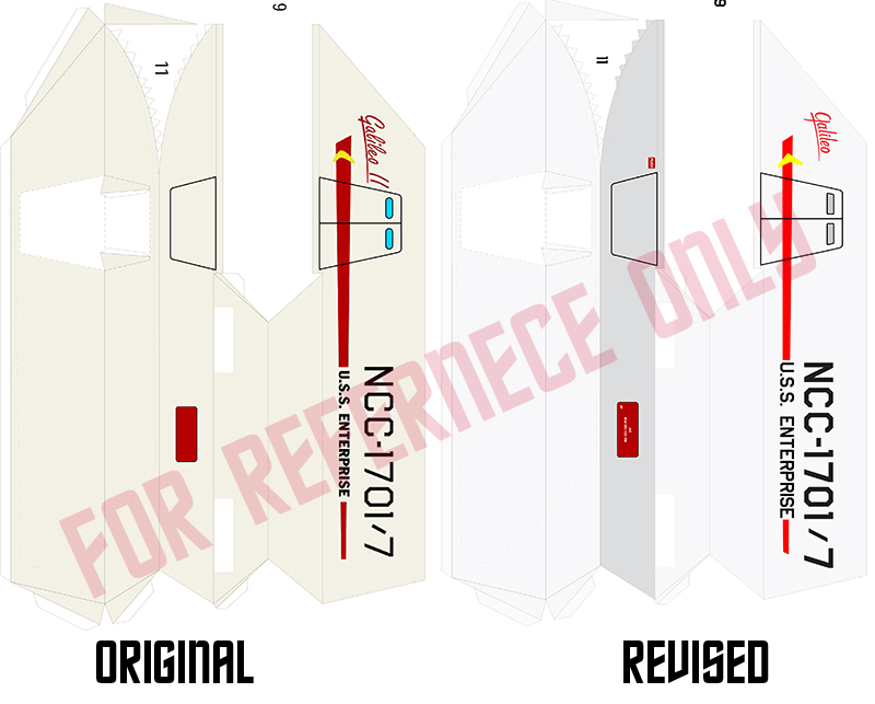

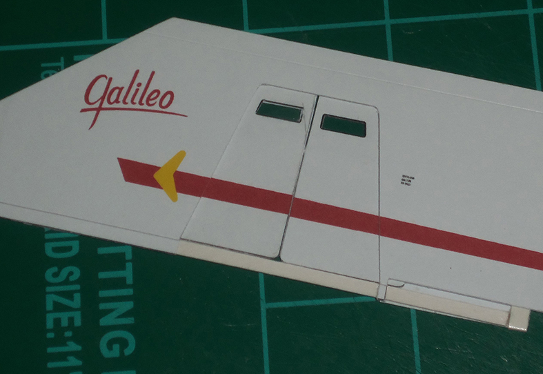

EXTERIOR

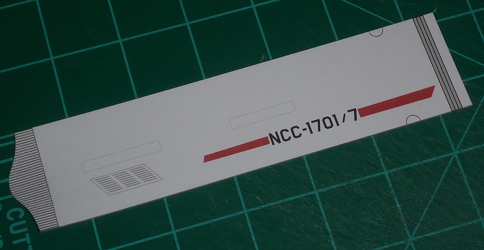

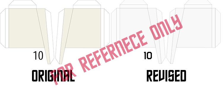

CHANGES MADE: Made new sliding doors to compensate for new hull stripe. Corrected door windows for shape to match studio model. Added “Push” panel by door. Added missing hull markings by door.

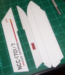

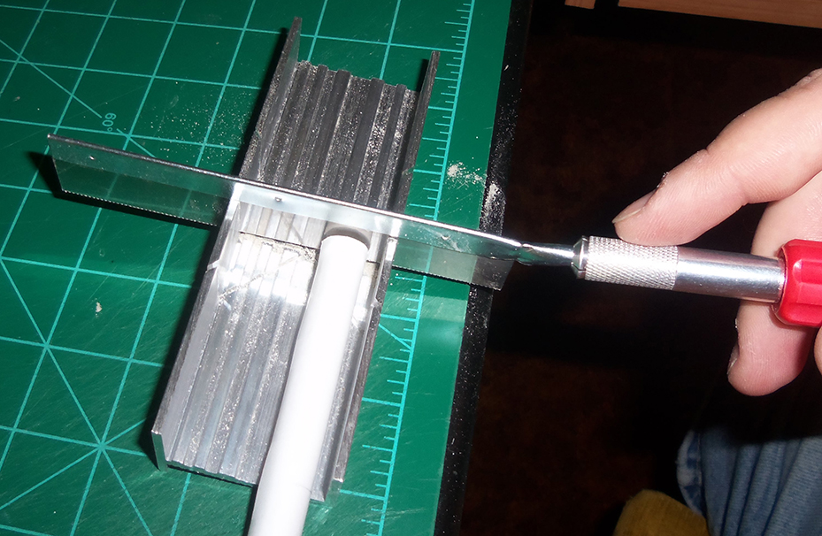

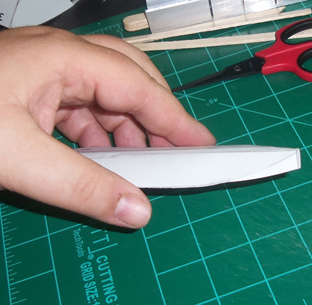

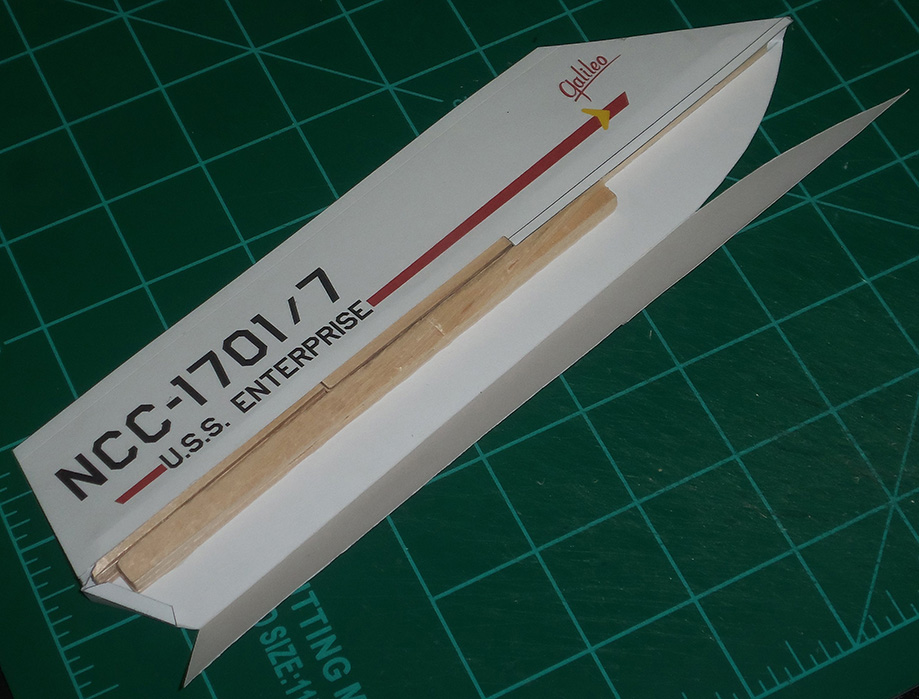

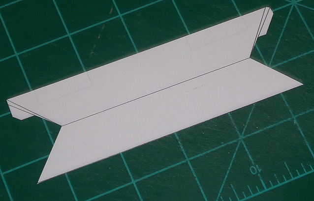

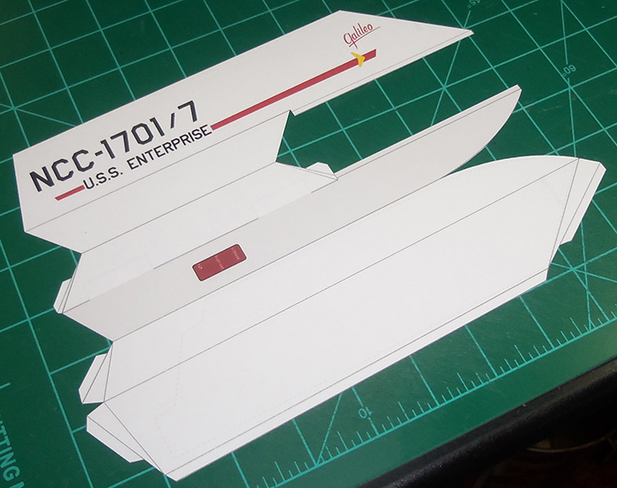

Here’s where things start getting really “seat-of-the-pants” building. The outer sides of the shuttle were designed to be hollow wedge shapes with skinny wings. That wasn’t going to work for me. To make things a little easier on me, I started with the starboard side since it has no door.

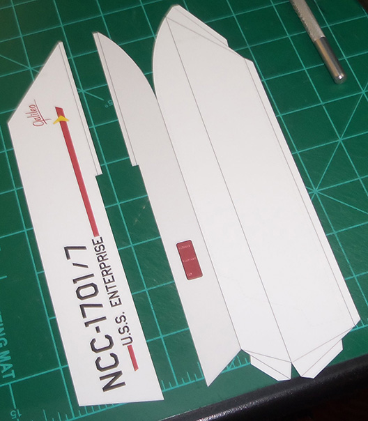

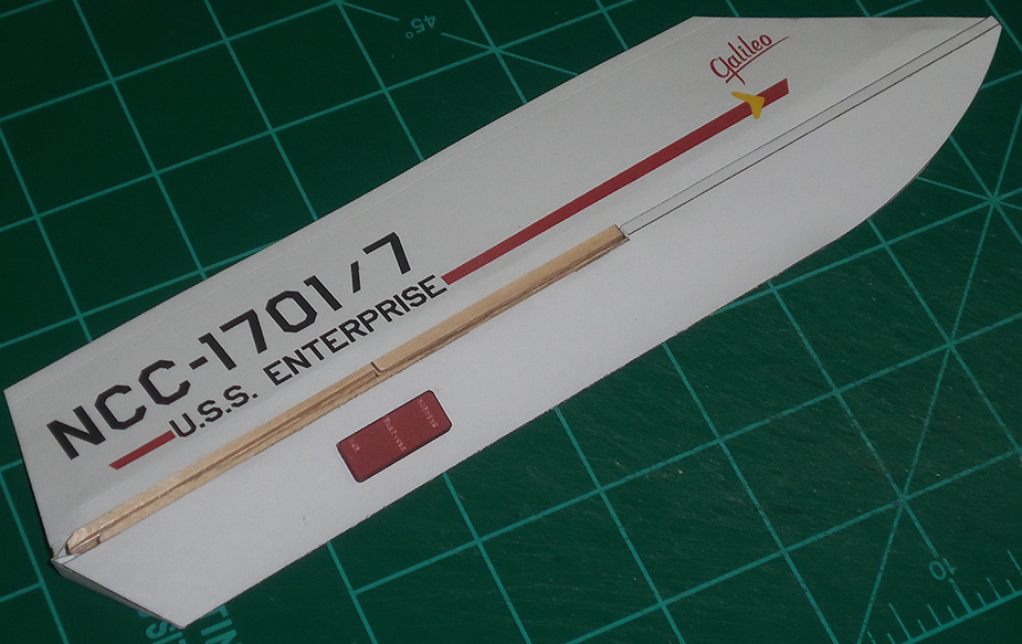

First, I cut off the wings to address separately. That gave me an outer top piece and a outer bottom/inside piece. The inside piece needed to stay flat for gluing to the main body. I took some double-sided tape along the top edge where the inner and outer skin come together and curve. Next, I laid the piece flat and glued the upper forward and rear edges together. That gave me the upper hollow “pocket” of the skin. I glued craft sticks together with Super Glue gel until they made a solid brace across the center line. I cut the sticks at the front and rear to match the angle of the hull. This worked perfectly to keep everything straight.

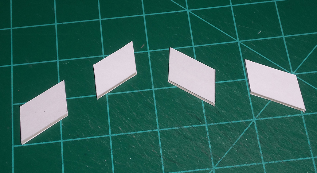

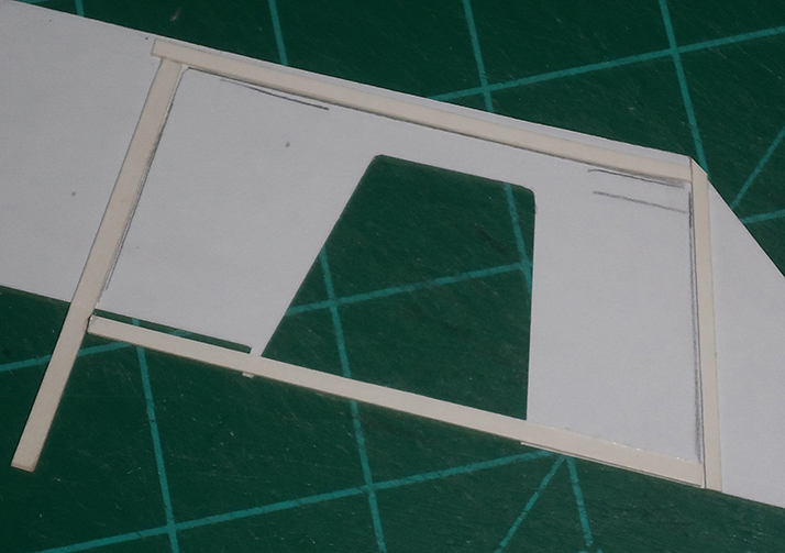

I needed more sticks to completely fill the hole left by removing the wing, and give the wing something to attach to when I put it back on. I glued four more sticks together and only made them reach about 3/4 from the front to the rear, as the front/lower section starts to come together to a narrow point. Leaving these sticks square caused the center line to be too square and didn’t let the center line come together correctly. I solved this by using my X-acto to shave off, a little at a time, the top stick at an angle that matched the curve of the hull.

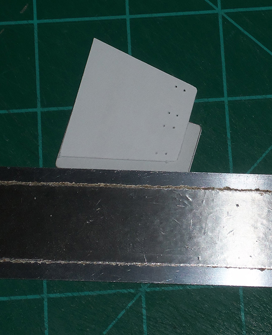

In the old design, the skinny center line you see is supposed to be folded out on the top and bottom and glued together to form a paper-thin lip. This doesn’t match the studio model, which has a thicker, wider center lip. I’m going to address this as a separate issue, but the section as drawn is about the right height of the lip that should be there. When I glued them down I overlapped these sections to use as a guide later.

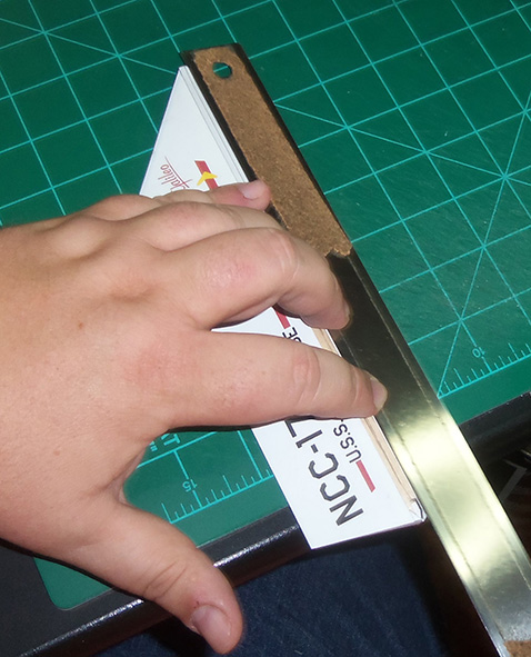

To get a nice, straight, flat center edge I used my ruler to hold down the paper on the craft sticks while gluing.

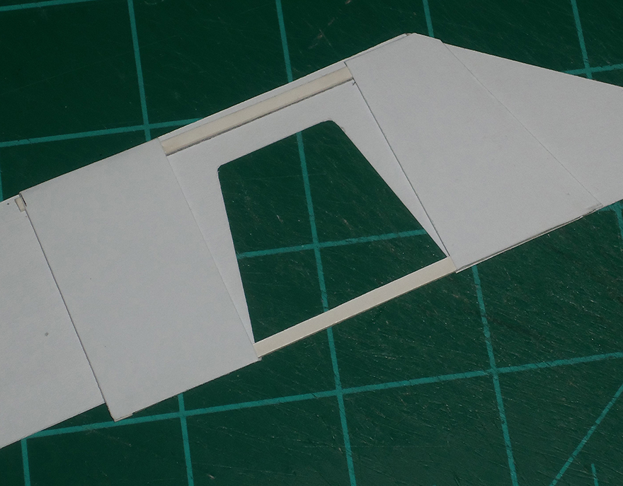

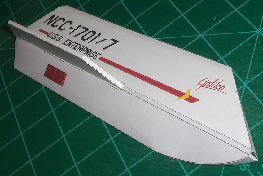

With the edges sealed, the wing hole stuck out like a sore thumb. I covered it up with a piece of scrap hull cut to size and glued in place. Doing it this way created seams that aren’t on the original Galileo because the wings are molded in. But, I’d rather have a few extra seams than crappy wings.
Next, I layered the red panels that go along the bottom of both sides of the hull and attached the starboard one.
I glued the forward angled piece that covers the hole in the hull in place using Super Glue gel. The widest part of the piece ends right below the center line because of the way I’m building it. That leaves a small hole at the center line which will be covered by whatever new center lip I come up with.

On the original Galileo, the wings are as thick as the center lip where they flow into the center line and taper slightly out to the flat edges. The original model wings create really skinny wedge shapes that come to a point. For me, the best way to do the wings was to cut the top piece off, glue the bottom to 2mm white picture mounting board I got at Hobby Lobby, and paint the edges white with a paint pen. I glued them in place with Super Glue gel being careful to keep the wing at 90 degrees. They don’t have that slight taper, but they are flat and super strong.

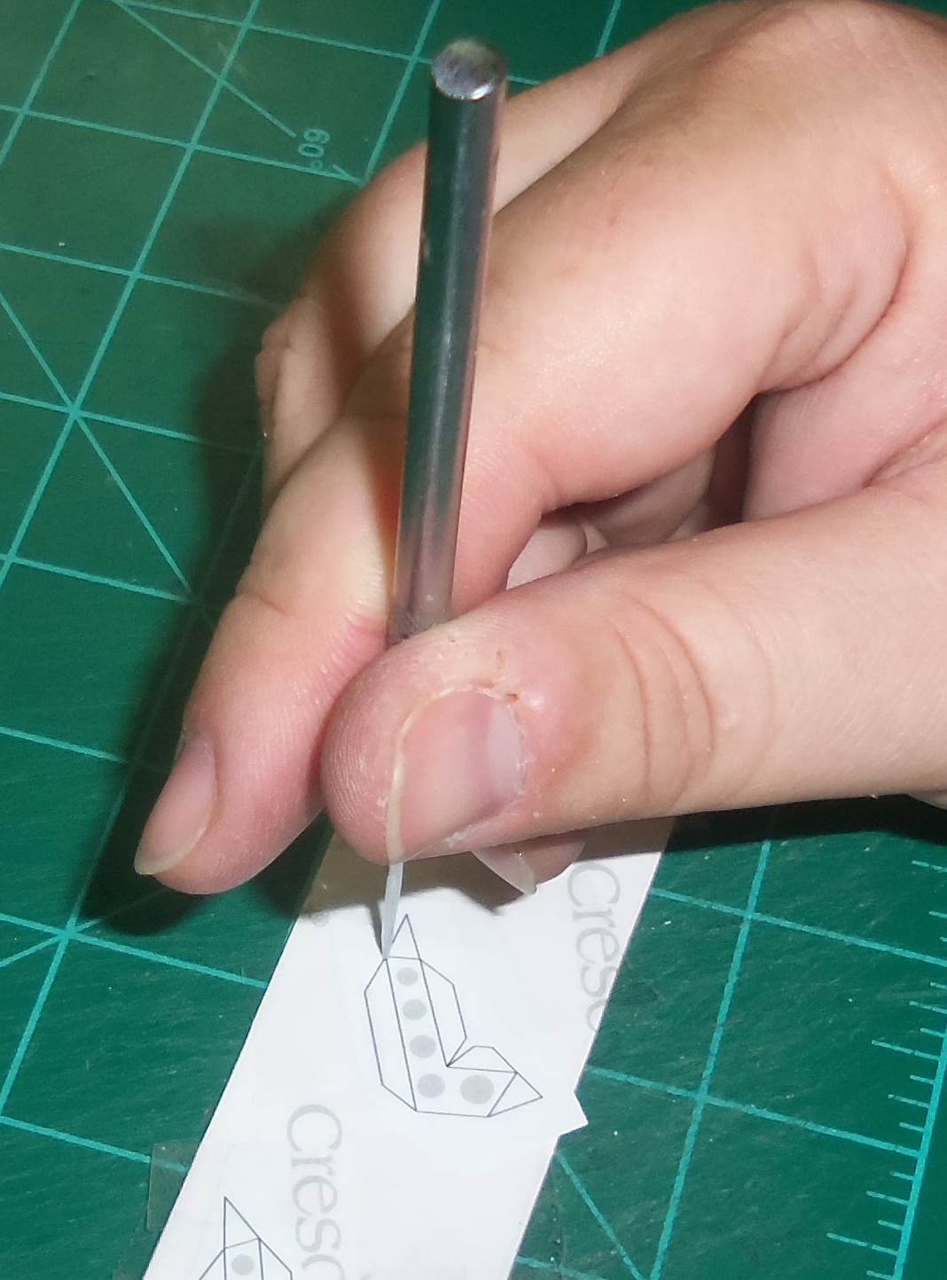

Lastly, I used some rods and tweezers to curl the top section of the hull.

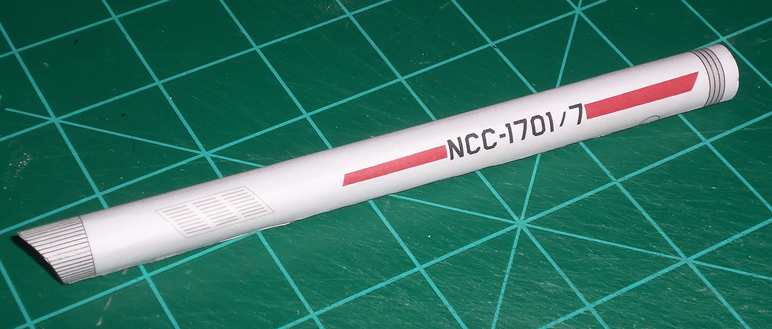

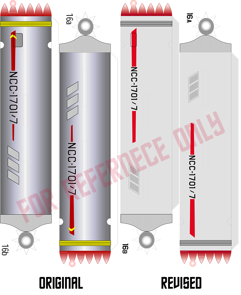

ENGINES

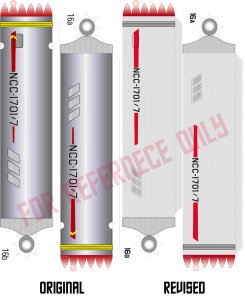

CHANGES MADE: Added fold-out step area to port drive engine. Added louvered areas to drive engines.

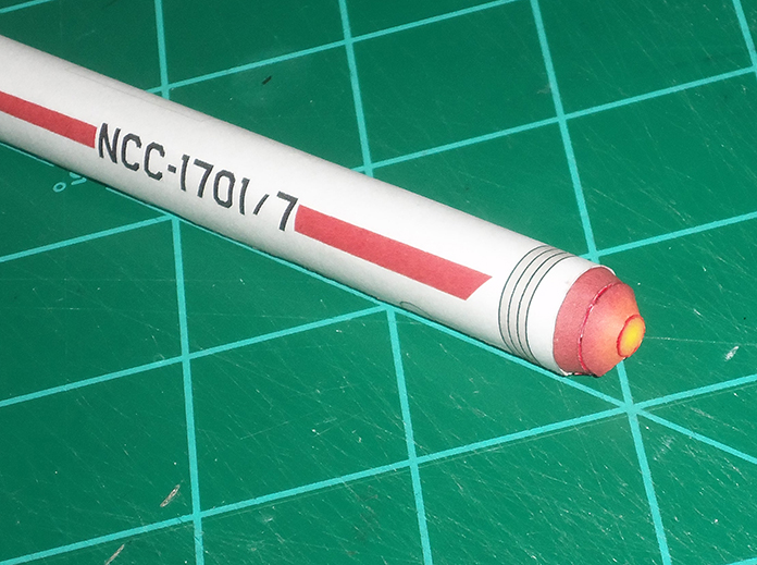

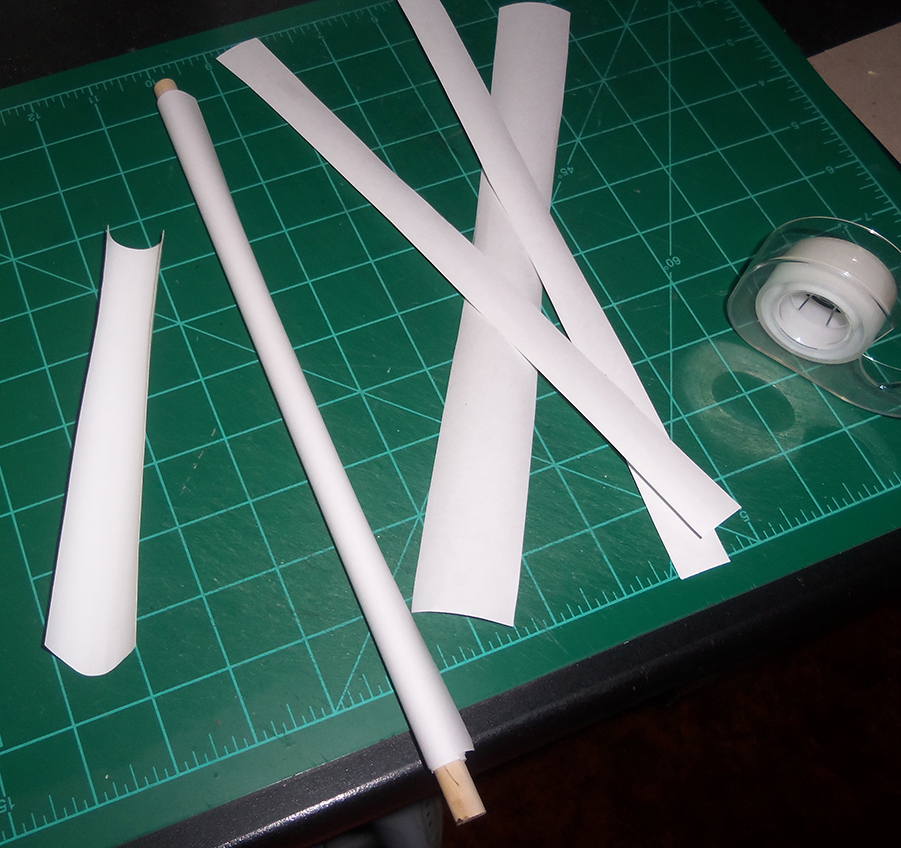

I hate making tubes!:realmad: I’m sure I’ve mentioned it before, but it bears repeating. Luckily, or unluckily depending on your outlook, I’ve had lots of practice. These engines are standard nacelles so the only change was the repaint.

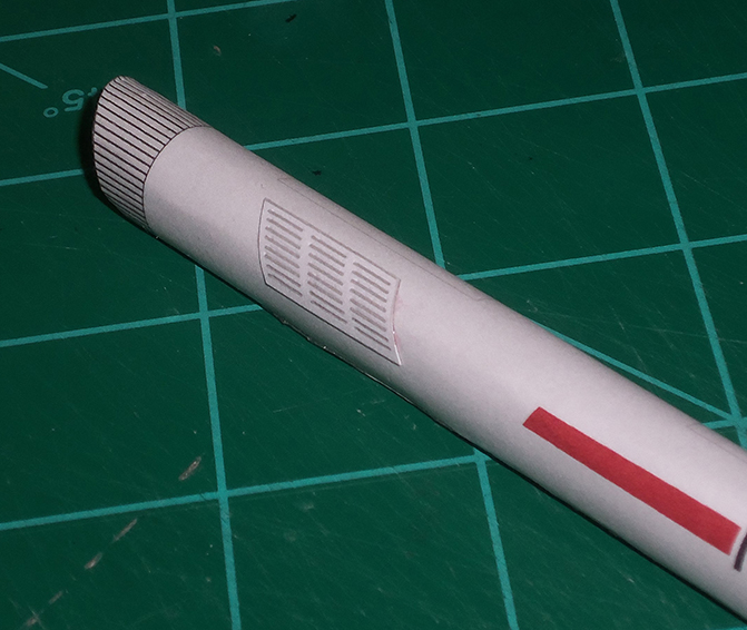

I trimmed everything out and cut off the tabs. I also ditched the “petal” bussard collector. I can’t stand those designs. They are impossible to make look right or good. I also cut off the rear end cap.
Next, I took a straight wood dowel and layered it up with printer paper and double-sided tape until it matched the nacelle dimensions. This gave me nice, straight, solid engines that will better support the model’s weight. I cut the dowel to size using my razor saw and a mitre box. I put a strip of double-sided tape where the seams met up and pushed everything into place, then I went back and put in a little regular gel glue to lock the seam in.
I wanted to find some domed plastic for the bussards but nothing fit. So, I went to my old tried-and-true Rawen bussards from the parts box. The ones I already had printed were the perfect size! I added a round end piece to the engine end for the bussard to glue to and it looks great. Then, I added the louvers at the end. Like before, I made them look more 3-D by scoring the lines. I don’t know yet how I’m going to do the end caps with the domes.

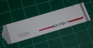

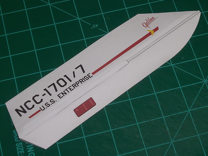

PYLONS

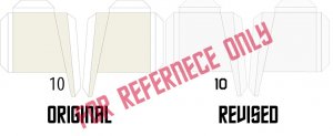

CHANGES MADE: Took “brace end” art off drive pylons and made end hull gray to match studio model. Set brace end art off by itself to make braces stand alone pieces.

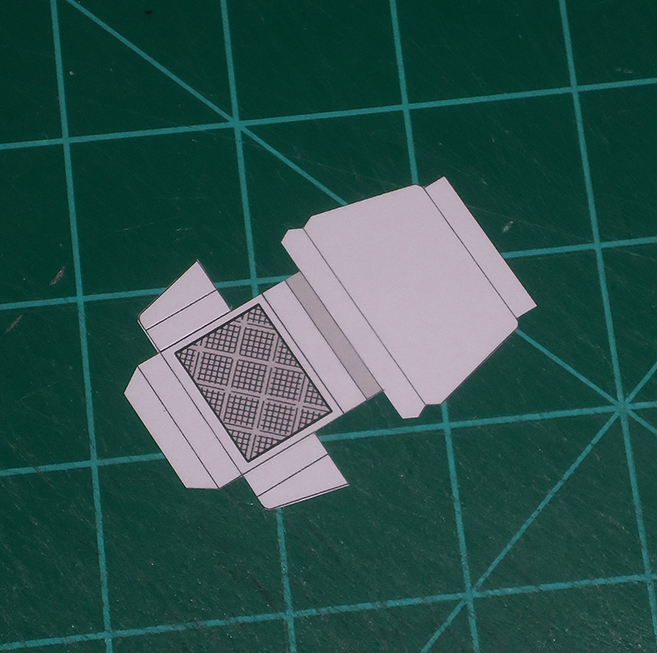

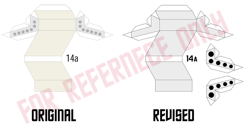

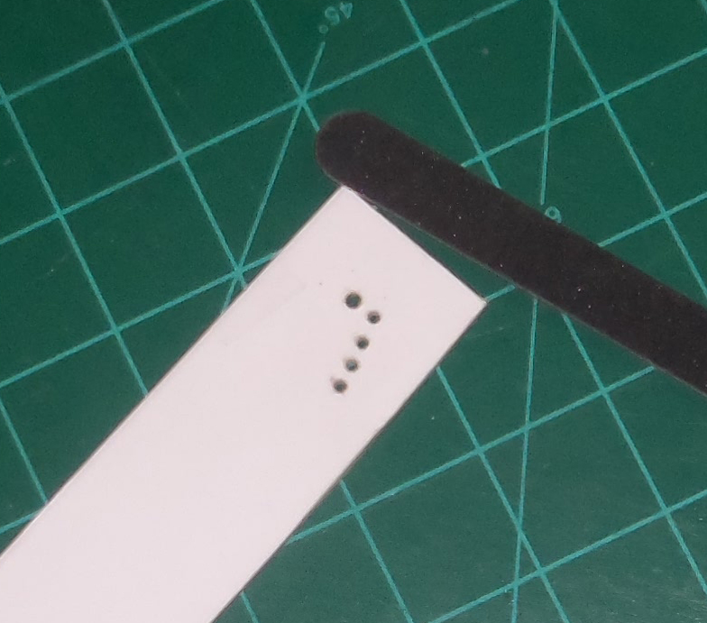

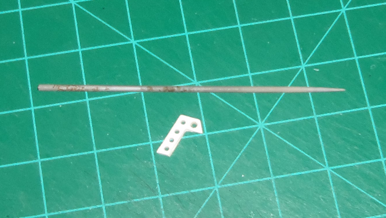

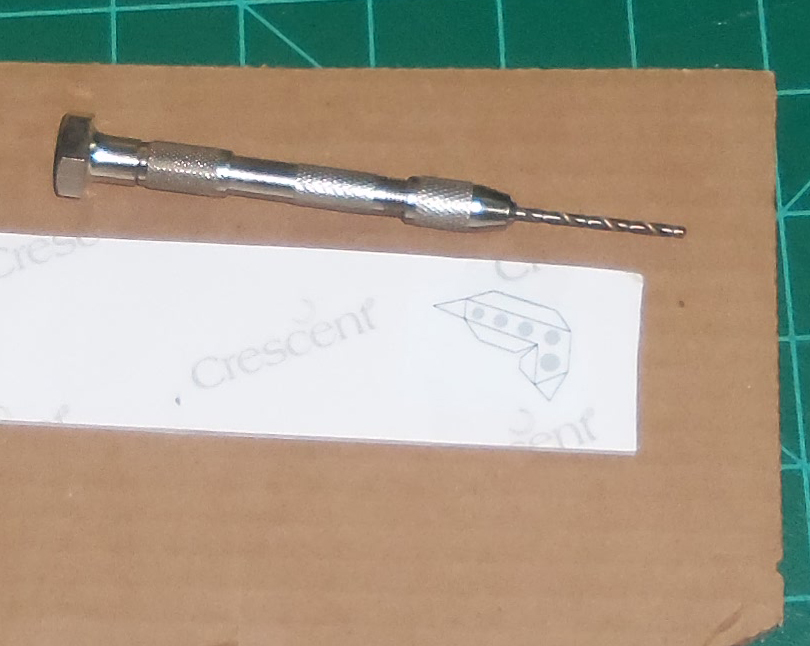

The original design for this part is a simple box, which does not match the studio model at all. The L-shaped parts with holes are braces that attach to the inside of the pylons. I wanted these to be sturdy, so I glued the flat part to 2mm white backer board. I used my metal pick to mark the edges of the part for cutting. Before trimming, I drilled out the holes using my pin vise. Working with part glued as a bigger piece made the drilling easier. I cleaned and smoothed the holes using smaller drill bits and my round file, then did the final trimming. I cleaned those edges with a flat file.
The backer board is just layers of pressed paper, so trimming it that small made the layers start to separate. To keep everything together I put some Brush-on Super Glue on the edges. Because the interior layers of the backer board are yellowish I painted the edges with a white paint pen. These parts should actually be gray all the way around and the flat sides are, but my gray Sharpie was way too dark so white was the next best choice. Those edges are hard to see anyway so the color shift isn’t in your face.
The flat pylons were made in the same fashion, except for the edges. I wanted them to match in color so I glued strips of scrap gray to the edges and trimmed them to size with my precision scissors.

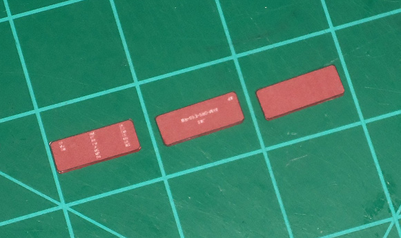

MORE ASSEMBLY

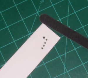

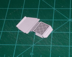

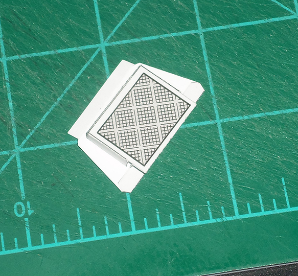

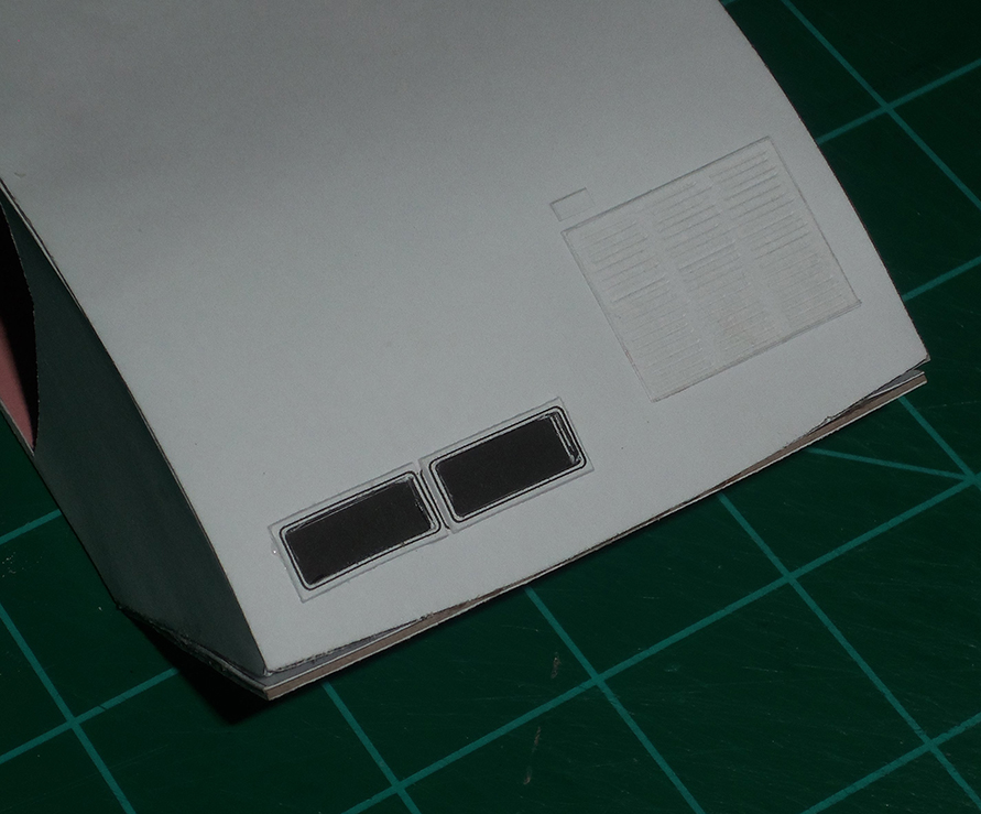

The main body has been assembled for awhile, so I went back and added the raised detail for the two ducts on the lower port side of the forward hull. These ducts go farther back into the actual Galileo, but I didn’t want to get into creating an inner assembly just to have “deeper black” areas that aren’t critical to the look of the model.

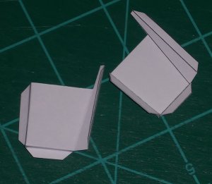

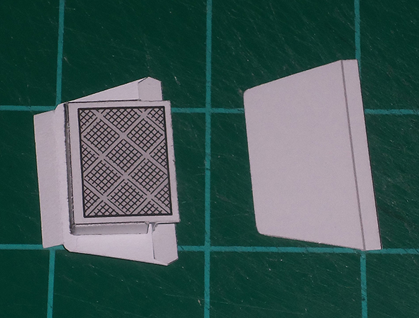

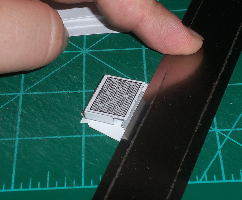

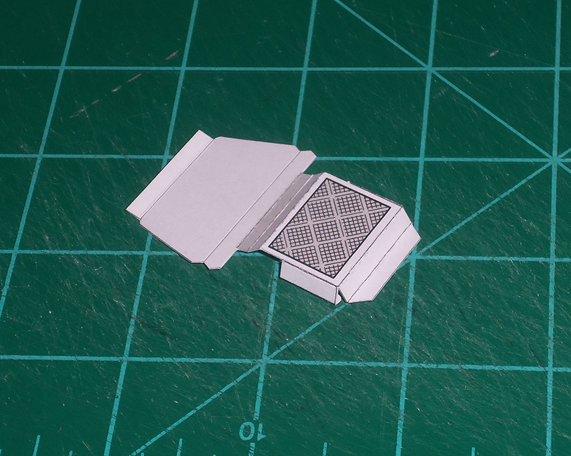

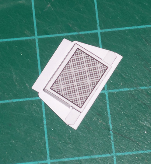

DOOR STEP

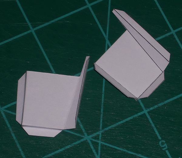

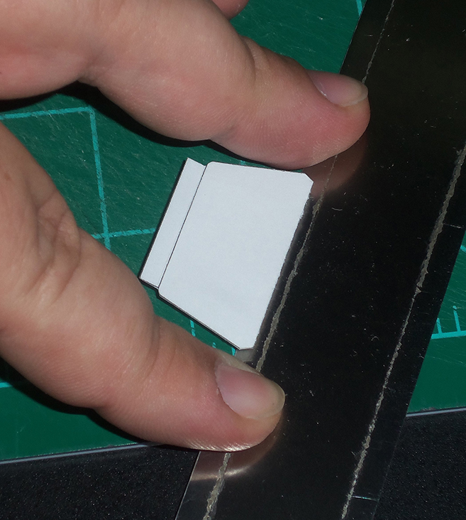

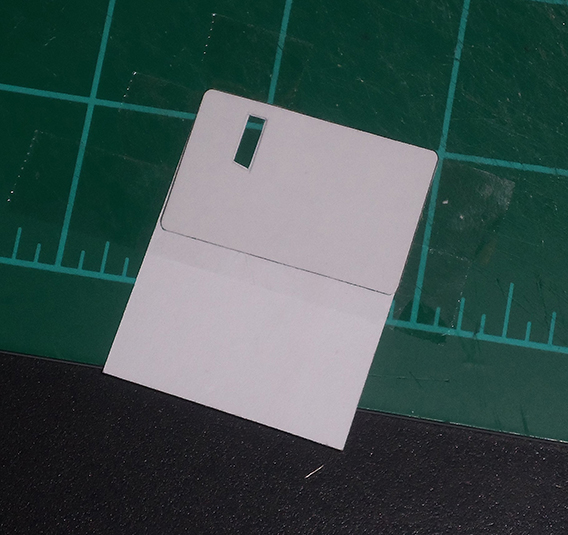

The door step has several mountain and valley folds. It basically forms a box on the back of the lower door section. I used my metal ruler to hold sections straight and flat while the glue set up. This kept any ugly ripples from forming on the outer hull section.
This whole section was then glued to the section of door cut from the hull. I used a light coat of Gel Glue spread with a toothpick and set the bottle of glue on the part while drying to keep it flat and avoid ripples in the skin.

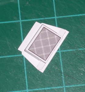

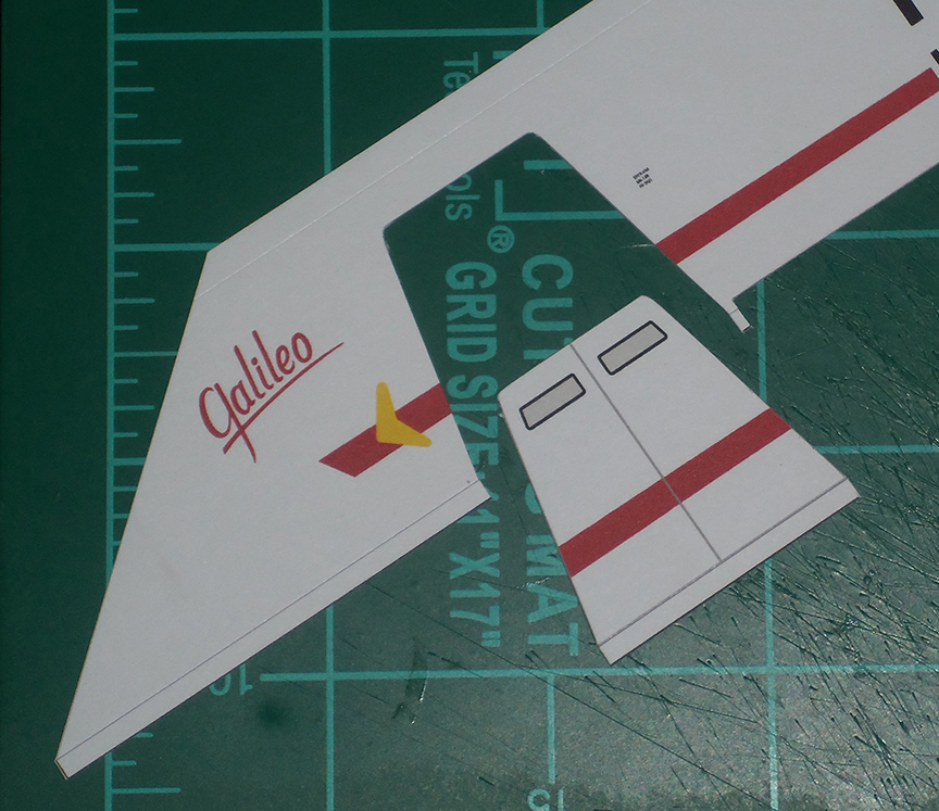

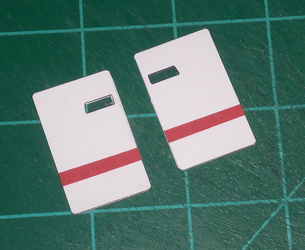

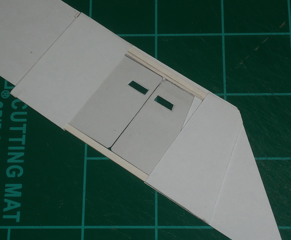

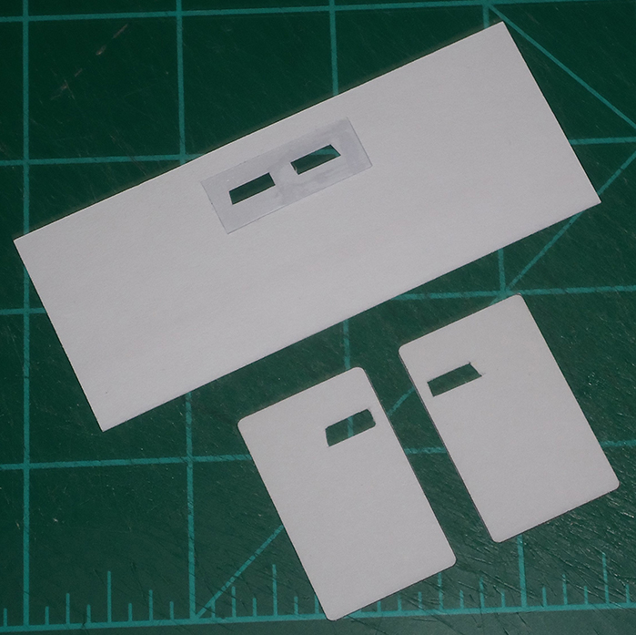

DOORS

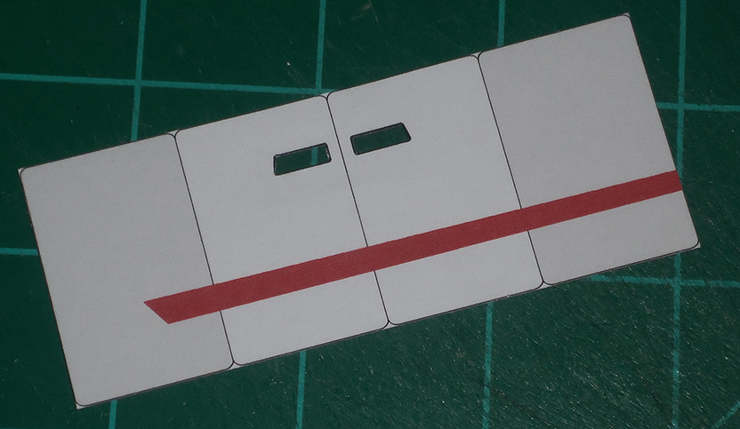

CHANGES MADE: Changed shape of door windows to match studio model. Redid style and placement of pennant across door seams to match.

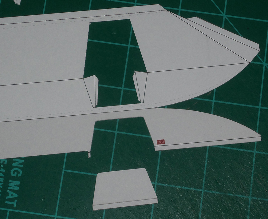

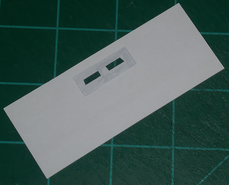

I carefully cut the door sections out of the hull. Then, I cut the windows out of the actual square sliding doors. I glued a piece of acetate to the back for window glass and let it dry thoroughly. I took the cut out doors and used my metal pick to poke holes in all four corners of each window. I then used this as a template for cutting out the back of the door skin for the windows. I used a thin coat of Gel Glue to glue one skin on and placed a heavy bottle on it to keep it flat while drying. Then I remembered how I wanted to do it and used double-sided tape to attach the second door skin. That worked better. Finally, I trimmed the doors to size.

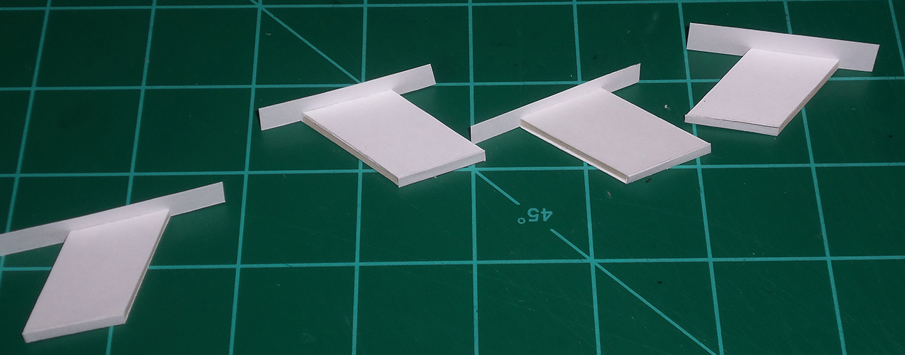

The original door pockets are a box-like design that left the doors sitting more loose that I wanted. And, I wanted to make sure the pennant lined up on the doors and the hull correctly. So, I decided to scratch build a new door holder.
First, I laid the doors on the inside of the hull and marked their open positions. I found the forward door couldn’t be opened all the way unless it had one side trimmed at an angle to match the hull. Then I cut strips of 1mm white board and framed out the door section. This is just slightly thicker than the doors, so they fit much tighter to the hull. Because of the way I’m building it the bottom strip lines up with the centerline.
With the frame glued in, I cut pieces of white card to skin the back and hold the doors in. I slid the doors in and tested the fit and found I’d left a little too much gap at the top between the doors and the frame. I glued a very small sliver of card in to tighten it all up.
I’m leaving the bottom card section across the door until I get closer to sealing the hull up. I also cut off the little tabs the original door design had for opening and closing. My current plan is to attach two small magnets to the inside and use them for opening. If that doesn’t work, I will probably just put a small hole in each door at the strip and use my pick to open and close them. Either way it’ll look cleaner than those tabs do. There’s probably more I’ll have to address as I go with this new design.
