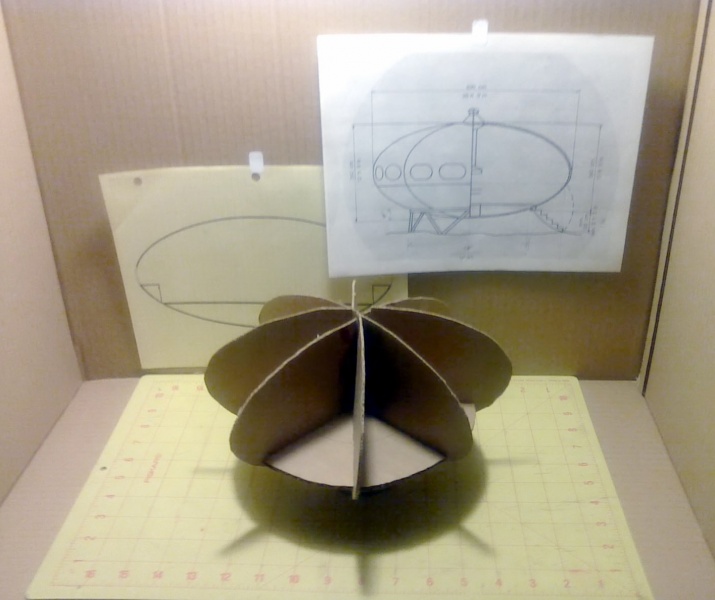

This is a first time for me, first project presented to the board and first model rough from scratch as well so be kind please.
The Futuro fiberglass house was a curiosity of the late 1960s when mod seemed to appear in all the arts from clothing to architecture. This compact little cottage was lightweight, easily assembled on most sites and just darn quirky enough to have always lingered in the back of my mind as a must-do model.

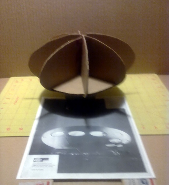

Presented is the very raw assembled templates to get the basic shape and work towards an as yet set scale, likely to be either for Lego mini-fig or Playmobil figurines. The model rests on an empty tuna tin but that is about right for the final-finished support ring-legs assembly.
I'm just working towards a framework to 'skin' and do an exteriors-only at this point, the interior details may follow as time allows but am setting the floor as it is a needed part of the 'skeleton'
Given the time-budget, would love to do a model in styrene as a prototype for a garage kit but that's a ways off at the moment.
Posting a few reference photos of the real Futuro houses and my model at the moment, enjoy !

This should make a neat model. The only problem I see is the outside radius. Double formed curves in paper aren't easily made. If you made this a one off, using a paper-mache technique, and build a plug, the mold to form it, you could have quite a unique mode;. Make the top removable, and you could make a full interior that would be visible. :)

..... The only problem I see is the outside radius. Double formed curves in paper aren't easily made......
That is something of a problem at the moment, assembling the piece as a whole should not be so bad though, going with the real life item's eight (8) segment panel construction. Hopefully doing this will smooth out that issue.
That said, I intend to 'lessen' the difficulty by overlapping the upper and lower 'dome' segments at the center-line where the main row of windows are set. Doing such should make installing said windows 'simpler' and give the model some strength were it might most need it.
It may be cheating a bit but the ribs of the model may end up being cut from foamcore or artboard on the first attempt, that said I might just 'laminate' a few sheets of cardstock to get a similar rigidness.
Scary part is I might even apply what little 'vacuforming' skills I have to make the signature bubble windows, how's that go, in for a penney-in for a pound Sterling.

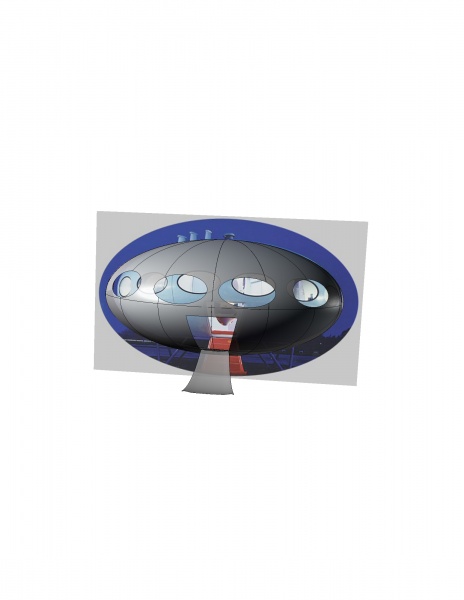

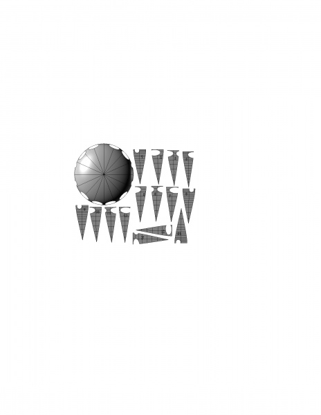

Patron Zero, I was doodling with Rhino and came up with some sections. This would not give a smooth dome, which I think would be very difficult in paper,but would give a sectioned dome like structure. If you are interested, i can give you the whole files unfolded and you can see what you may or may not want to do with it. No charge of course. You can do whatever you wish for it,as long as the final model is free. Send me a P.M.

I'm 99% sure I sent the full size plans to Patron Zero, but in case I didn't, let me know. I could post this but I have not tried building it. I am far too busy. It should go together. Any errors would be small and easy to adjust bit adding or cutting on a replacement panel. It would not have the smoothness of the original futuro because of the limitations of paper though. If metal were used, well, I guess the whole thing could be done with a planisher and an English wheel. :)
