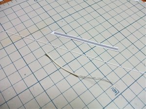

I have made rear mast rigging and derrick for boats.
Material I used are electric wire of 0.05mm dia., styrene round bar of 0.6mm and 1.5mm dia for sheeves and paper for derrick and mast.

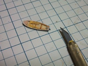

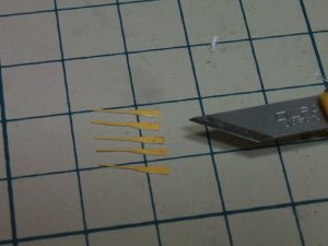

Tonight made a cutter and oars then glued the cutter on deck
