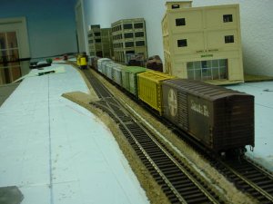

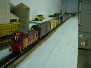

Here's a pic of the train coming out of the west interchange yard:

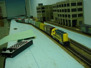

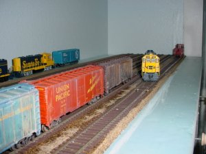

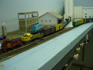

Switching the flux silo and the grain elevator

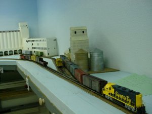

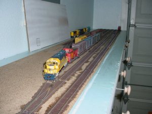

Bringing the geep out of the engine escape, and sorting cars into the interchange tracks

I was so impressed with DocWayne's Gern Industries that I pmed him awhile back. Apparently a huge underground deposit of flux was found in Texas, and Doc Wayne decided that a new facility was in order to take advantage of the discovery.
