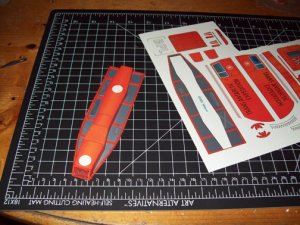

My goal is to find out how much detail I can squeeze out of a simple model without adding anything to the original designer's artwork and maintaining the spirit of Toddlea's Free Model #3 contest. I plan to do this by laminating the same pieces over one another where needed and cutting out grills and holes when possible to provide depth.

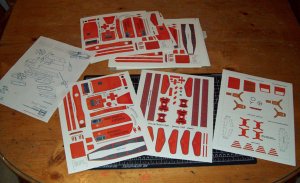

The model consists of only two parts sheets and one sheet of instructions. There is also a third, optional parts sheet to allow the builder to add some detail to the cab interior and suspension... but there are no instructions on what to do with the parts. Shouldn't be too hard to figure out.
As you can see in the picture, I actually printed out three copies of each sheet so that I could laminate the pieces as I assemble the model.

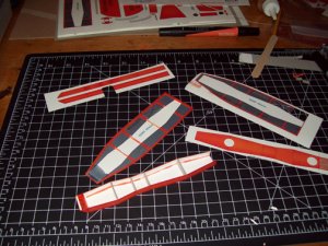

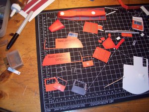

I sprayed each sheet with clear acrylic spray and cut out all the main body and chasis parts. I've left the pontoon and track assemblies alone for now.

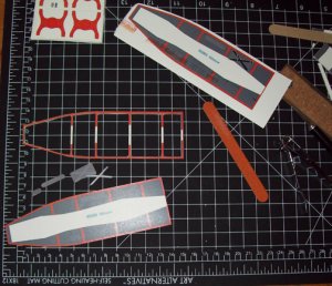

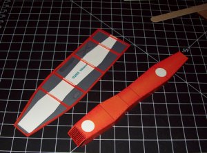

Next, I cut out several prints of the chasis frame and prepared seperated laminated pieces in grey. The frame itself represents four layers glued together and carefully cut out. Boy, I went through several x-acto blades doing that piece!

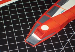

Cutting out those tiny grill slots at the front of the main tunnel was a bit of work. After several failed attempts, I managed it by spraying a light touch of spray glue to the back of the grill so that it had a slight "tack" to it. Pressed it down onto a piece of chip board and that kept the grill lines in place for me to carefully slice out the spaces. Once the spaces had been removed, I gently pulled the part off the chip board and colored the back of the grill. Frankly, I think it turned out rather well.
Instead of resting the main tunnel on top of the frame, I opted to cut down into the frame sections and nestle the tunnel into the assembly. It's not supposed to be that way, but I like how the frame sections interact with the main tunnel now much better.
This was also my first venture into butting the parts together with back tabs. It's definately more work, yes, but I do like that the parts meet each other at an equal level. My next step will be to add a tiny droplet of glue to each rivet along the frame assembly. The glue will dry clear of coarse. But the droplets will add a little more to the illusion of detail with out hiding or changing the original artwork. At least I hope it'll look good!.. : P
That's a good tip. We have 'picture of the week', why not 'tip of the week'? This one would get my vote. :thumb::thumb::thumb:

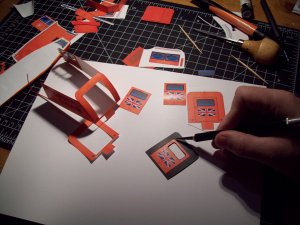

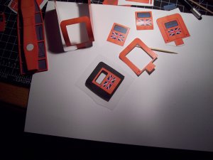

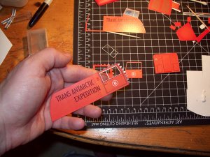

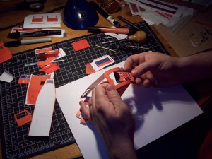

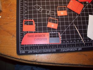

Worked on the doors this weekend. I wanted to show that the doors are separate entities from the body. I wanted the observer to look at the model and say to them self..." by golly, I can see the rubber insulation around the gaps of the doors!"
So this was my attempt to create that look using only what's available from the parts sheets themselves..... and some clear acetate. :rolleyes:
Each door is a layering of cut-out window trim, the door panel itself, a door panel colored black to mimic the rubber insulation, a sheet of clear acetate and the interior door panel.
The model designer didn't provide interior artwork for the model, so I am using the outside panels to line the interior. Not exactly correct to the original snocat... yeah. But the model itself looks a heckuvalot better. I covered the Brittish flag with plain, orange "panels" taken from another area of the model sheet. And since you will only be able to see the rear interior from the skylight in the roof and the rear window itself... it's all the realism I need to pull off the ilusion of an interior door panel. I plan to use the same method to cover the side walls and floor of the cargo area.
So...After all that careful cutting and measuring and delicate edge coloring... do the doors look like they are nestled into the frame with just a bit of the rubber insulation showing itself here and there?
hhhhmmm...... doesn't look much different does it.... Dunno if my brilliant plan worked. Well, at least the doors are on now.:rolleyes:
Those tiny white pieces of window trim were a special trip through hell to cut out.
David

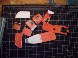

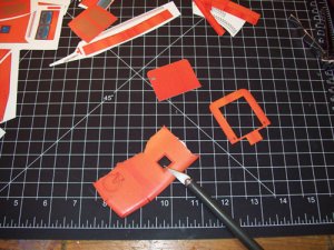

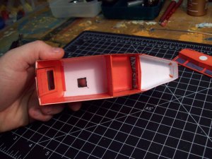

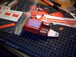

I made a big mistake. Was so "into" getting the stupid thing built that I just started assembling the snocat without even bothering to follow the builders directions. And so, I ended up with the chasis, body sides and back, but had no way to install the top! AAAAAAAUUAAHAGHAUUAGHglglglg!!...
I tried to force it to work.. I really did... but had to admit that there was no way to do it.
So... I had to tear it apart and salvage what I could. Luckily, the tear down and salvage went very well and I was able to reuse many of the sub assemblies that I'd so painstakingly built.

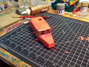

Using the salvaged sub assemblies, I rebuilt the body...starting with the top _first_ this time. Went together well. Those compound curves are tough to simulate accurately tho.
By far the most difficult piece to build was the front windshield and frame. Such thin frame edges next to the "glass" made it a holy terror to cut out. Add to that the fact that I needed to cut the same part out THREE TIMES.... the interior piece for the cabin, the outer piece with only the "glass" area cut out to show off the rubber, and the final, outer trim piece, with both the "glass" and the "rubber" cut out.... the latter two pieces are sandwiched to each other and then placed over a piece of clear acetate. The inside peice was glued to the back of the acetate making a complete, windshield sub assembly.
I'm not willing to admit how many of those I went through till I had three usable pieces... nor how many x-acto blades I used up in the process either. ; )
But the body is together now and looks good.
You'll see that although the designer did not provide an inside cabin roof piece, I was able to continue the color of the painted metal by simply reversing a section of the outer roof and gluing it upside down into the cabin roof. I think it looks great.
The last photo is my attempt to point out the little pieces of extra laminated details pulled from the prints. I'll go into this more next post.

That's a major setback, but you've coped well.
You could have ploughed ahead and not mentioned it.
It's great that you did, though - it alerts others to the need to
read the instructions - or at least think ahead.
It also says a lot for your honesty, and I admire that.
Those thin bits that need folding - I fold those with a lot of
waste still on the part, then cut off the waste after.
It's still fiddly, but a bit more manageable.
Anyway, great going! :thumb::thumb::thumb:
That's a good, clean, square build.
Enough said, which is a very rare statement when it comes from
logicman.

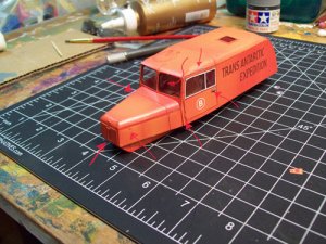

Okay, I only have the one photo this time. I spent some time carefully cutting out door handles, door hinges and hood hinges and latches from an extra sheet of parts. I was even able to cut out a set of windshield wiper blades from the parts sheet as well. Hey, the designer included them in his artwork.... I'm installing them on my model. ; )
Each little piece was installed with a tiny drop of glue and much holding of breath.
The seats, steering wheel and dash are all installed as well.
I'm amazed at how effective just an extra layer of detail can add to a relatively simple model. The simple addition of a tiny strip of paper now says "hinge" and makes the door.... just... "feel" more like a door in my mind now.
I still have to build and install the headlights, exhaust pipe, roof hatch, and storage bins... but, I'll do them after I get the traction pontoons completed.
Next post, the traction pontoons...
