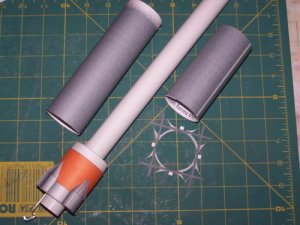

I haven't posted here in some time, so I thought I'd get beack into the forum with the build thread of Ton Noteboom's Soyuz. The model was designed with flight modifications in mind, with provisions for clustered motors, one in the second stage and one more in each of the boosters. In the interest of simplifying what was going to be a complex build in the first place, I decided to go with a single central engine.

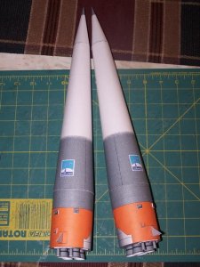

I began by building the boosters. No real complications other than it taking a fair bit of time, as there are four of things to construct. I begin to get the feel for the scale of this bird. It is not a small model.

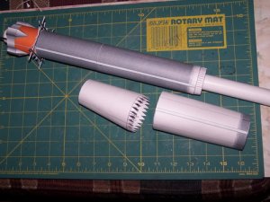

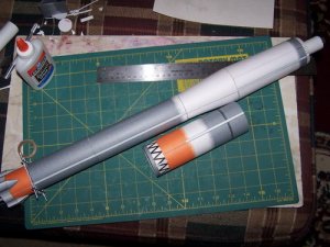

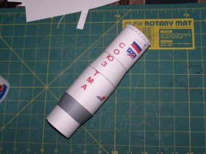

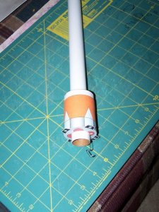

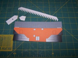

Next comes the second stage stack. A standard model rocket body tube serves as a motor mount/stuffer tube. It runs up the body into the lower section of the interstage. The body of the rocket is double layered 110 lb stock. Centering rings are cut from 4X laminated card stock. In between the stuffer tube and the laminated body, the rocket is remarkably strong. The interstage area will be the parachute compartment.

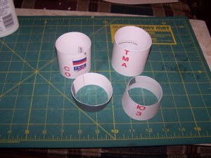

The Soyuz cover and capsule will be the nosecone for the rocket. Once again, construction is a double laminate. The capsule carries 3 ounces of weight to bring the center of gravity forward to give a stable flight.

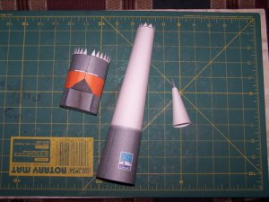

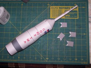

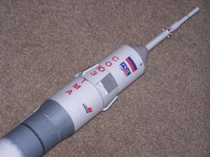

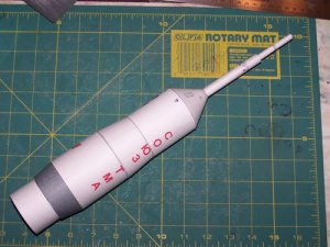

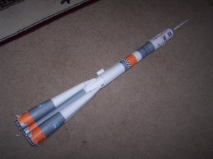

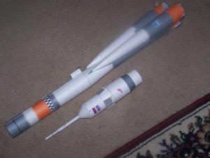

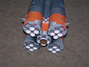

Now it's just a matter of putting it all together. There's a small alignment tab in the booster web that makes the spacing of the boosters a snap. A few final details are put in place. Two standoffs are affixed with launch lugs and a length of heavy elastic is fastened between the interstage and the capsule. This was built to take a 24mm rocket motor. Final weight of the model is just over 10 ounces.

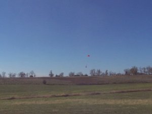

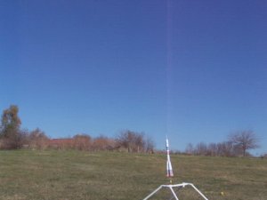

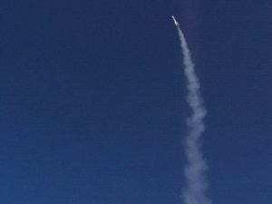

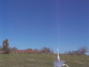

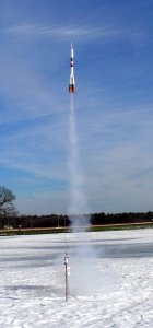

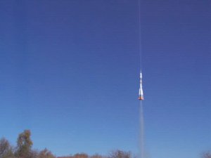

So far, she has one flight under her belt. She flew on an Estes D12-3 engine. Liftoff was slow and elegant. On this motor she only reached an altitude of 200 feet or so, but it was fine for a first flight. For subsequent flights, I'll use higher powered AP (ammonium perchlorate composite) motors. They'll give quite a bit more altitude. Recovery was on a 24" nylon parachute. It was a very clean flight with no damage on recovery, I'm looking forward to flying her again.

As for the laminated body, I would really recommend it. It adds a great deal of strength. I cut an interior piece the same size as the original, apply a layer of white glue, lay the two pieces together, but offset a bit, to make a glue tab, then roll the assembly under a mandrel to establish the curve. Once it has dried some, I can trim a short length from the glue tab to get a perfect fit and complete the tube. I hit upon this method while working on this rocket and it seems fairly reliable.

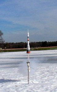

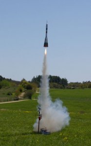

Hi,

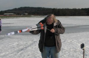

I just saw this thread and have also converted Ton's Soyuz for flight.
For what it's worth, I used 3oz of clay ballast in the nose as far forward as possible. It balanced just slightly ahead of the booster tips with an E9-6 installed. The all up finished weight was 8.2oz.
I did not do double thickness on this like I usually do because of the full length stuffer tube (22.25") until I got to the parachute compartment. I made the parachute compartment and everything forward of that double thickness.

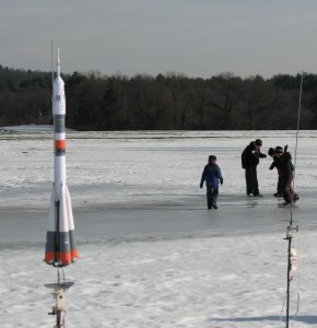

Predictions from wRASP was 321 ft on a D12-3 and the first flight was on a D12-3 and maybe it got that high (pictures from winter launch).
The second flight was on an E9-4 (wRASP prediction 562ft) and again nice straight flight but certainly didn't get any higher than predicted. Sorry, no picture from that flight but that will be a good "small field" motor.
Third and subsequent flights have been on Aerotech E18-4 (747ft predicted altitude) and gives a good flight. (summer pictures).
The F24-4 looks like a good motor that will keep it just under 1000ft so I may just try that next if we ever get a day with low enough wind speed.
