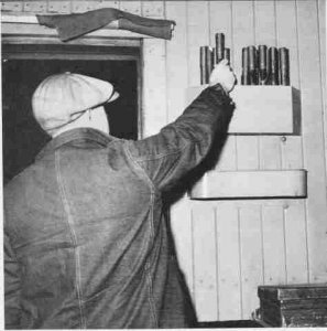

Jim you hit it right on the money the Museum had the flags in that thing to the right hand side of him but what is that really for?
I would assume flares but anywho back to the flags what collors are they just red then?

Those are fusee.They are use for signaling..If we was going to stop we would drop a five minute fusee when we would begin to slow down then about 1,000 feet before stopping we would drop another fusee..This was to warn following trains that there is a stop train ahead..After stopping the rear brakeman would take his Handlin' and a two fusee and protect the rear of the train..If the brakeman saw a train approaching then he would light the fusee and give the approaching train a stop signal..You see a fusee is much easier to see at night due to the brightness of the fusee.
