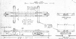

Below is a sketch of the Argent Lumber Co. log cars, as well as some catalog pages from the russel log car catalog. Hope this helps.

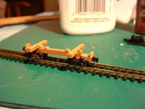

2nd. attempt
OK it is getting closer and more difficult as my fingers aren't small enough to get in so tight. I have to use my maginfier too. With a load of logs this one shouldn't be too bad.

That last one looks good Robin. You might want to think about making disconnect sets. Kaddee makes them for ho scale, but it doesn't look like it would be too difficult to make them in any scale.
Thanks Will and Russ
This is a tiny one so it's about my limit seeing as I need another 9 of them

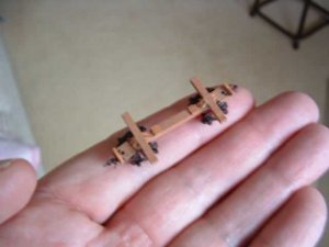

This photo gives you and idea of its size.
