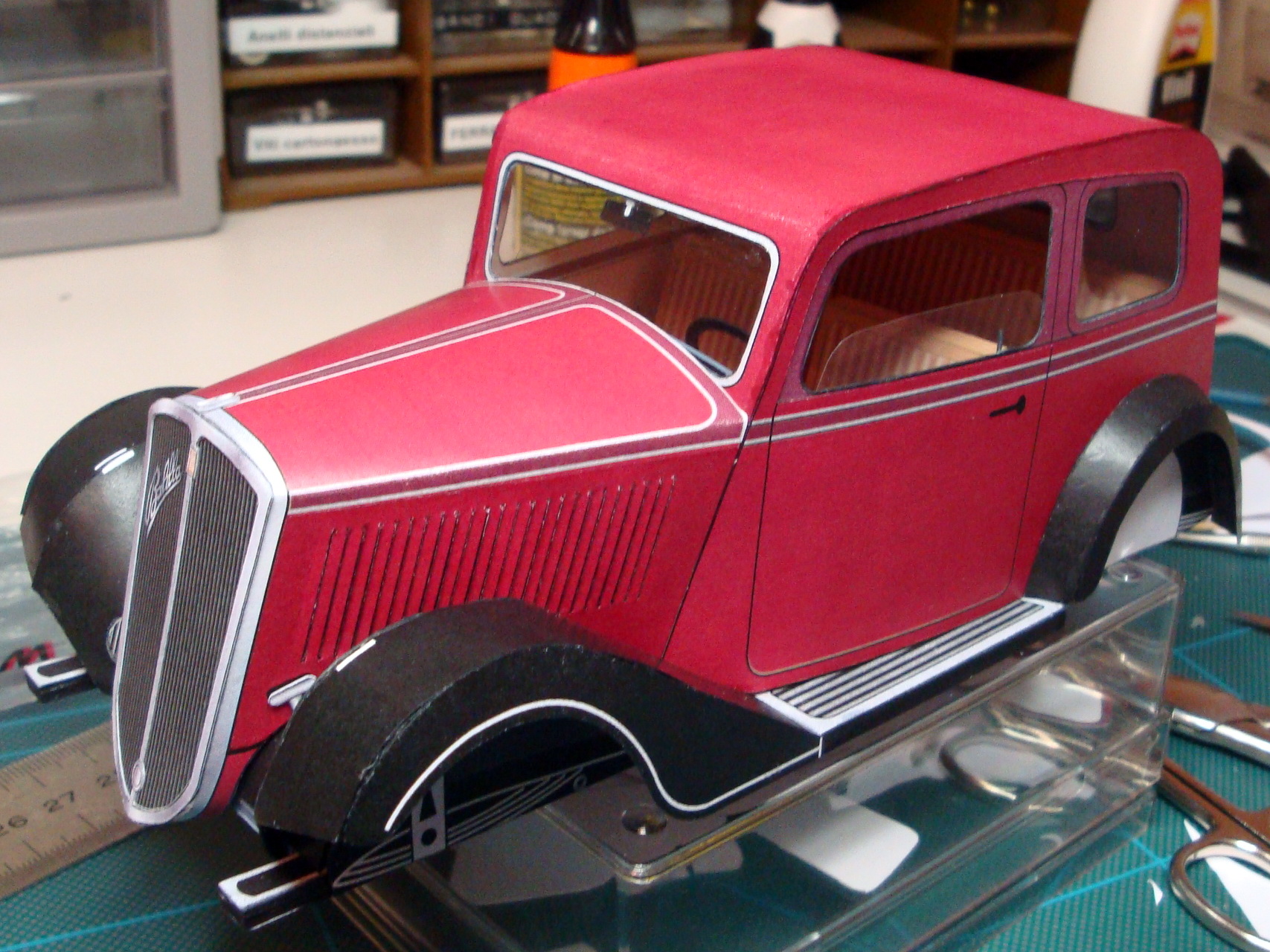

Damned!! The fit looks fantastic to me!! Truly a beautiful machine! :)

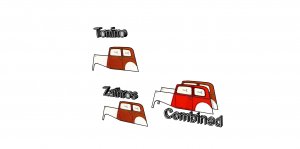

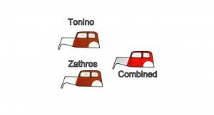

Tonino, I put the original image, then yours, and then extracted one using my CAD program. Your panels are 100% perfect! They could not be any better. This is great because it means I can just make the frame and not worry about fit. I'll send you the plans for the frame by email, I will send it as a .psd file so you can manipulate it. I must make a body in the scale you are making, then one 200% bigger, as I wish a bigger version of this car. You did an excellent job. I am extremely pleased and I would say impressed, but I have come to expect this kind of work from you.
The picture with your name is the original trace.
I redid a panel in Rhino 5.0. I then stacked them together, there was no difference (Top Picture). I rotated the picture slightly so you can see how your "new panel" lines up perfectly (2nd Picture). :)

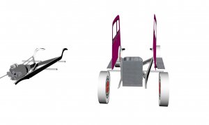

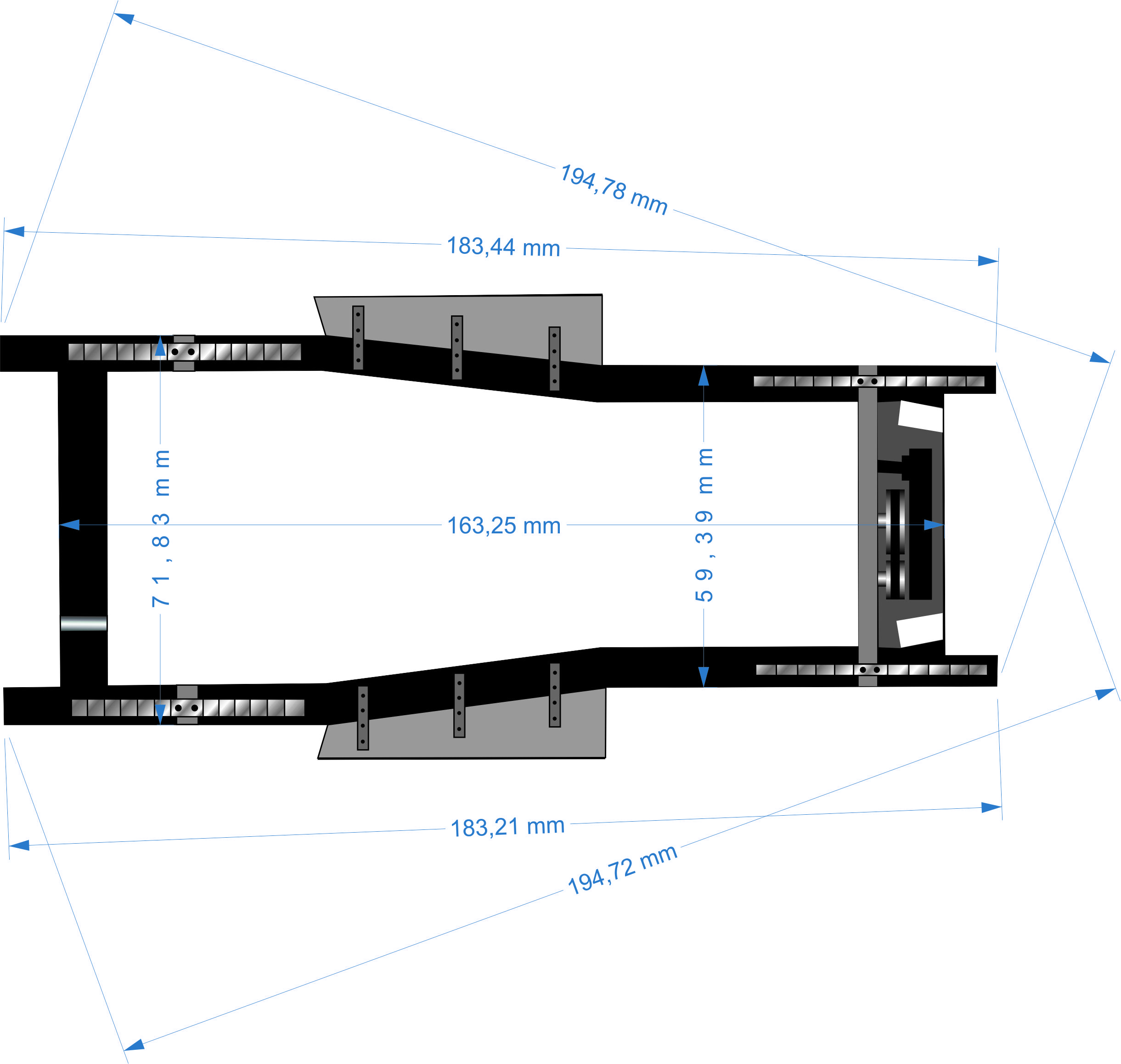

Well, I got the frame parts, then tried to put them together virtually, but it's taking too much time. I just needed to bend some stuff to make sure the scale was right. I am using the line drawing you gave me in .ai (Adobe Illustrator) as the actual size. please let me know if this right, if not I need a dimension of the overall length ob the body panels, and it has to be exact from the bottom corner, all the way to the front. Draw a perpendicular line that will go against the bottom of the radiator/grill panels, so you can draw a perfectly straight line. Once I have this dimension, I can scale all the rest to it, and start making a frame model. You don't have to measure it. If the .ai file is the exact size, I can use that. Trying to construct it on the computer is taking too much time. One I have scaled the parts sheet, work can begin. :)
Fantastic work John! I cannot wait to put my hands on your frame!
If the export function on CorelDraw doesn't alter the size of the parts they should be,in the .ai copy I sent you, exactly as in my prototype because I used the prints as they are, without any re-scaling. Anyway, to be sure, I traced some measures on my original frame to help you doing some checks. Here they are (all in millimeters, excuse me, old european units...) Let me know if the quotes are enough for your purposes.
Thank, a lot!! Now I can continue! :)

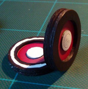

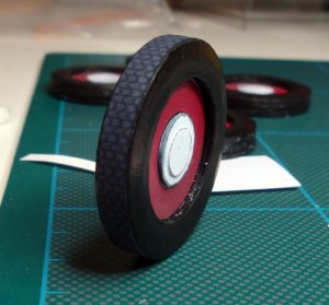

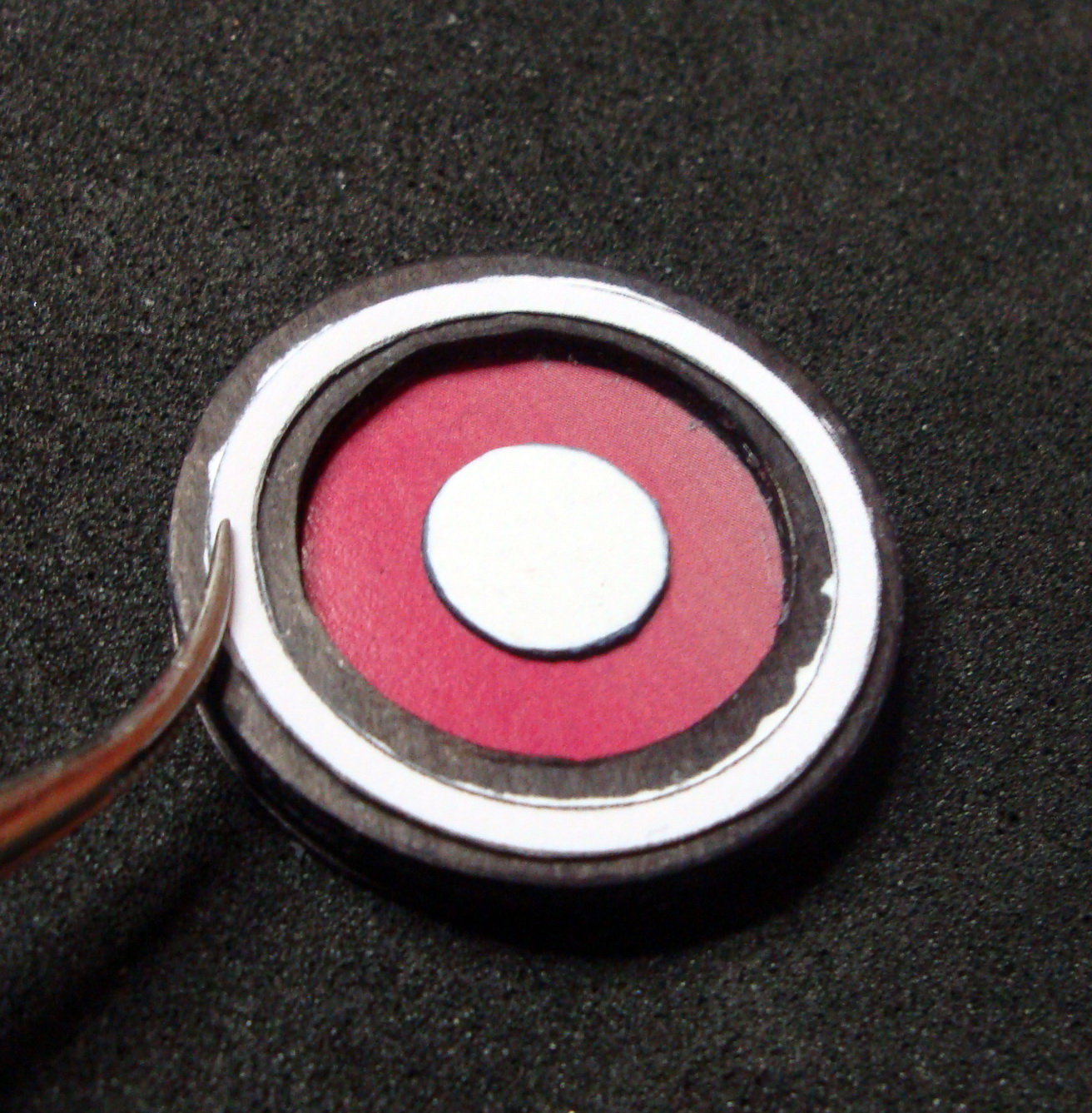

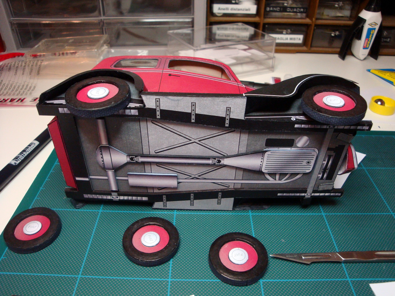

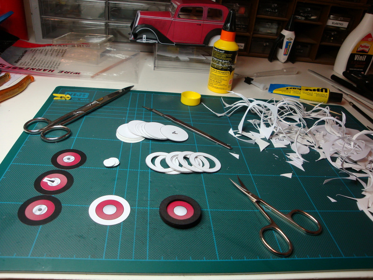

Once completed fenders it's time to deal with wheels. Many ideas on how to enhance them.
The many parts that will form the "sandwich"

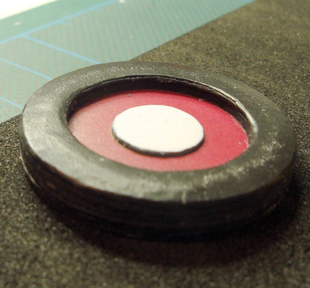

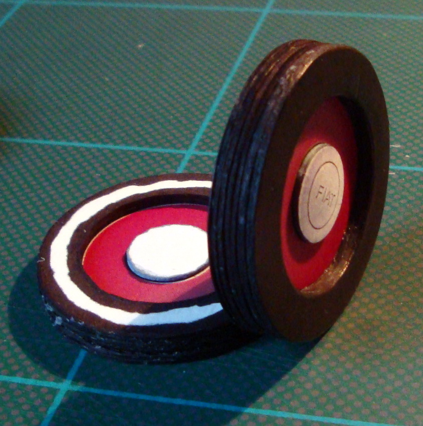

but, unfortunately, I don't like the look of the tyre: too "square". It would be necessary to draw it from scratch using cone sections instead of cylinders but my poor 3D skills won't help me. I need a "B plan"
I started adding a little ring of cardboard to raise the cental section.

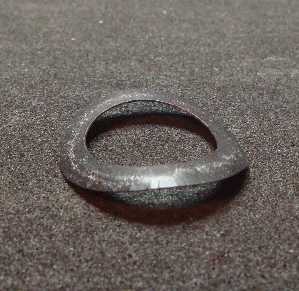

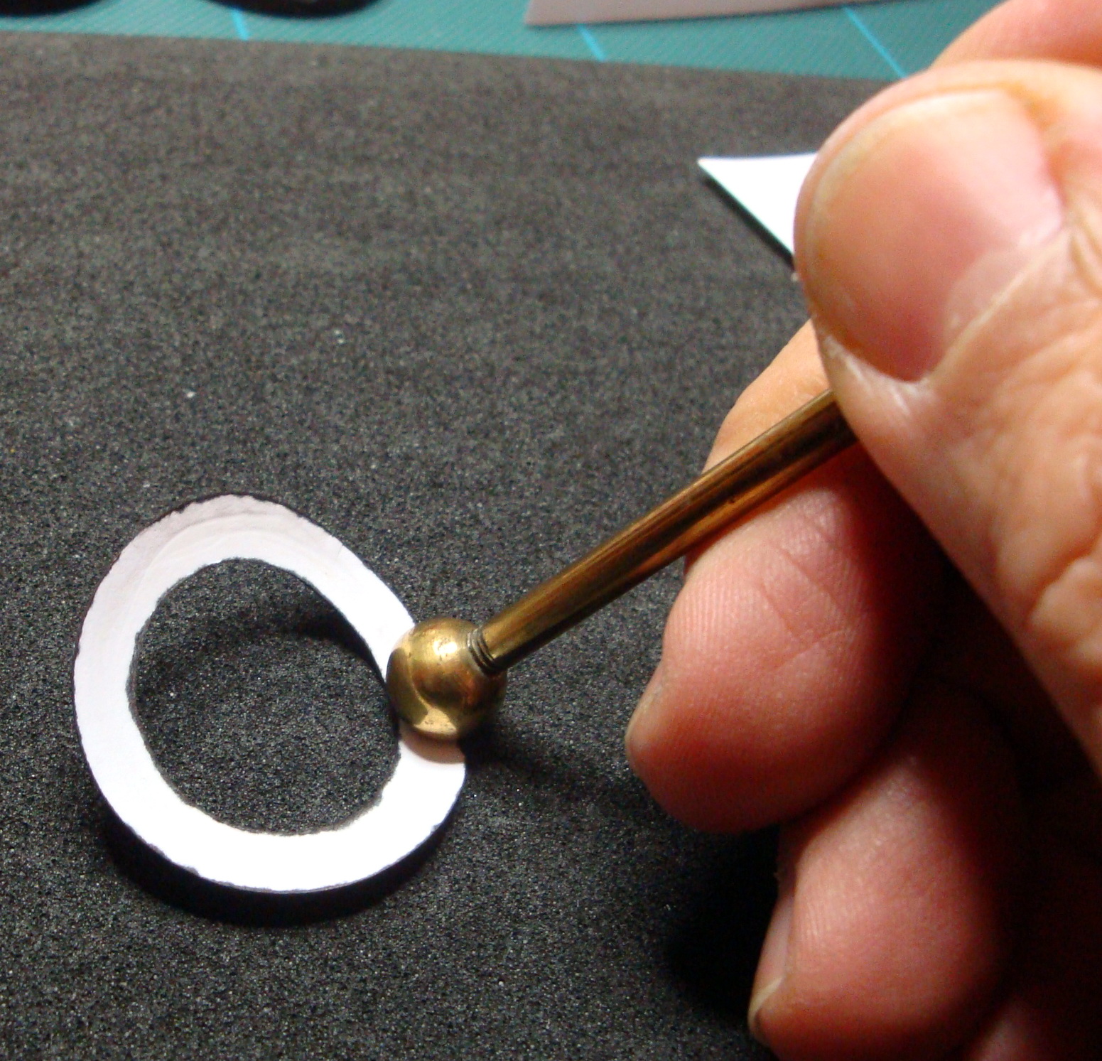

Then I shaped the outer tyre ring with a little custom tool (the pole of a little flag) on the rear of a mousepad.
The ring now has a more "fatty" look
And the wheel look somewhat better than before

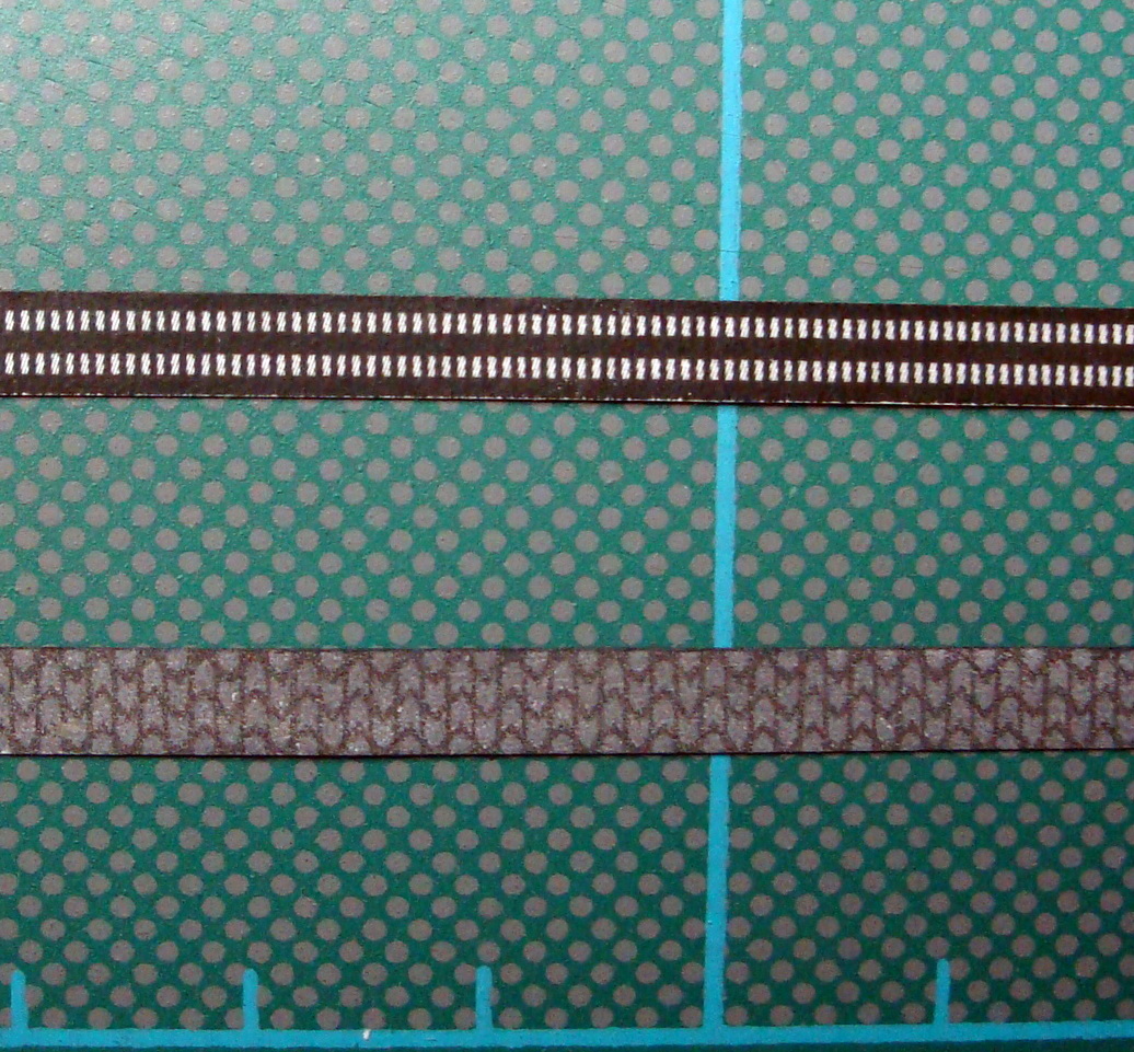

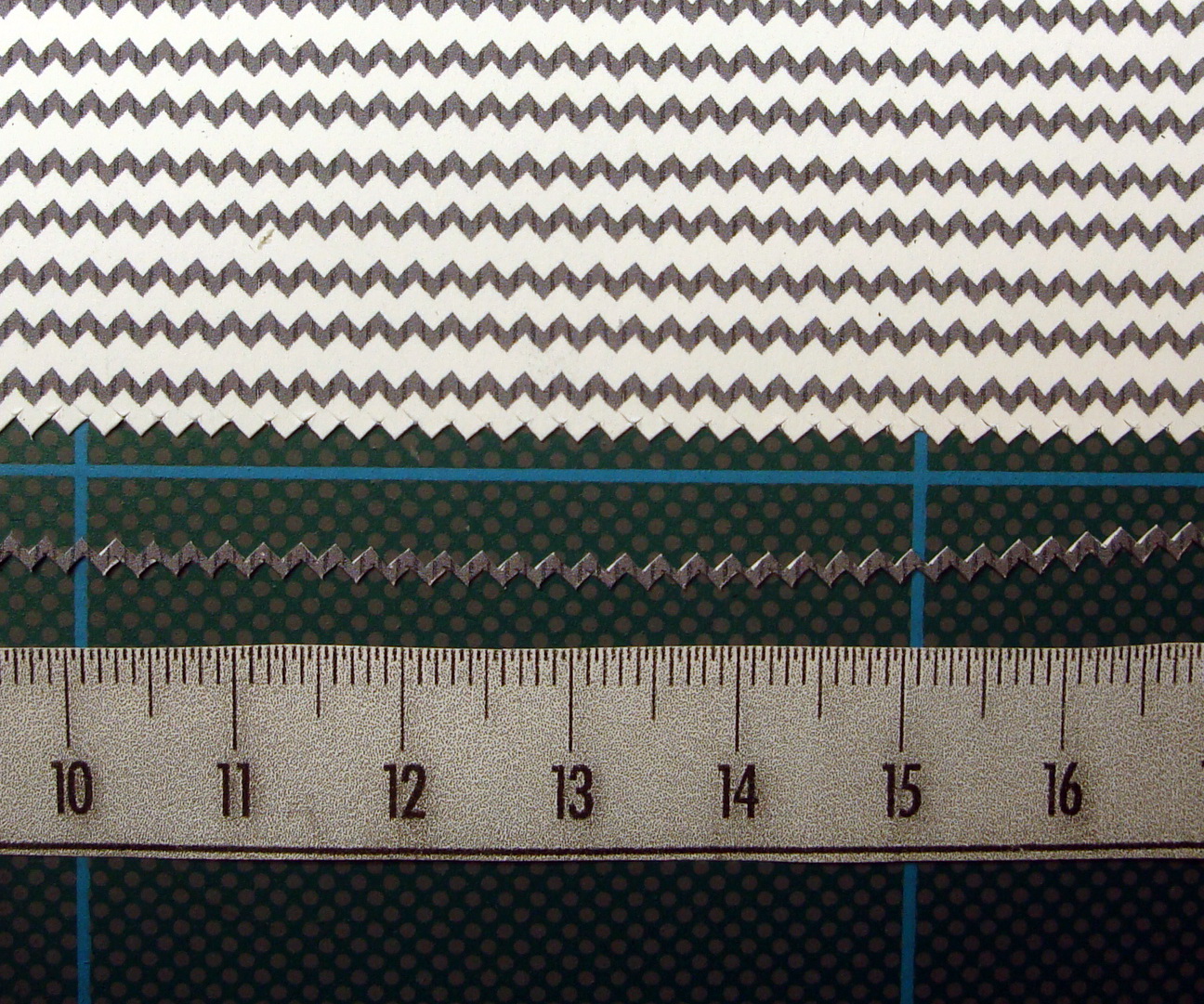

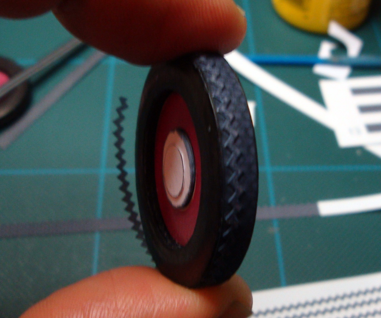

The first thread I drew was really ugly (above). I tried to create something more realistic (under)
I considered also to add a raised thread but the work would have been very much and the result not very nice. Not worth the time to cut all those zig-zag's!
And this is the result: much better!
As I said before the experiment with raised thread was rejected. Not very realistic. This is the test.

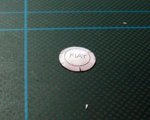

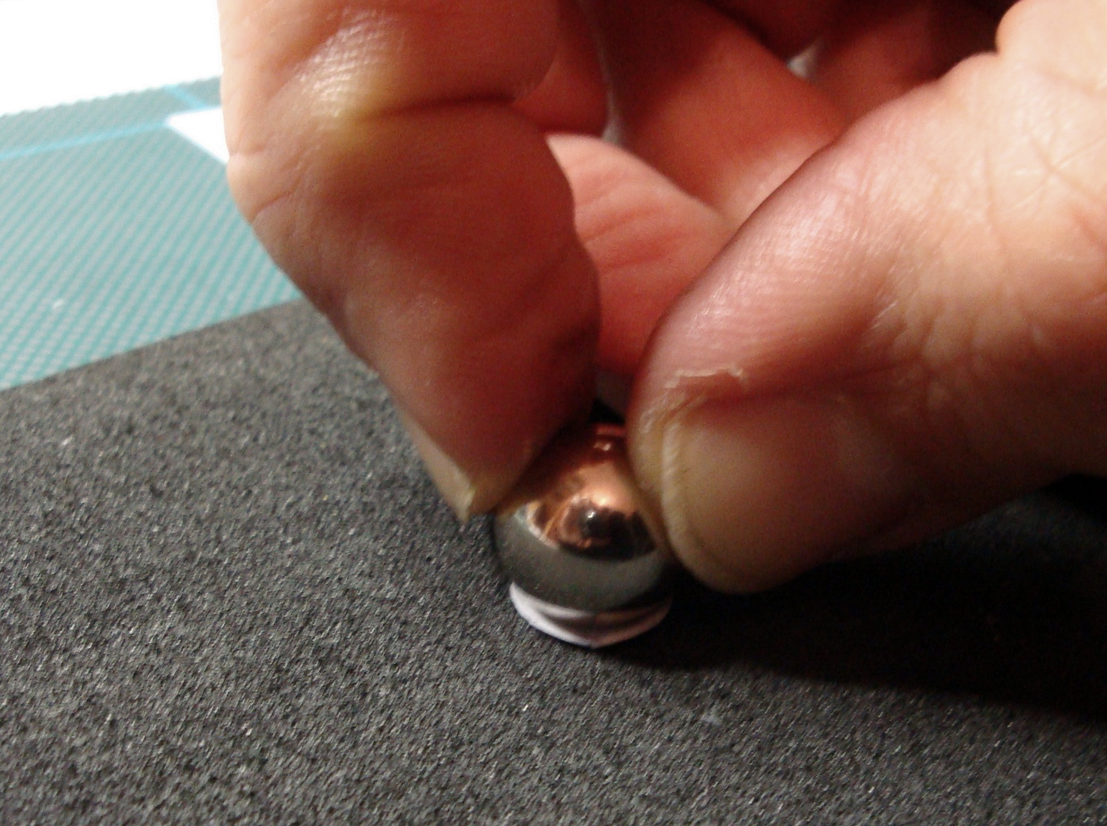

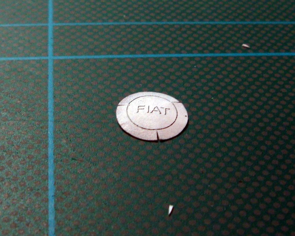

Some work on the hubcaps (is this the word?) to give'em a spherical surface.

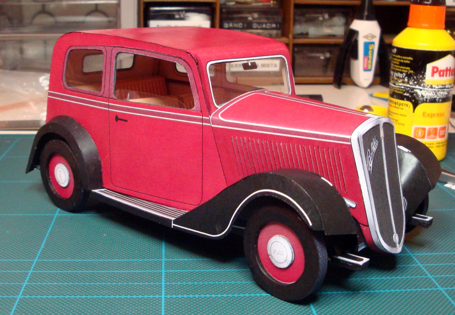

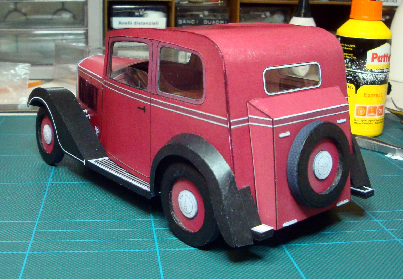

And here are the wheels: my Balilla soon will stand up!

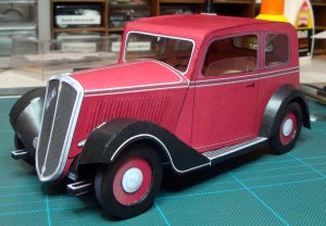

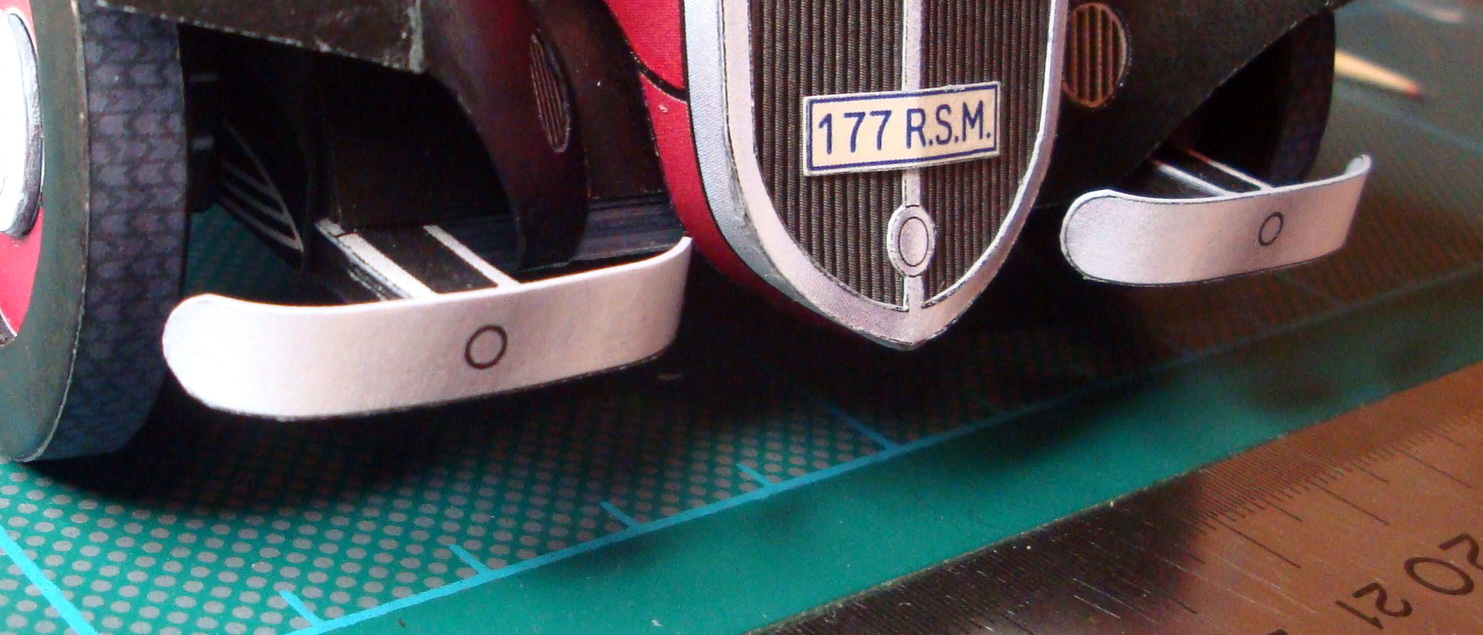

Almost done! Last details still to do: headlights, licence plates, bumpers and door handles... then this build is over!

Tonino, if you can get some Liquid Electrical Tape, you could pull off the tread pattern, as the Liquid Tape would fill the gaps in such a way that the wire would look one with the thread. That being said, those tires came out beautifully!! ;)

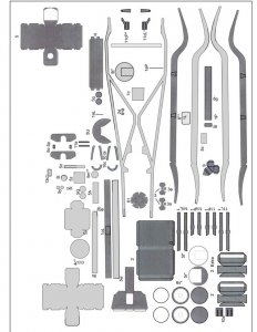

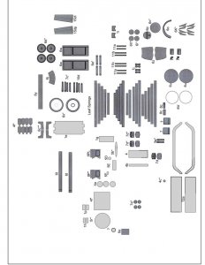

Got much further with the frame, if I sent it to you in .ai format, could you scale it to your needs?
Sample below: (These are missing two parts, they're done, but the sheets are not usable.
WOW John! It seems a great piece! Wonderful sensations looking at all those pieces...! But I'm afraid it won't be a cakewalk!
Please feel free to send to me anything you want! I'll try to take some measure to figure how it can be married with my existing car.

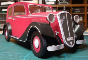

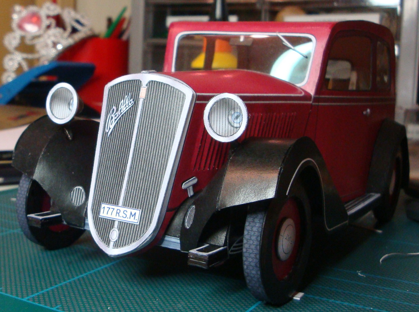

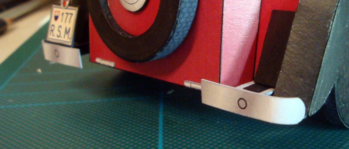

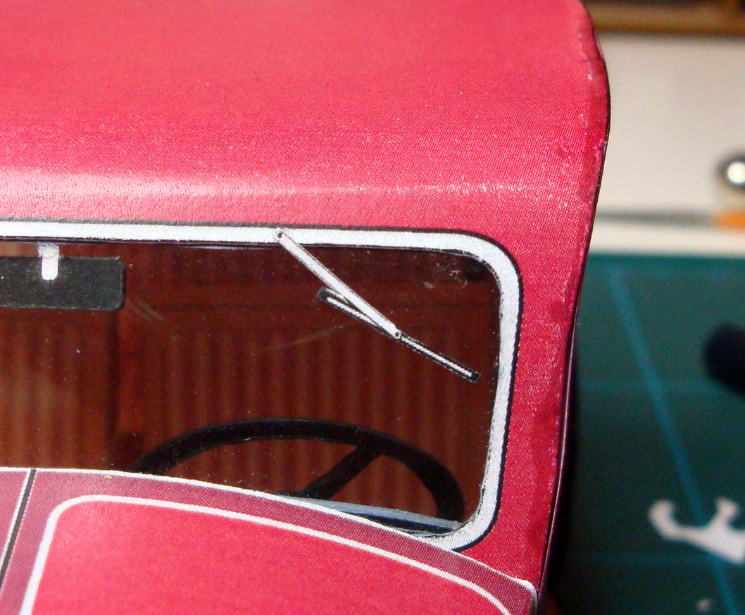

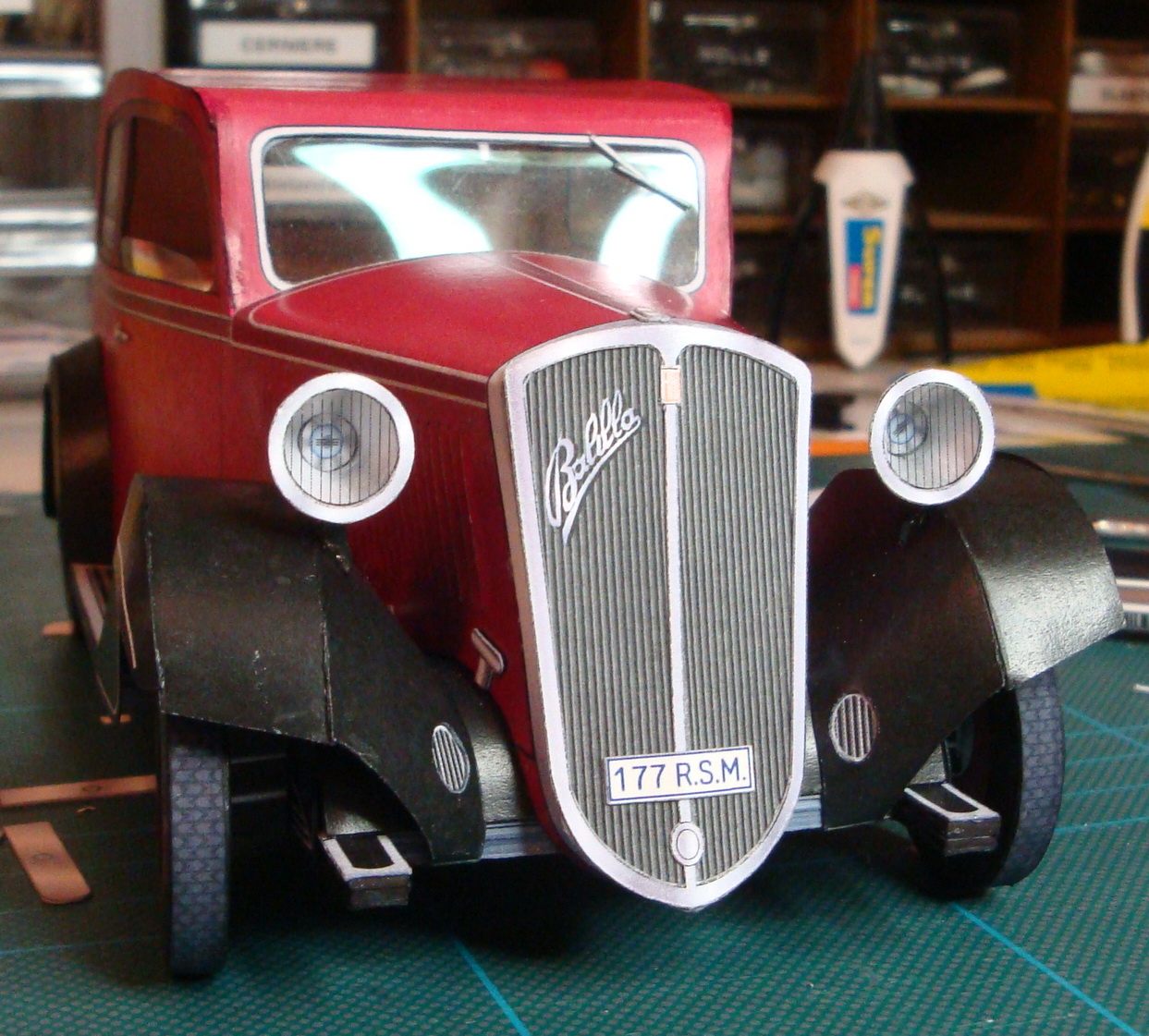

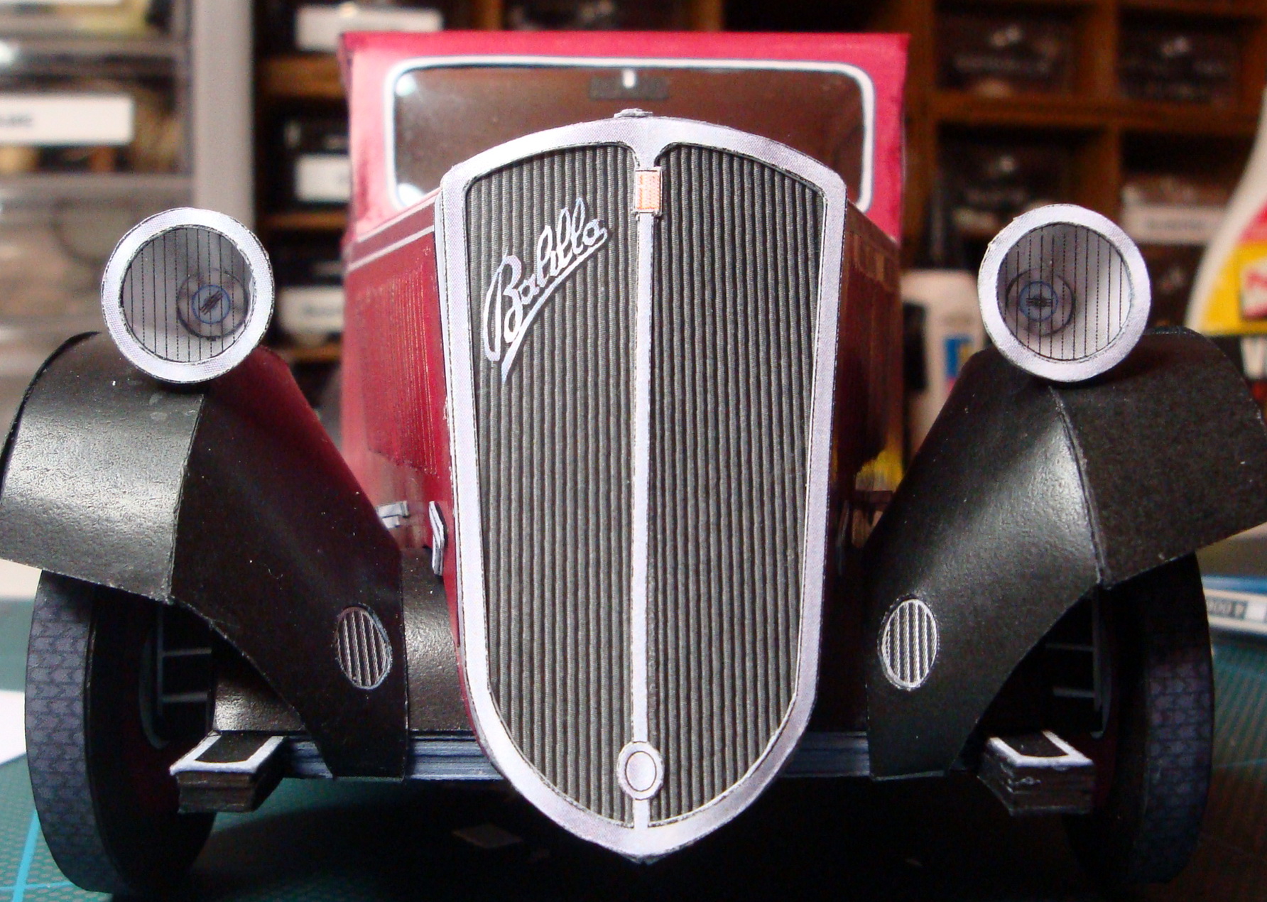

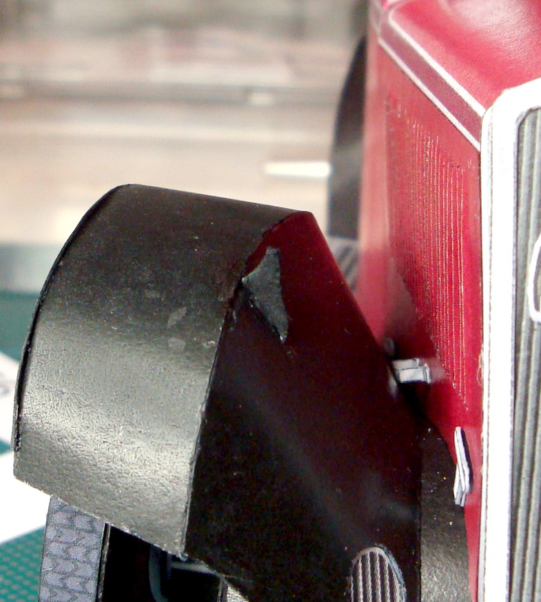

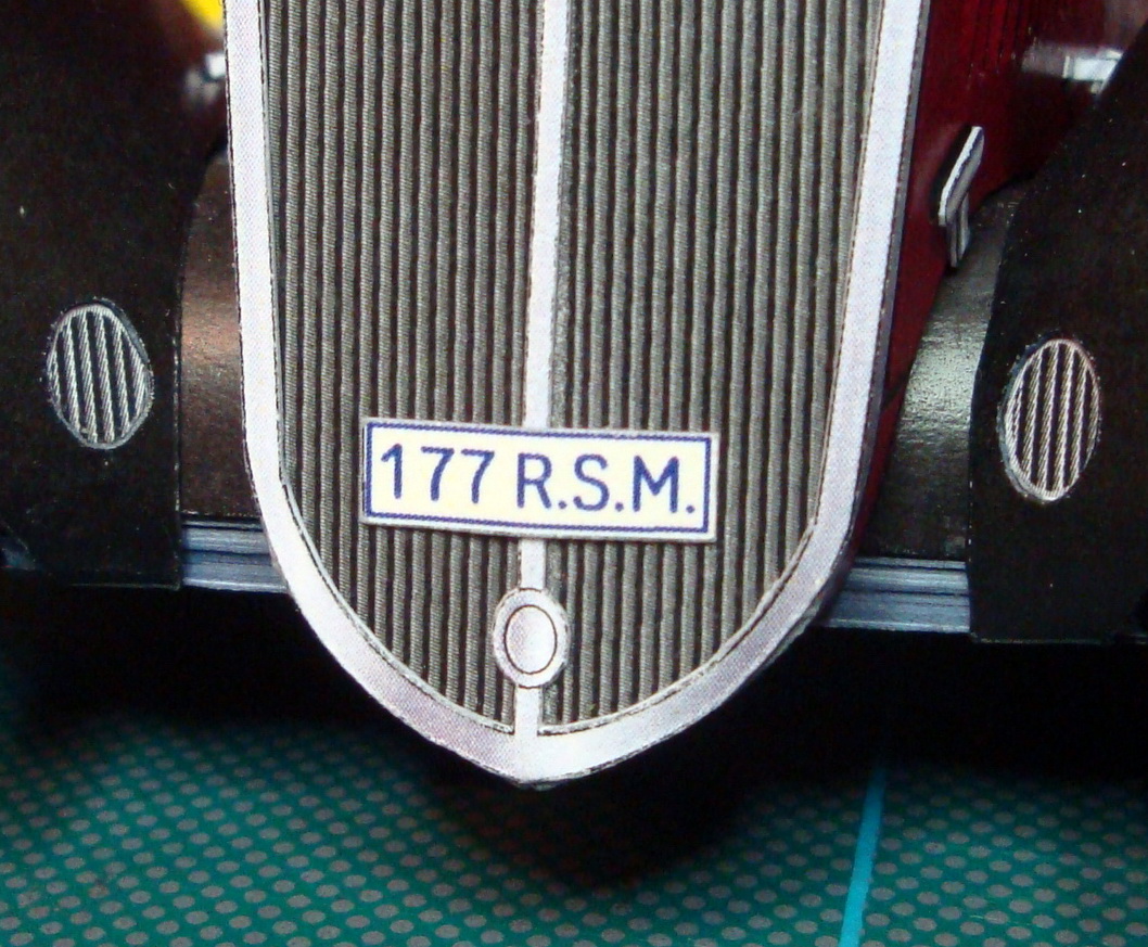

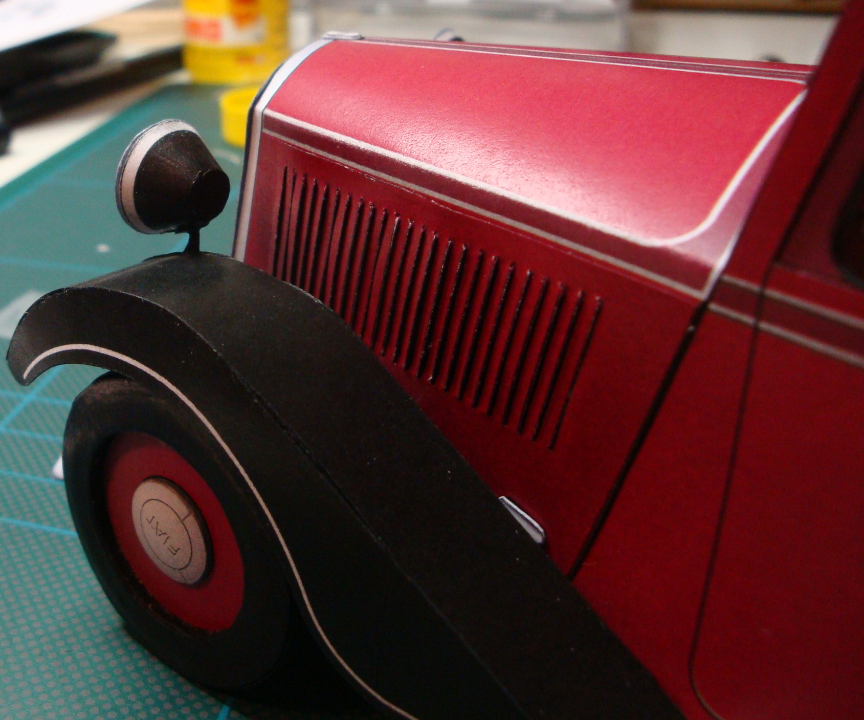

...and finally the headlights. They gave me some troubles...

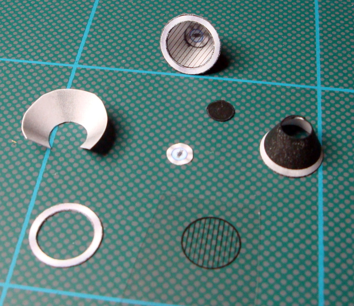

First of all a look to the many parts I added to give an internal detail to the lamp visible through the transparent face.

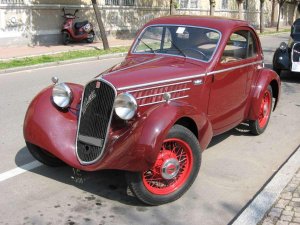

The original model had the headlight fixed directly to the front fenders
I definitely didn't like this option. The lamps are too low and distant each other. Not realistic and very different from the photo of the real car. The "expression" of my Balilla was not convincing this way.
I finished drawing other pieces.
Two little supports for the headlights with the shape that is clearly visible in the photos I have.
Here is my little support.
Now the question is: how to let the big headlight stay on that little edge?
So I added little plates to act as a tray
Now the look is much better, even if still not the optimum (I feel like the lamps are somewhat too little and distant, but this is a problem related to fenders shape...)
Now just some more little retouch here and there and then I can make the final photo reportage!

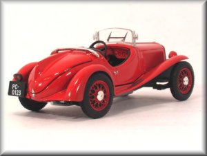

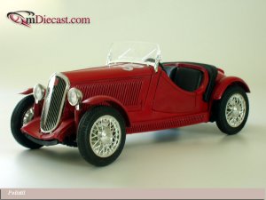

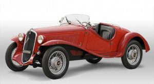

The Balilla looks beautiful. wouldn't touch it. Maybe you could make a frame a make a sports car version, that used the same frame, slightly different front suspension as they did not use leaf springs, but double a frames with a large hydraulic reservoir for the shock absorber, :)
Maybe like one of these. My favorite is the Copa D'Oro , then again the Berlinetta is magnificent, as is the "Sport! :)FIAT-508S-Balilla-Coppa-dOro-03-665x380.jpg Coppa d'Oro.jpg FIAT-508S-Balilla-Coppa-dOro-02-665x363.jpg fiat 508 Berlinetta.jpg fiat-508-balilla-sport-02.jpg fiat copa d'oro.jpg
