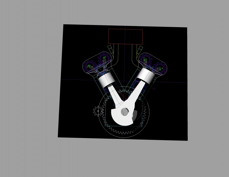

At last the design work for the engine is 95% complete, only the timing cover, inlet manifold and the fuel rail needs to be flat packed and then the build can start.
This model is not going to be a small build at all, as the above picture shows it is 737mm's long, by 383mm wide and 430mm high.
The engines cc capacity is 1811cc or 151cc per a cyclinder.
The bore and stroke is 62x50mm
At the moment the head requires about 102 A4 pages of paper, and the engine block with pistons is about 84 pages.
I am guessing that it it would need about 250 pages of paper in A4 or letter size, as I have set the design up for both printed options.

The scary thing is the size, when started the project I knew it was going to big, but now that I have put a few important sizes to the model, I know the wife is going to raise a eye brow or two with a few words but I will find a home for the master piece.
First part of the build is to check the piston, bore and head design with the gears, that is my bigest concern at the moment, I know that I am going to have to have the tolenances quite open on the model as to left it move with no binding issues.
I guess my new best friend is going to be my digital calliper.

People who build these really either should have an idea of how an engine works, or will definitely learn how an engine works! I had a digital Caliper but I always liked my Starrett and Mititutoyo dial calipers, I felt they were accurate. The digital ones never held up like the dial ones but then again there was a great price difference. I have a pair of Mitutoyo calipers with carbide faces. They are extremely accurate as the faces are 100" thick/ However, being carbide, used improperly they can scratch a surface so must be used carefully. They are great for on paper for measuring and clamping parts together! I played around for a few minutes in Rhino and the timing on this will have to be right on the money. You could make the crank like Pre-1983 Suzuki's that had pressed cranks. That would allow the whole assembly to go together sideways and adjusted, the glued through a whole or side plate (they would be like thrust bearings).

Rhino 5.0 has a new animation feature. I am going to have to figure it out I guess. Something new for this old Brain! Your expertise blows me out of the water. I still remember that incident when someone tried to accuse you of having to copy anyone else's work. I think that settles that ridiculous issue! This work of yours is brilliant! :)

One thing that I have been thinking hard about over last while is getting the valve timing correct but that will get to with the first test build of a 2 cyclinder version to check the mechanics of the model and correct the design from there.
