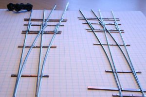

Here is a picture of 2 turnouts I build on top of a printed template.
The left is code 70 and the right is code 55. It really doesn't take much, order some ME rail from one of the online stores (unless you are lucky enough that your LHS carries it), order some PC ties from either FastTrack and CloverHouse, get yourself a NMRA gauge and a couple of ME 3 point gauges, and maybe a couple of roller gauges, a solder iron and a lot of patients, that is really all there is to it.

Wow. Those look really good Jesper. I'm curious as to how you make the points and is there some sort of hinge for the rails that move located up where the frog is? It looks like the points kind of stay in one position and need a mechnical throw either by hand or electric to hold it in the other position. Is that correct.
So I don't pester you is there an on-line source that I can use to read-up on this?
I have so many questions.
On those type of turnouts, you actually bend the rail to throw the switch. They work much better than commercial switches with hinged points because you get a single piece of rail all the way to the frog and you get a natural easement when you bend rail. Code 83 and smaller rail is light enough to bend very easily.

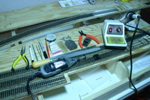

I took a picture of the tools I'm using. What I haven't bought yet is the roller gauges from railway engineering, I have some for N scale, and they are really helpful, but it is possible to build without.
attachment.php

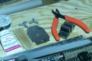

and a closeup of the 'jig', I think you can see the groove I was talking about.
attachment.php
Jesper

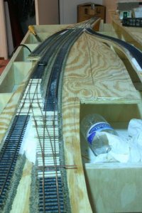

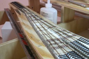

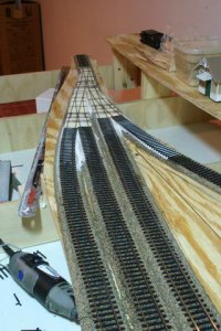

No to hi-jack your thread, but as promised, here are a couple of pictures of where I'm at.
I have uploaded larger versions to my webshot album
http://rides.webshots.com/album/118134441xkKyNt
edit: hmmm.. I don't know how to show the pictures without this extra link showing up. Anyways, here they are
attachment.php
attachment.php
attachment.php
