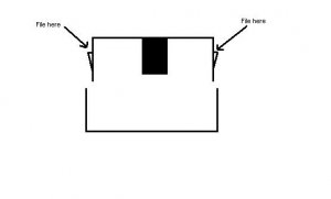

If they are the little metal covers that snap over, you can file the plastic part a little so that the metal cover snaps on more relably. (see the diagram - you want to file down the "top" of the little triangle that sticks out).

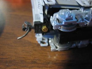

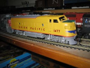

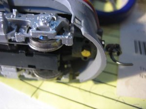

I find the plastic clip on the SuperWeight F7 is rather flimsy (wierd considering that the rest of the locomotive is built like a tank!). :D
I just said the hell with it and drilled and tapped 2-56 screw holes, and installed Kadee #47 underset couplers. It's a lot more solid and works A LOT better. :thumb:

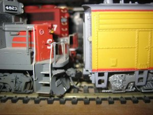

Added bonus: The stock couplers seemed too low and tend to catch on turnouts. The #47s raised the couplers to the proper height. PLUS, I drilled the holes a bit more inboard so the coupling is closer-- Using the stock couplers, there seems to be a scale 5 feet between the rear end of the loco and the car behind it. The fix decreased the gap to around 3 feet or so and looks lot better. (Photos below.)

I drill and tap all of the center posts on all of my Athearn cars and install a #2-56 screw to hold the coupler clips in place. Originally Irv made the clips out of spring steel. Then after his passing they were changed to mild steel and didn't hold their "spring". Putting in screws eliminated all problems with the clip falling off and the coupler falling out of the pocket.

Yes, just drill the metal tab on the frame with a #50 bit and tap for #2-56 screw. I put in the "tips & tricks" forum a while back a method I use to build my Kaddees so that I don't feel like I'm all thumbs trying to install them. I put the box & couplers together with a screw & nut. Then I use a little Testors liquid glue around the edges at the joint between the coupler box & lid. After the glue has set up, I remove the screw & nut, and it is ready to install as a coupler/draft gear box assembly. When you install the Kaddee couplers, you may find that they are too low. If you use a file to remove material from the bottom of the coupler mounting tab on the Athearn frame, you can raise the couplers up. The other alternative is to use the Kaddee couplers with the offset head where the coupler head is up in relation to the draw bar.

For the record, on that F7 I modified with the Kadee #47s in the above photos to get the closer coupling, it did not bump into the corners on the cars behind it on 18" curves. And that included 40-foot box cars and 85-foot Amtubes. :thumb:
As a matter of fact, the medium-length shank #47 still looks too long. I suspect I can swap in the short-shank #44 underset couplers and it might still work on 18"r curves.
