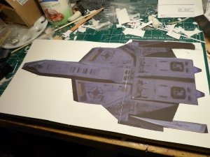

This is the full size print out I assembled of the top-down shot of the Excalibur. Nothing particularly fancy here. Took the top down image, up-scaled it until it was the size I wanted (about 16" in length), and then printed it out. Cut the parts out and glued them together to get one sheet. From this I'm able to take measurements, which I record in the collage in photoshop.

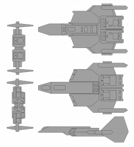

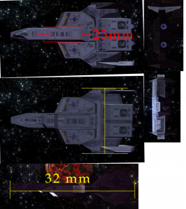

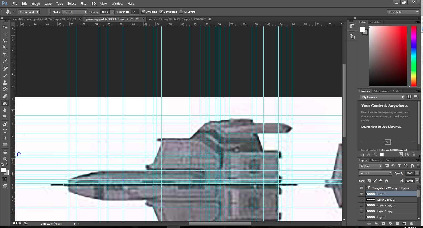

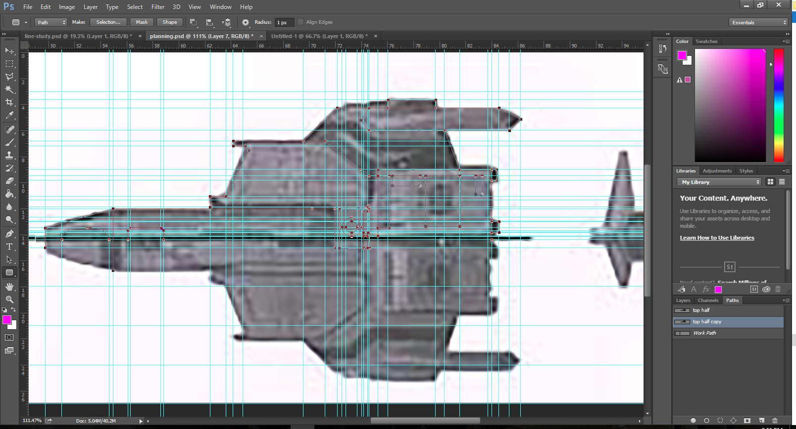

Beyond all of that I did start crunching some numbers for the model again based on the Warbird images. I've decided I'm going to scale back a bit for the project and rather then do a 16" long model, I'm going to do a 12" long model instead. I've done lots of small scratch build jobs before, but never a full blow from the ground up total scratch built model before. And I'm thinking about doing some lighting effects in the model as well. So the 12" version will be easier to manager and I think closer to my skill set at present. I want to challenge myself, not waste my energy and materials.
So, I took the warbirds image and pulled it into Photoshop where I upped the size by a factor of 6 so I have some room to work and make notes. The image is small enough that I will be forced to 'interpret' a lot of details, but that's what the reference library is for. With the image in Photoshop I started working out some numbers. I had to go way back to Algebra and Geometry to remember how to work with scales and conversions for this and I'm not totally sure my math is accurate. So if anyone who actually knows what they are feel see a mistake, please point it out.
Here is what I have:
Whiplash then provided some more information about scale calculations and such. A lot of it went over my head as to the practical use of it due to the size of the image itself. The printed image is 3/4" wide after all. But it did spark a thought in my mind.
I'll explain:

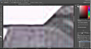

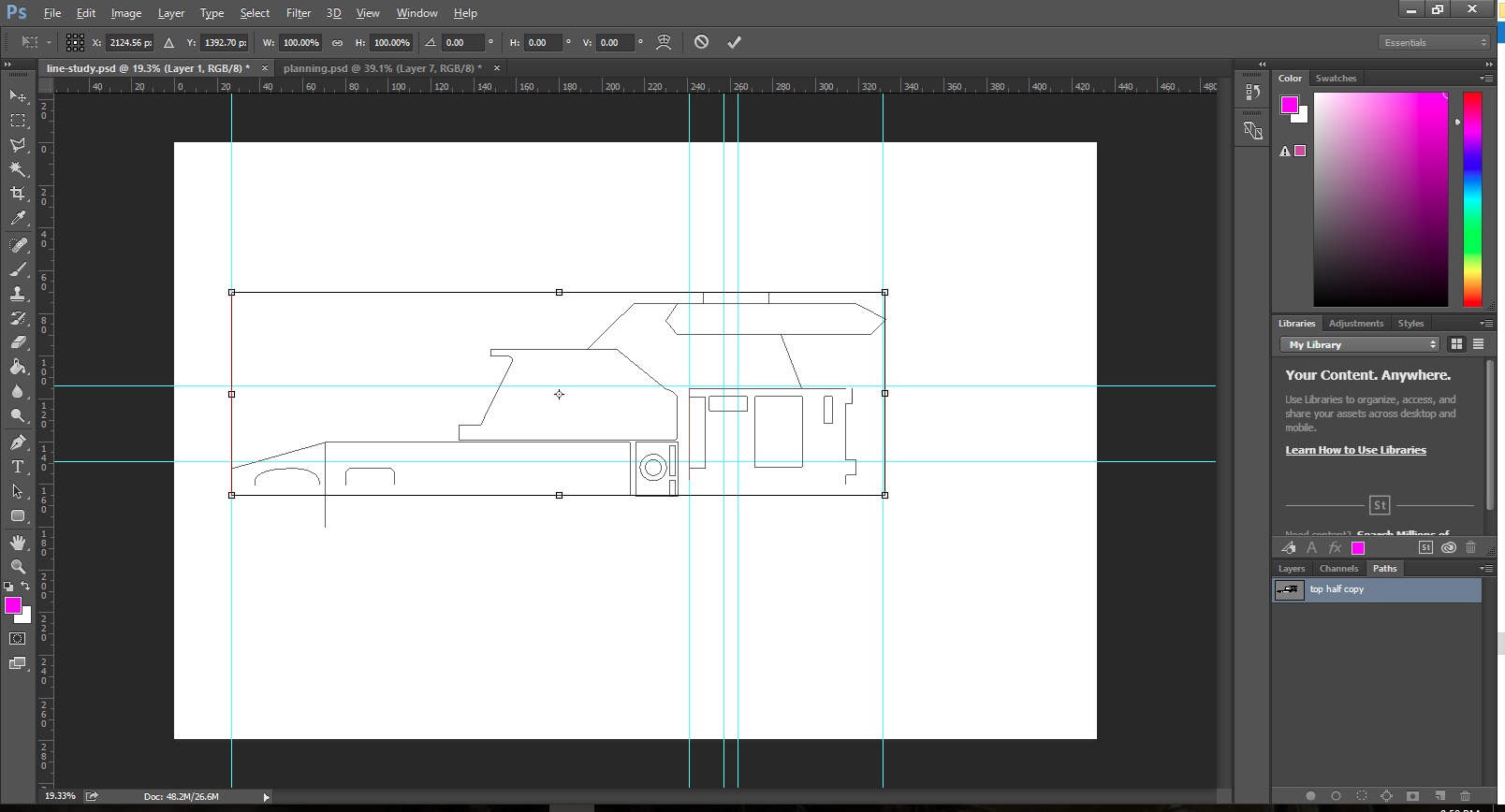

See in digital graphics you have 2 types of graphical engines each with their benefits and minuses to design. The first is known Raster graphics, or sometimes referred to has bit-map pictures. This format uses individual colors dots to render an image. The more dots you have in a given space the sharper the image can be. A line is simply a series of dots of comparable color. This format has the advantage of being capable of storing far more graphical information and being the foundation most directly based in traditional art work so many of the concepts from that medium translate to this format. The second type of graphic is known as Vector graphics. These use mathematics to form shapes rather then recording each individual position of every point contained in the image. This has the advantage of being vastly easier for a computer to deal with but doesn't translate from math to art very well.
Why am I bringing this up? Well, the two graphic types have another consideration between them, how well they scale up or down. See a bit-map can only be scaled by either adding or removing details. How the program add details will effect how well the image scales up, but generally you can only scale a bit-map image up about 50-60% before you start seeing a noticeable loss in sharpness as additional quasi-random extra material is added.

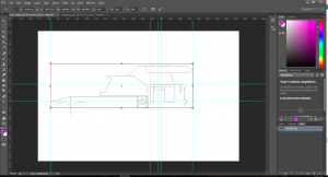

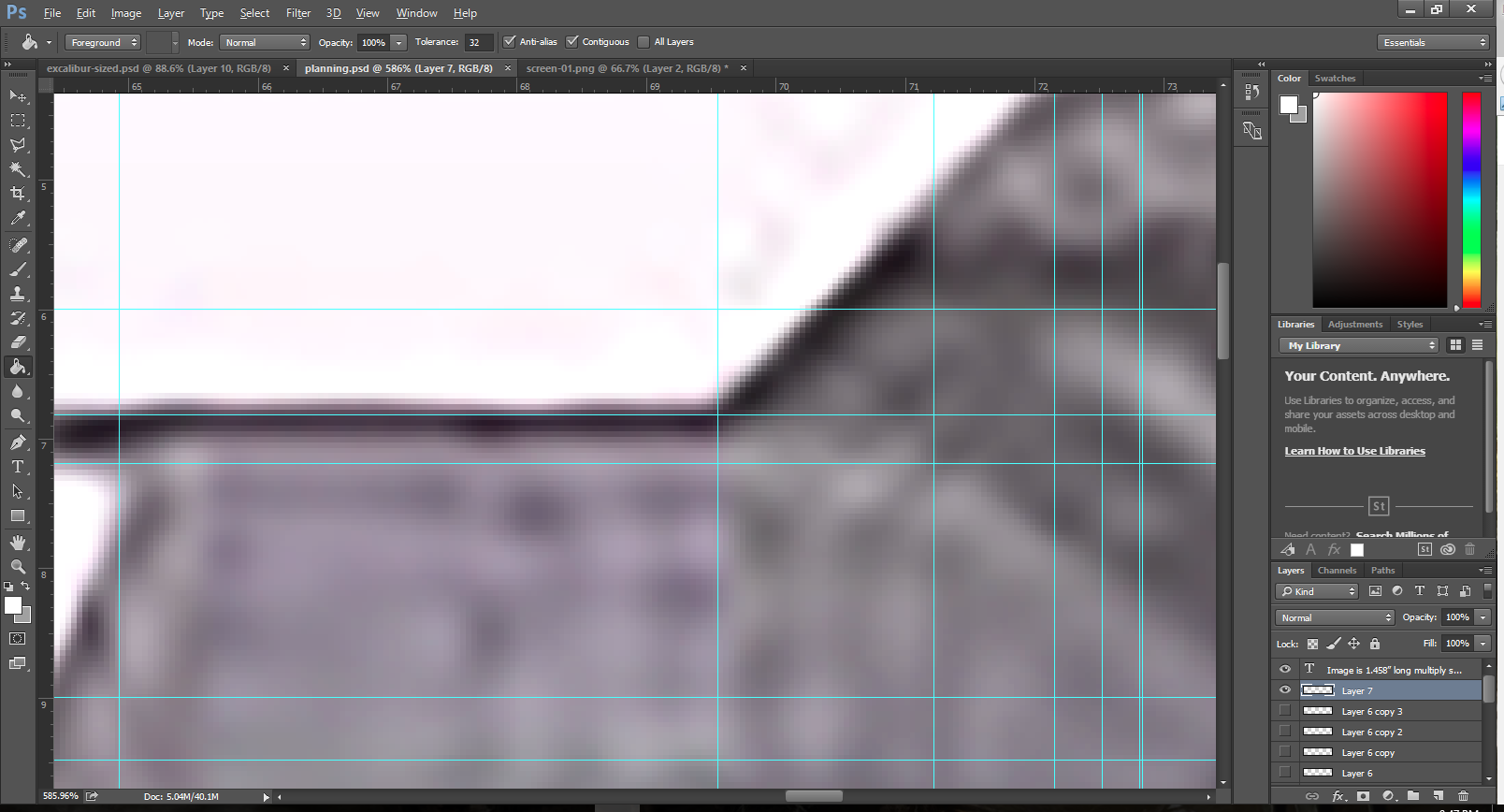

As an example, look at the corner on the right side of the Excalibur image where the forward section of the fuselage meets the side of the wing and side mounts. On the 1 1/2" sized image it's moderately decent.
screen-03-png.153735
But enlarge it about 400% (so that the over all image would be about 4.5" long for reference) and suddenly it stops looking anywhere near as sharp.
screen-04-png.153736
Vector Graphics however, because they are mathematically based can scale infinity. The program simply remaps the location and calculates what's between the points as needed.
So why did I just explain all of that? Well Whip gave me the idea to start with a series of vector graphics, based on the Warbirds images, then upscale those vectors to the size I need them. Since the vectors expand infinitely, there's no lose of detail in the process. I started with just tracing the major sections visible on the Warbirds image. I did some digging and found my hard copy of the Wing Commander 3 stuff and scanned the warbirds images at an obscenely high resolution of 2700 dpi then pulled that scan into photoshop (as an aside, it's always a challenge working with 5"x2" image that's a staggering 400megs :eek: in size) and went to work with the pen tool to generate the vector graphics. the high resolution pulled out some details, but the size of the original image simply doesn't have a lot of detail to start with.
screen-02-png.153734
Remember how I said enlarging a bit-map image is done by adding material? Well scanning a printed image at such a resolution results in basically the same thing. End result? I could trace out the body, the engines, and the cockpit. The rest... eh I kind of had to take some artistic license with those.

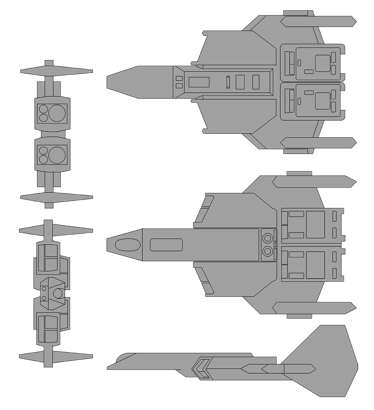

Remember that library of images I assembled of the Excalibur? Well I used that a lot in this process. I primarily referenced the "armada" rendering of the Excalibur for filling in the details that were lost in the up-scaling of the scan.

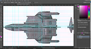

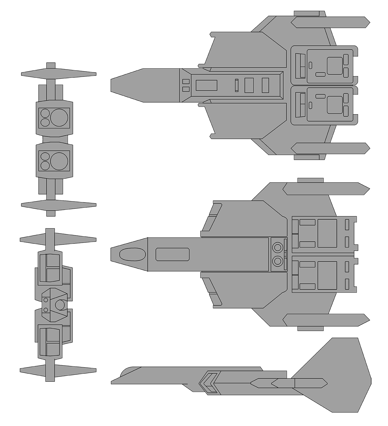

So after a couple hours worth of work, I assembled the following top-down image of the Excalibur with
(website friendly version displayed. If you want to grab the 300 DPI version it's linked here)
I mentioned that these are first passes, why is that? Well... it's because they don't match up exactly with each other. It's too late for me to go into all details but as an example. The widest part of the front boom where the cockpit is, it is widest on the front view, narrowest on the top view, and just slightly narrower in the bottom view.
So what does this mean? Well, it means I have to go back, pair up the line art pieces with each other and decide which part of which version I want to take as the 'correct' version. While the web version of the image above sizes out to be about 4" wide, I want to build a 12" model from these designs. So if I scale everything up by a factor of 3, and I have one part from the bottom that is 1mm wider, then the same part from the top view, but the rear version is 1mm to the left, I'll wind up with a part that started out as a rectangular cube but when built comes out as a lop-sided rhombus. So guess what I get to do over the next few days....

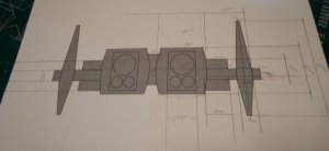

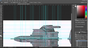

Well, this:
Lots of lines and measurements, still have lots of lines and measurements to go.

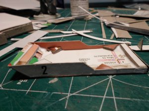

And this was the point where I encountered an incident and was grateful I had been working in cardboard rather then plastic.
Well...... ssssssshhhhhhhhhhhhhhhhhhhhhiiiiiiiiiiiiiiiiiiiiiiiiiitttttttttt! I have to start over on the mock up. I was gluing the bottom panel of the body in place. What I didn't realize was some glue had leaked out of the body and onto my work space. So when it dried it dried to my work space. I went to pick up the body, and in the process tore it apart.
Well this is why I started with cardboard. So I could make these sorts of screw ups and not have to pay through the nose for it.
Still, this sucks.

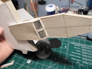

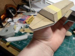

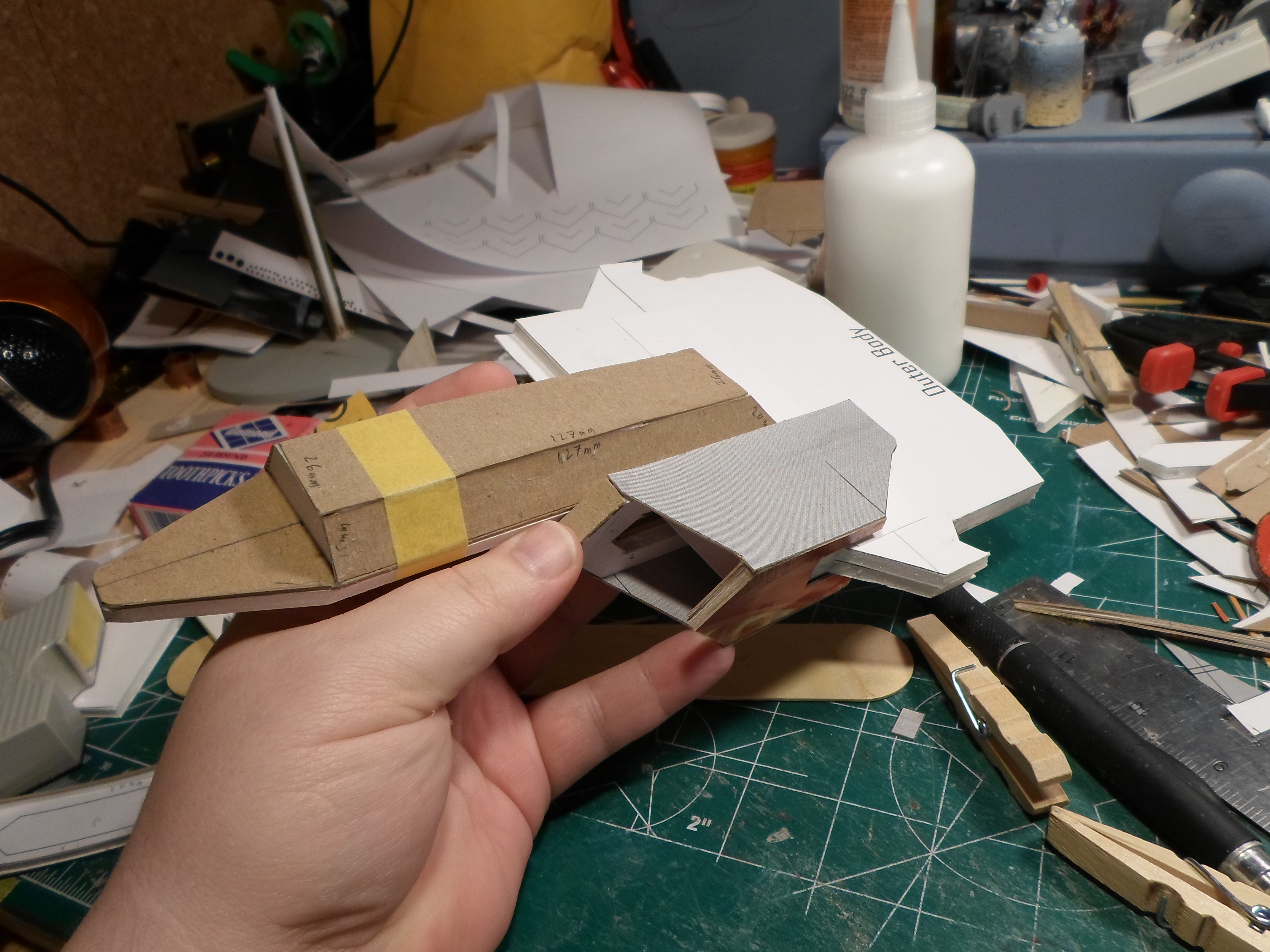

As I said last time, I'd had an accident while working on the Excalibur card board mock up which resulted in a destroyed model. It was a bit of a bitter-sweet kind of screw up since on the one hand, I had to start over on the mock up. But on the other hand I specifically chose to work in cardboard for this part of the project specifically so that if I had a screw up, it wasn't going to cost me $20 in materials. So... I guess it is like planning for a problem and having the problem occur. Yeah you're prepared and ready for it, but you still had a problem. So.. yeah.
Anyway I have been working on rebuilding the mock up and been making good progress. Having built it once already I can zip through a lot of it while also correcting some mistakes I made the first time around
Here you can see I'm built the mark 2 model up to the level of the previous version at the time it was destroyed. The main body is actually stronger then the first version and has cleaner joins between the various parts.
So that's it? I got back to where I was last week and now I'm done with this post?

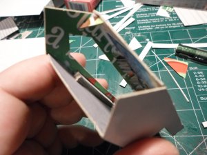

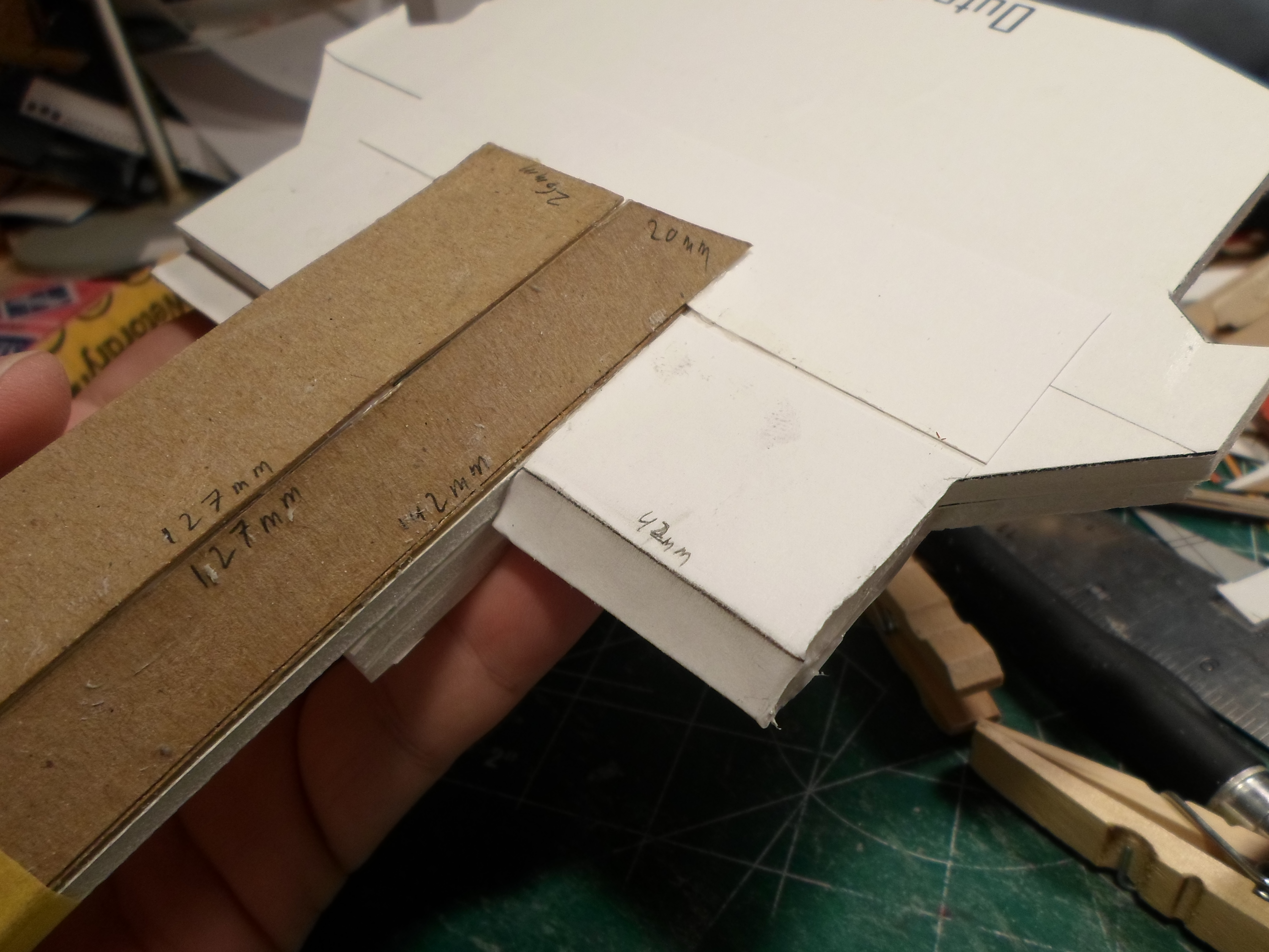

Yeah, not so much. I have started working on the next sections. Firstly there's the cannon mounting under-carriage, the part that holds the reaper cannons in Wing Commander 3.
You ever start to work on something and think it'll be super-easy and you can just zip right through it, but once you start working on it, you find out it's actually way more difficult then you thought it'd be? Well, that was this part in a nutshell. Cut 2 side parts so they line up with the under side of the body and the forward boom, what's so hard about that? Simple, I have no formal 3D design experience or training. So because of that I had to re-cut the sides a couple times after I found I had not measured properly.
For detail and variation I took a pencil and darkened the inner spaces of the under carriage where the reaper cannons would be placed.

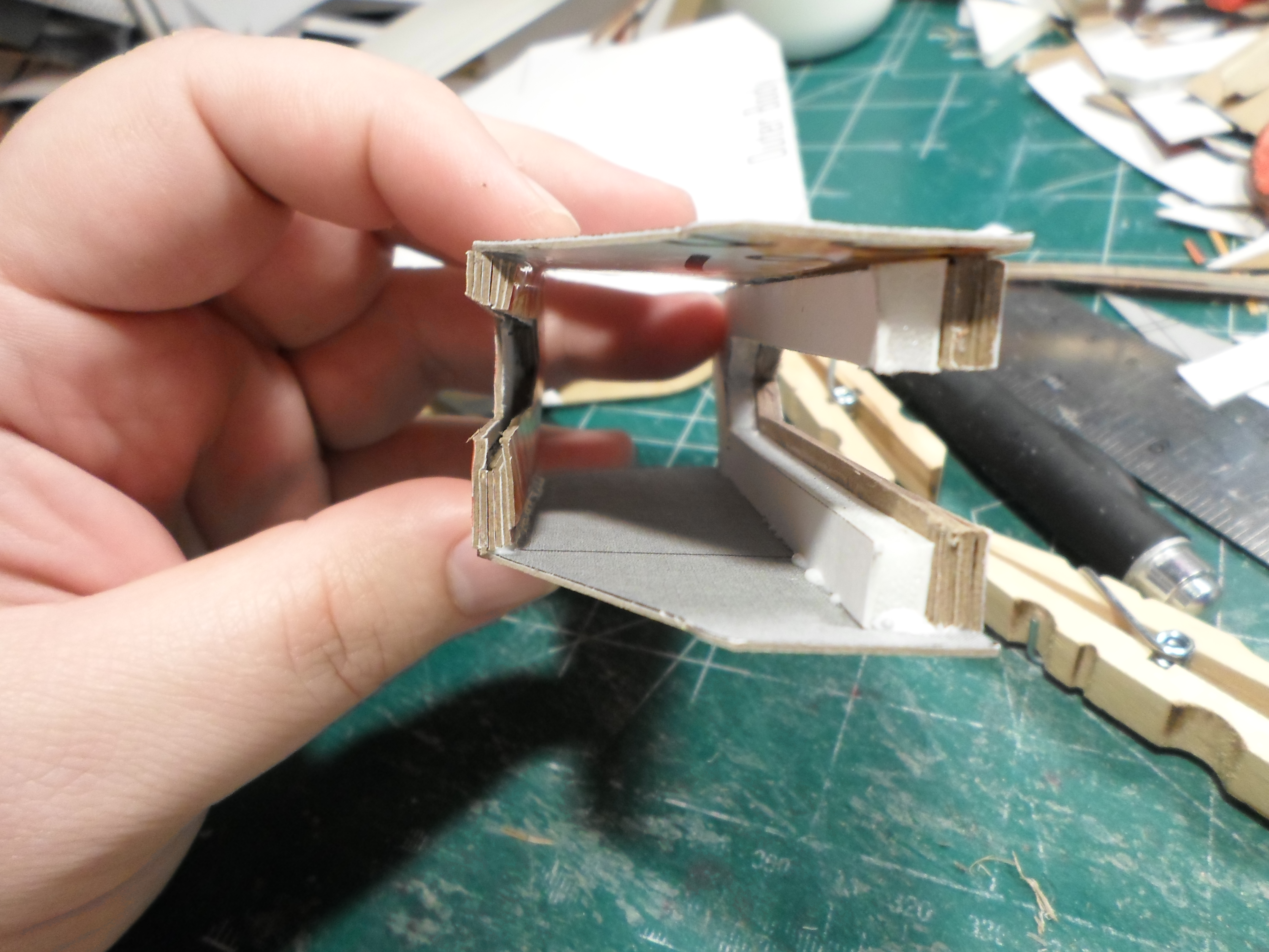

And then, there is the power-plants... er missile bays.... er... whatever the boxy shapes on the sides of the main body are. This proved to be more challenging then it first appears.

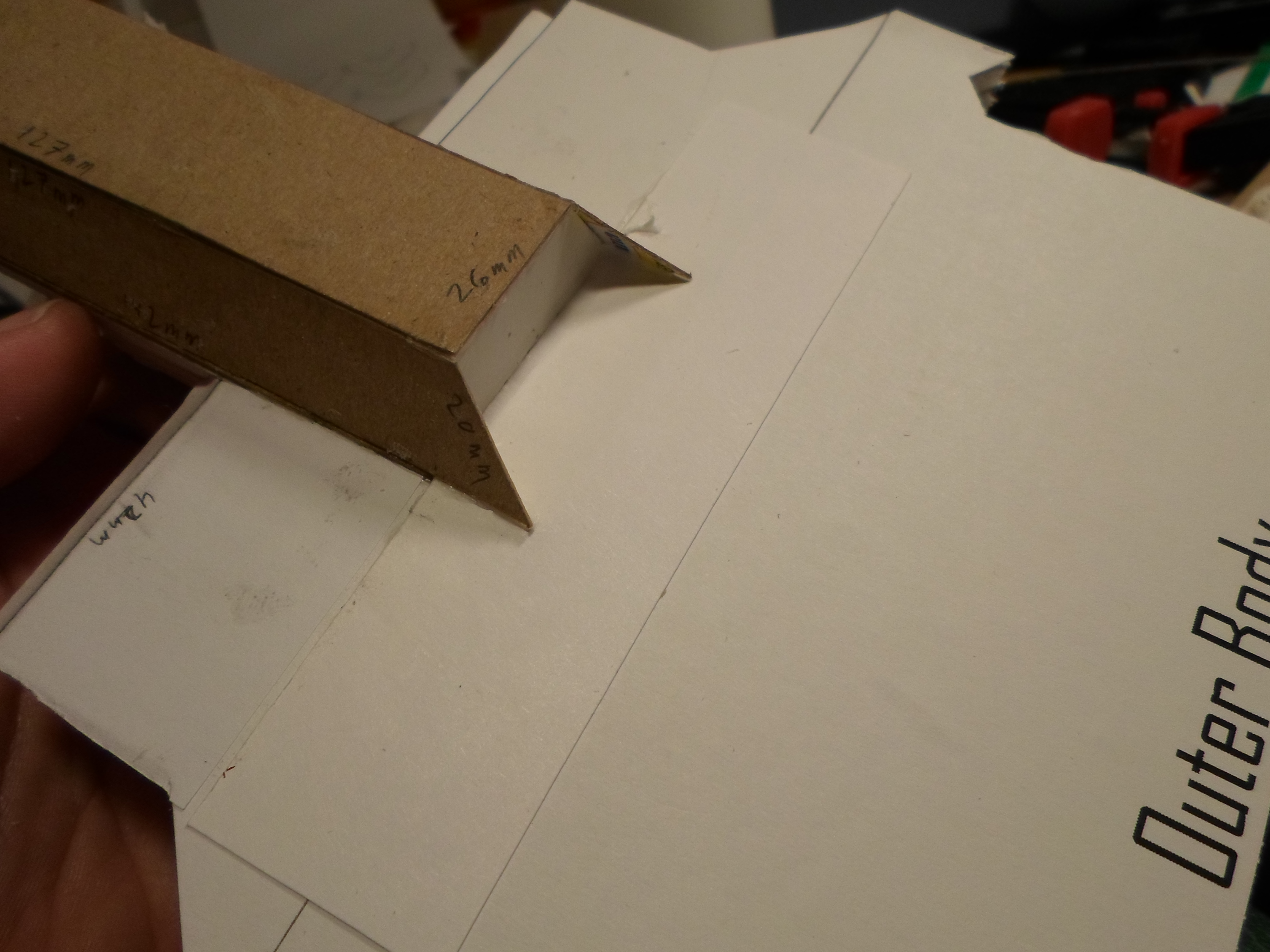

The initial shape was easy enough to accomplish, measure and cut the upper and lower sections as they appears in the line art. I had to do some interpretation to make the side and inner-section. There's little enough I can say about the sides that would really help any aspiring crafters. I had to estimate my measurements, cut a piece and test it. Find out I was wrong, and try to correct it with a new version.
No the real challenge was the scoop intake covers. See, it's an angle that extends in 2 dimensions, backwards relative to the body, and outward relative of the body. It's something that isn't immediately apparent from the 2D line art. So I had to cut and fit the ram scoop cover about 6 times before I got a sizing that fits.
And this is where I encountered my latest little... challenge to this project: I lost the gen 2 mock up. I put it in a storage box with all the other parts and pieces I had cut, sealed it... and now the storage box is gone. So... yeah. Have to start over on the mock up... again!

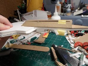

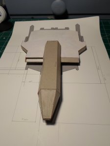

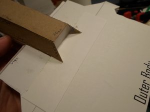

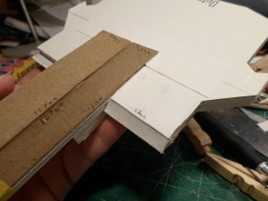

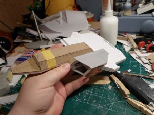

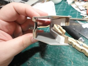

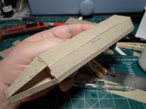

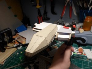

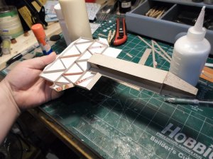

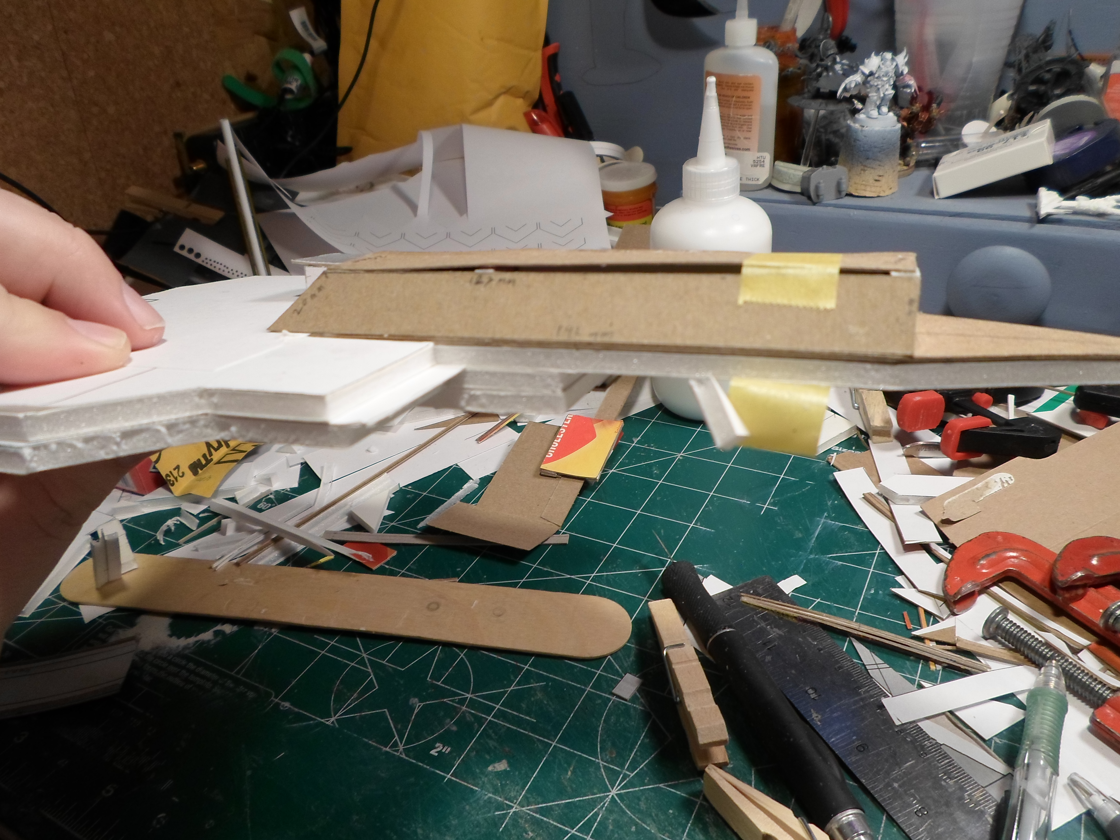

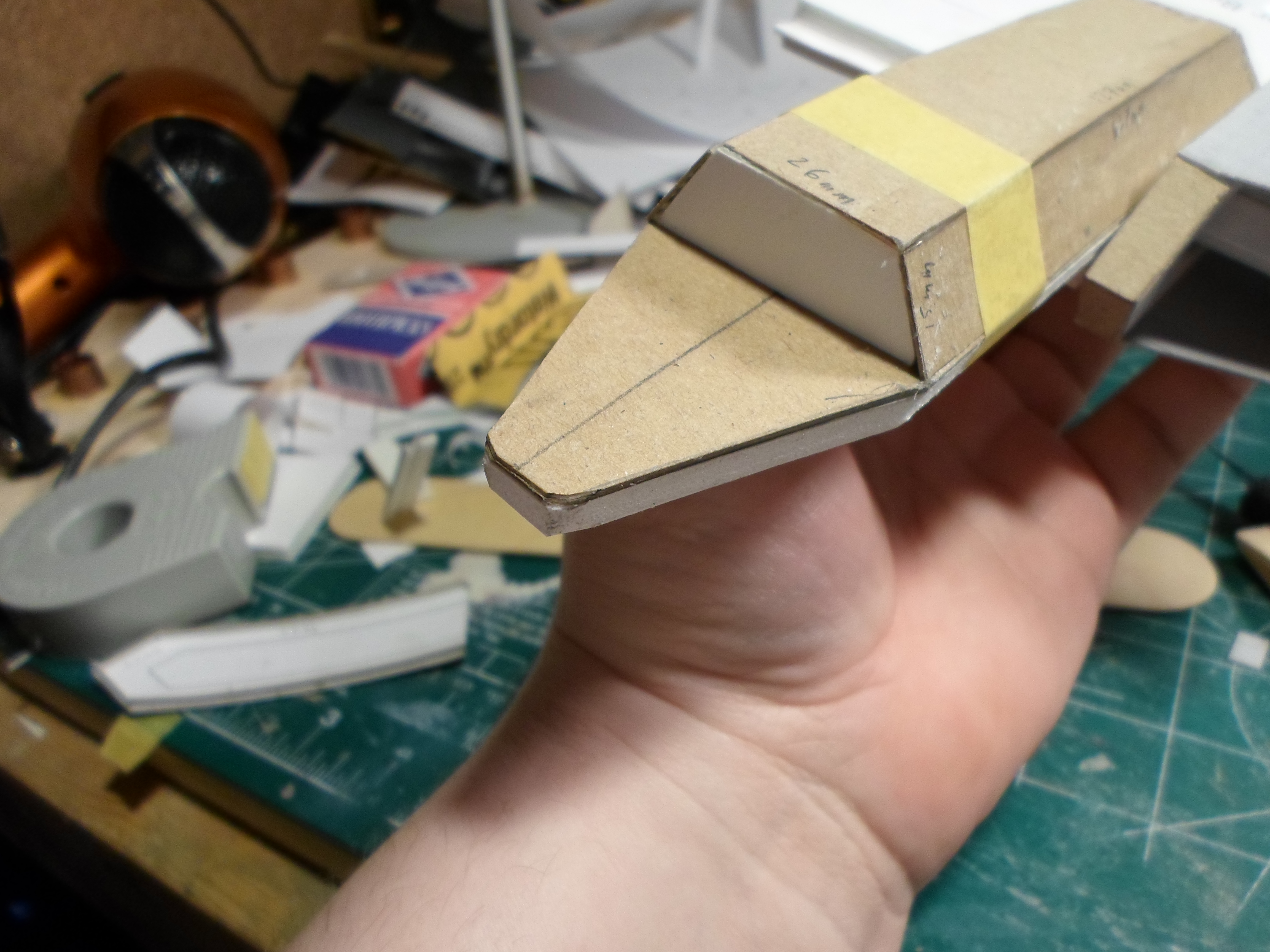

Here is the version 3.0 mock up as it stands at the completion of my live stream tonight. Starting from 0 and ending with this after only 6 hours... I'll call that a win.
Using foam board for the main body helped to speed things up a lot.
Previously the mock ups had had sharp apexes at the sides of the cockpit. With foam board in there I could found them out a bit more like how the in-universe images appear. The points will be there after I build the cockpit simply because it's kind of difficult to round out cardboard. Regardless when I get to the styrene version, I'll be able to round out the corners.
I'm recording a lot of measurements directly on the mock up once again.
