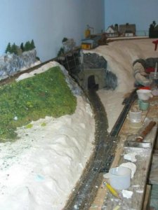

For my self, like previous posters I carve both the beaded and the extruded styrofoam to build up my hills and slopes. ( caution if using the beaded foam) use a very sharp knife to shape it nice clean cuts or you'll have little beads all over the place. The extruded foam you can shape it with various tools. In most cases when building a hill I just cut out the base, glue it to the bench work, cut another piece and glue it to the piece previously laid. You can use tooth picks bamboo skewers, whatever to keep the pieces aligned while the glue dries. Lay your plaster cloths, towels, over the structure and you have your hill.
The lumps or bumps on the ridge are just scrap pieces of styrofoam shaped a bit and plaster cloth over them.
Cheers Willis
