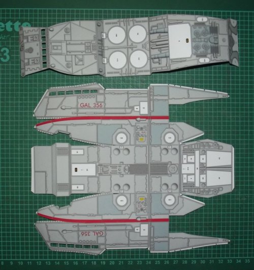

Now then. Let's take a look at what we have.

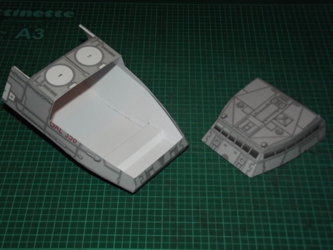

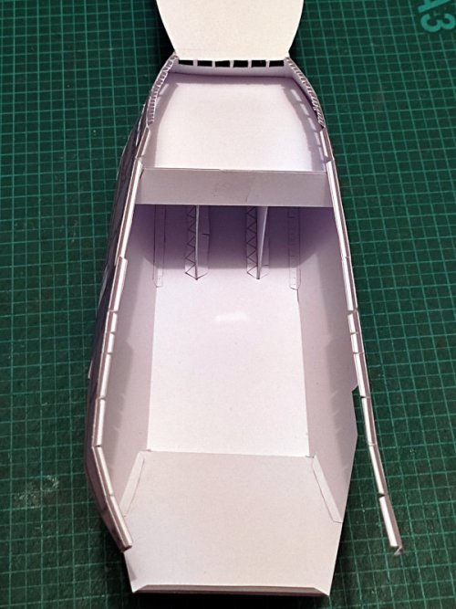

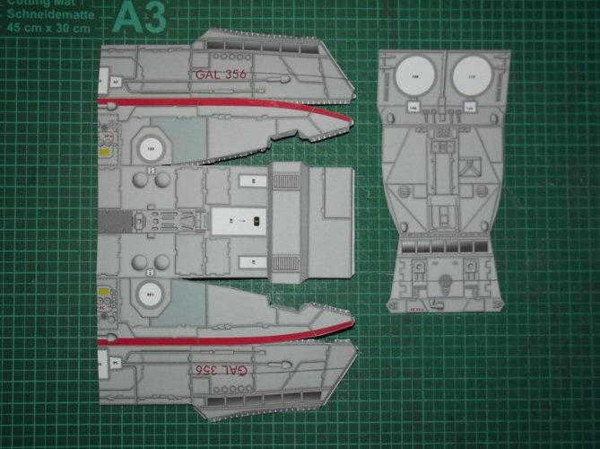

One main hull was needed to test the parts. The windows were cut out. Again, I could have left them in (IF I wanted) but in this case, ... no. :biggrin:

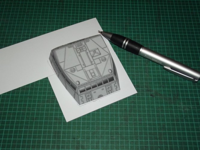

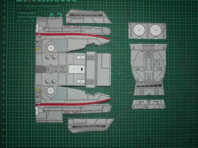

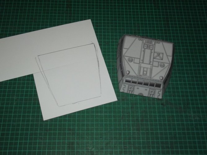

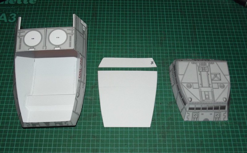

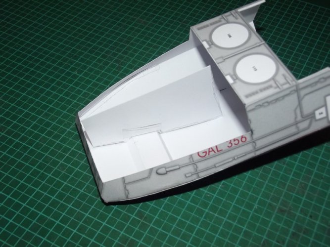

Since I do not have access to the original CG model another part of the main hull was needed to determine the shape of the new floor.

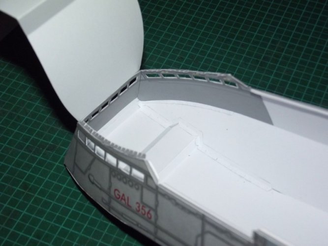

As a start I cut the template to pieces where I wanted the floor to be.

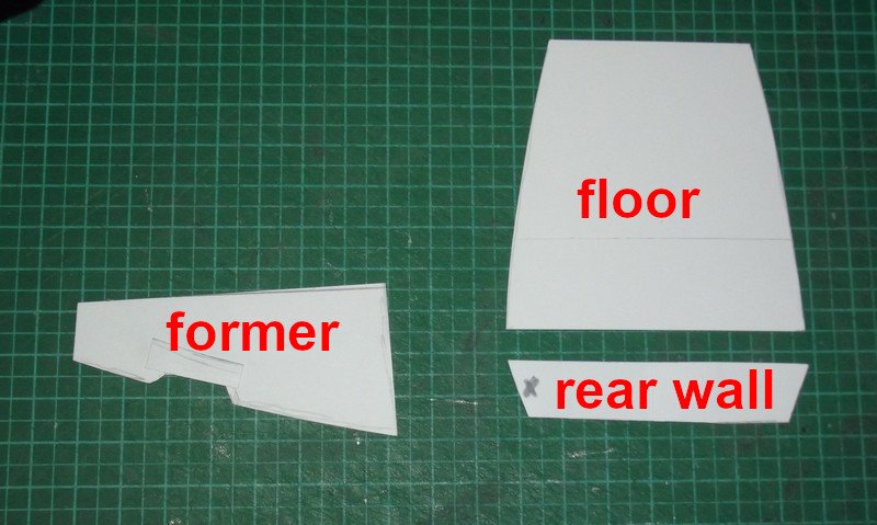

Old-school pencil technique and lots of trial and error was involved to get a first floor shape.

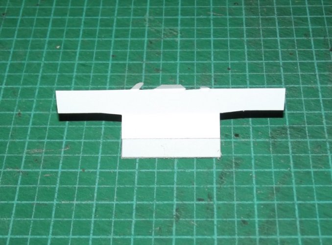

The shape of the back wall was determined.

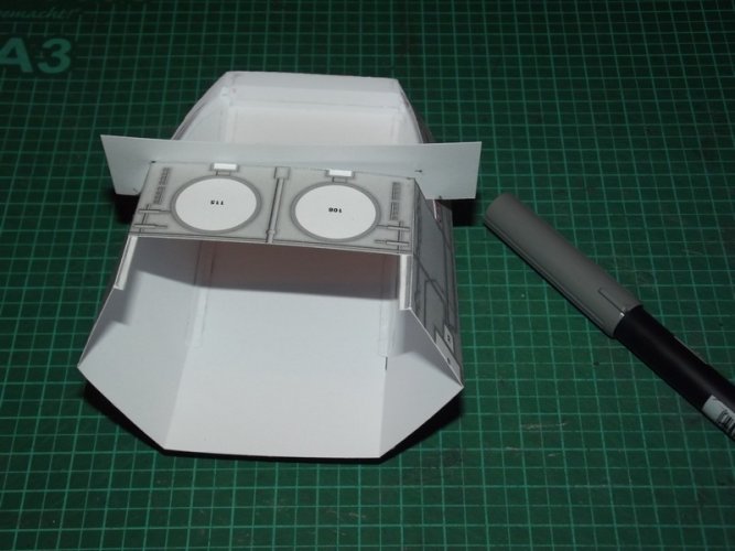

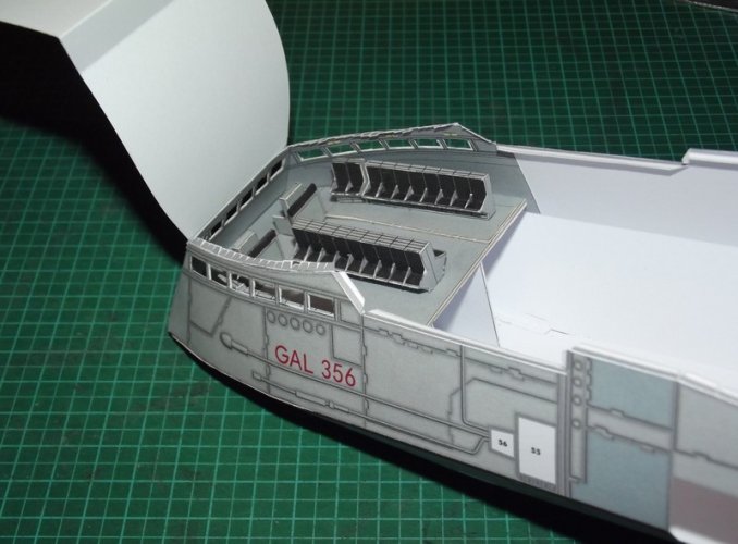

Later I found out that the back wall was no longer needed but for the time being it became very handy to hold the floor in position. Benoit and I were independantly struggling with the curvature of the sides. Replicating the exact shape was essential and any deviation would result in visible stress marks on the outer hull. So I came up with another strategy. Since the instrument panels will conceal much of the inner curve it was not necessary at all to follow the curvature precisely. I only needed a shape to hold the floor in place and the only reference point to do that (and which luckily was relatively straight) was the lower fuselage.

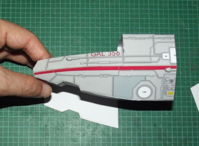

I kept the shuttle nose as parallel to the paper as possible and traced the shadow it cast. The first test fit was promising:

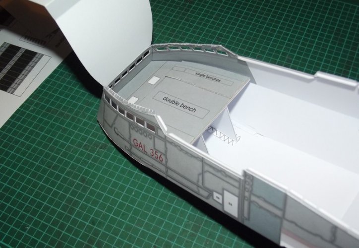

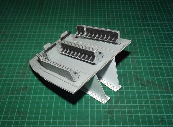

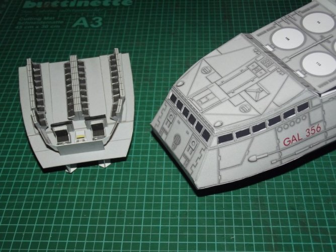

It fit! Some minor cuts later I had all I needed:

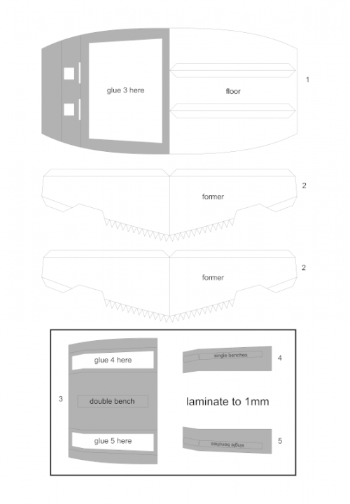

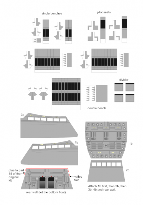

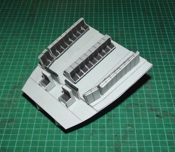

The parts were scanned and traced in Corel. Three prints and mods later I got THIS:
Not too bad for a start! :)
Then began the tedious work: The graphics. I worked off and on on it whenever time and mood allowed. However, with Benoit waiting for the plans I got very motivated and continued working on it - until my hand began to ache. That was the sign to "sign off" temporarily and I stayed off the pattern for two days. :)
As with all scifi related things the model interior and the interior of the studio set do not line up perfectly, so there is some creative licensing at work here. Most notably the square plates with the "bumps" on them were attached to the walls above the windows, here they are on the ceiling.

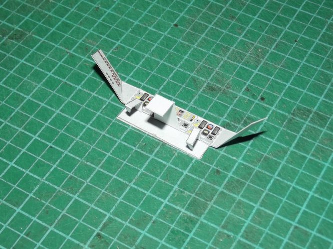

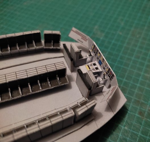

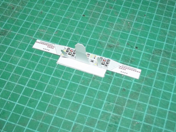

The only thing that was missing was the main console. :)

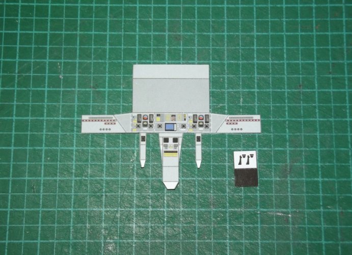

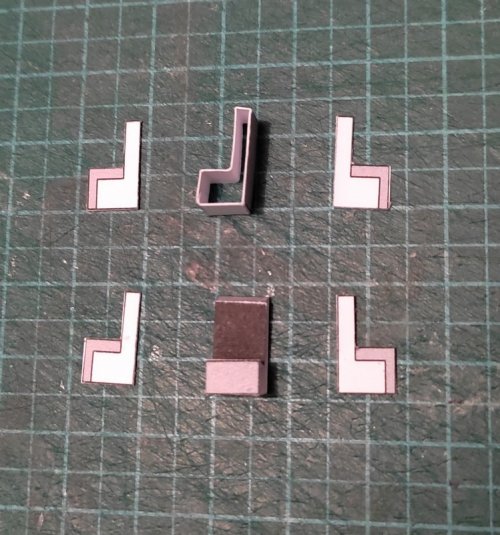

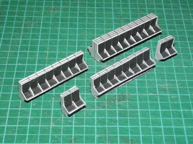

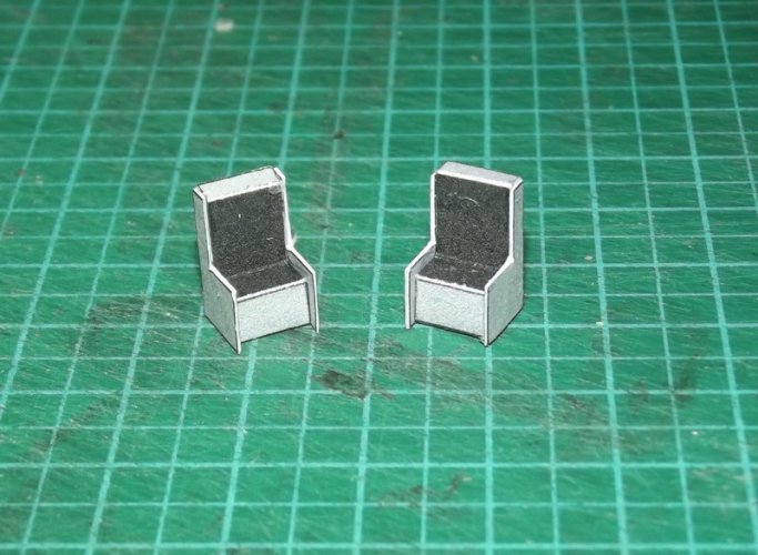

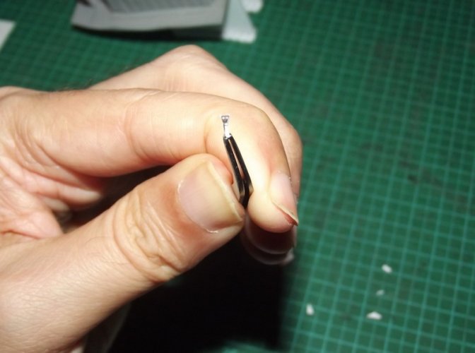

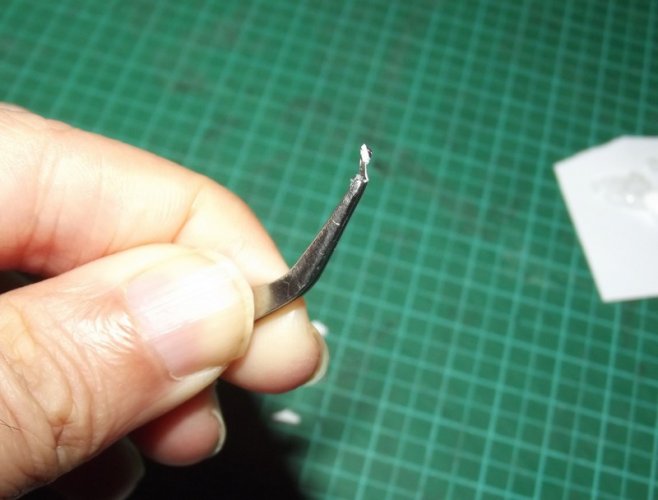

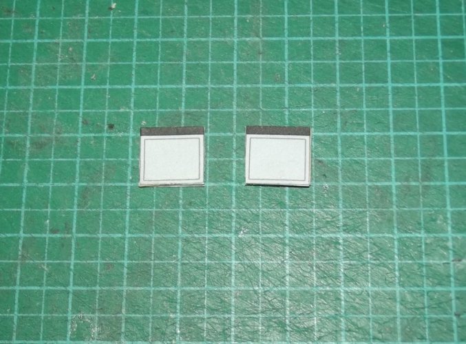

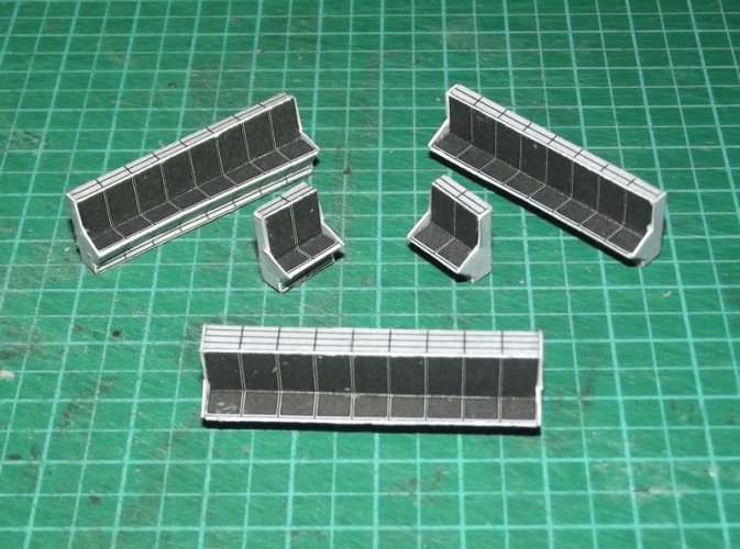

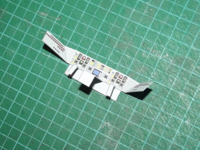

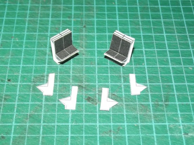

Now comes your daily dose of self torture:
What you see here is one of the two joysticks. In 1/120 scale. And yes, it has three buttons! :)
Number 2.
If I had been unable to assemble them they would have gone. But since I was successful, they are going to stay. No magnifying glasses or shrink ray tools were used. ;)

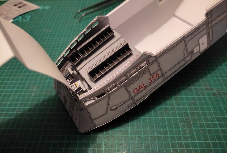

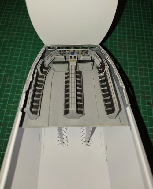

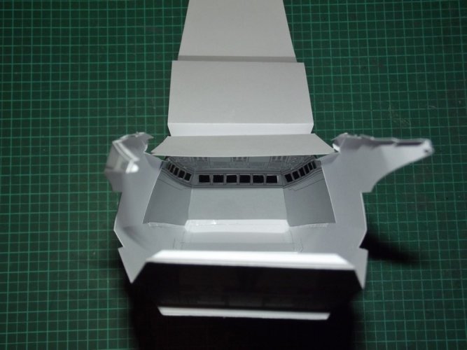

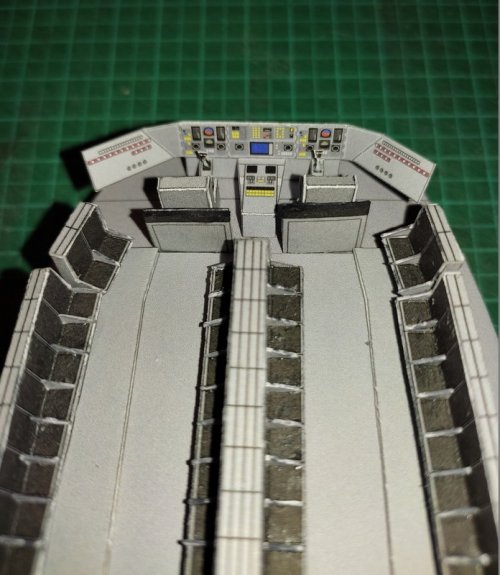

Test fit:

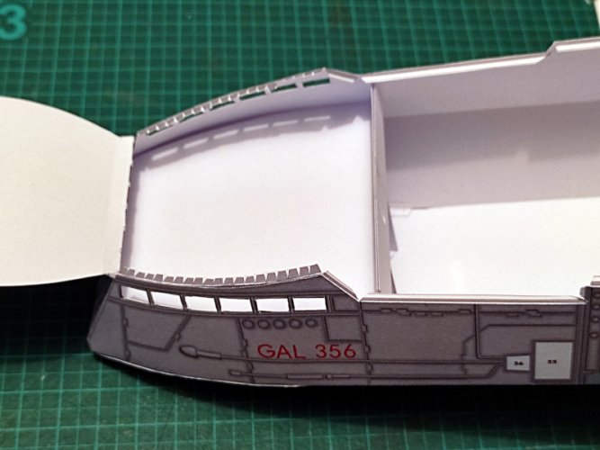

The interior was removed to install the ceiling texture:
The ceiling was closed.

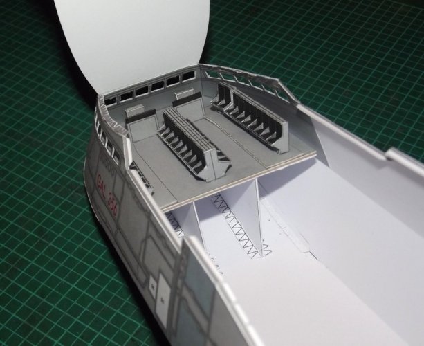

The interior was put into place and fit like a glove! :)
Since the windows are so small I'm unable to show you any pictures of it now. I'll have to figure out a way to show it to you. Ah well. :)

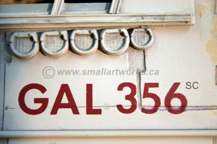

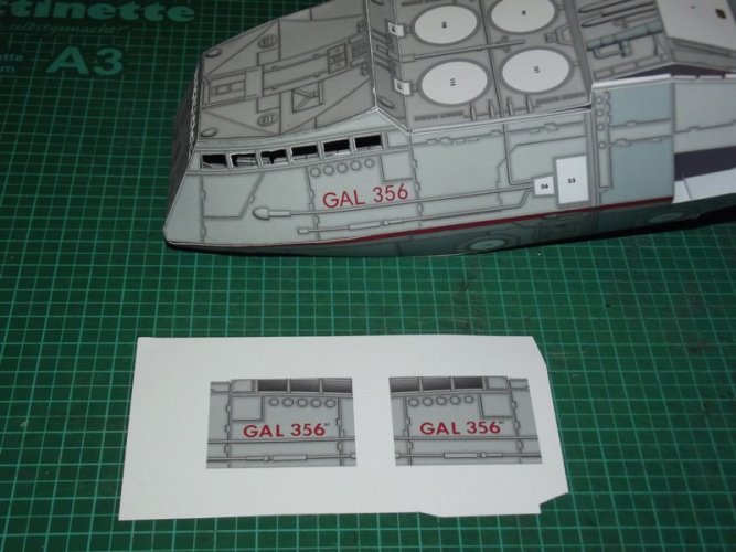

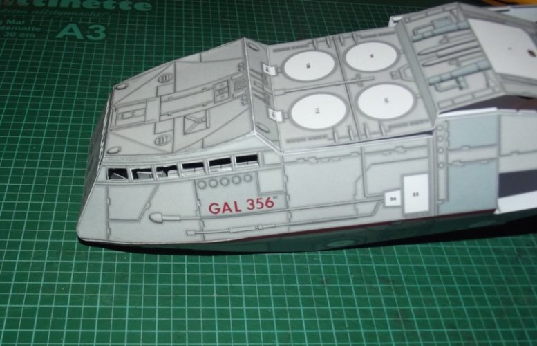

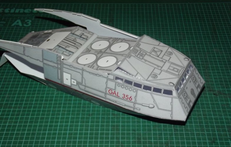

With the main aim complete I decided to tackle a crucial detail which was bothering me since the release of the kit. The studio miniature features a very distinct name plate. It is as prominent as the GALACTICA name plate and every deviation from the original is immediately recognizable. The font used on the shuttle miniature is the same used on the Battlestars (Futura demibold). This font is not freely available and is part of commercial software packages. So everyone who does not have this font has to come up with a solution to solve the problem. One way is to use a different but similar font. Martin chose that way in the spirit of many other Battlestar and GAL356 builders. However, the other solution would be re-building the name tag from scratch. Fortunately James E. Small released a straight-on view of the name tag:
which allowed me to trace and transplant it onto the kit. Before:
And after:
What a difference! :D I had to replace my ink cartridges which caused a slight shift in tone but now we have a proper GAL356 on the ship! :)
