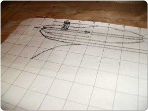

Ok I want to build an engine terminal. I have some plans however I have seen how this goes on here before and thought it would be interesting to see what others came up with.
The module is 3' X 9'
Will have a 90' tunrtable and an enginehouse and/or round house
Diesel age modern however I want to throw in a historical society steamer in there so my coal tower will work in it.
All my switches will be powered by servo (Its burning a hole in my bench :mrgreen:) and if the switches could be limited to around 4 or 6 that would be great.
Thank you for anyone that takes the time to help.

I need a little assistance with wiring. If i am going to install the module like this how and where should i gap the tracks.
DCC
