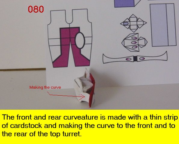

Thanks for looking in and for the comments guys. There are a few more techniques to come this way but be patient, they are almost here.

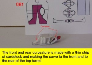

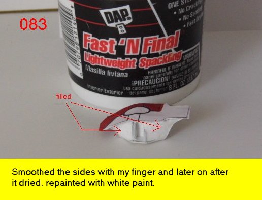

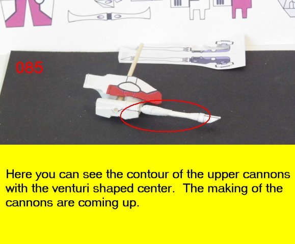

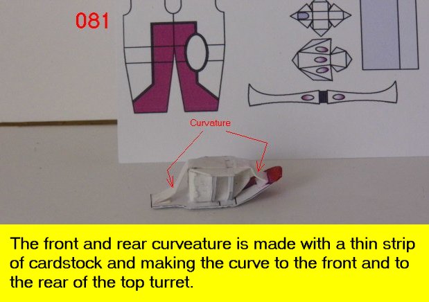

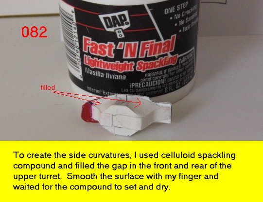

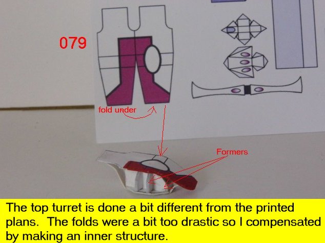

So here we have the making of the turret. Here I used the spacklling compound. This one depicted, is a celluloid base. There is another spackling compound but it is a putty base and stays soft. The sides will be placed on later in the build since I have to drill a hole and if the side was up, it could get damaged. The next posting will cover how the turret twin cannons are construted. Enjoy and see you all next posting.:wave:

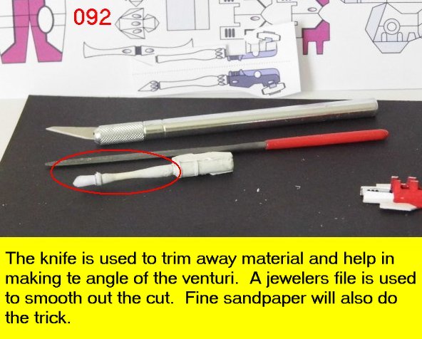

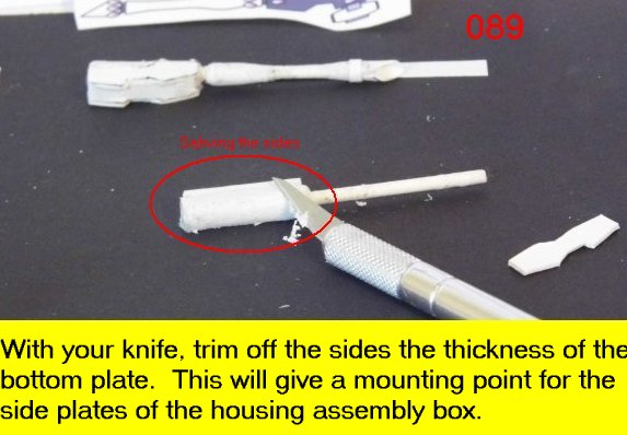

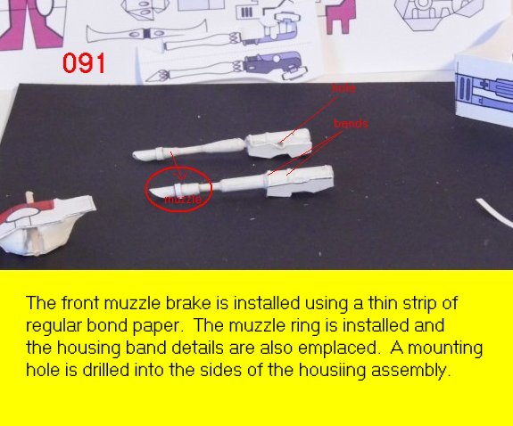

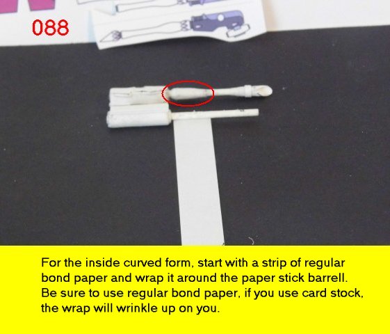

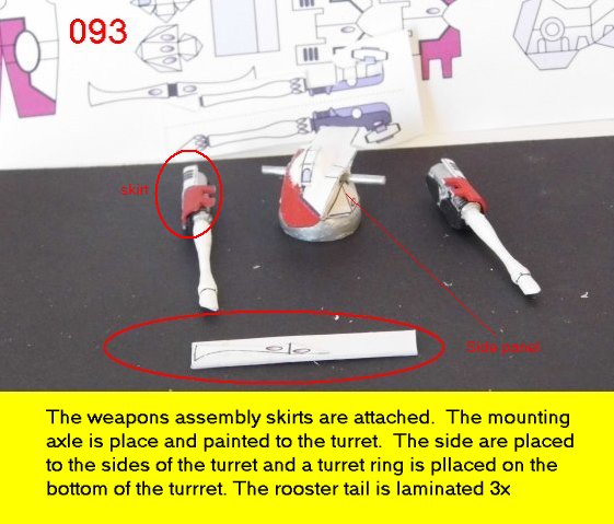

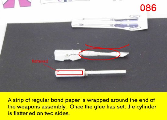

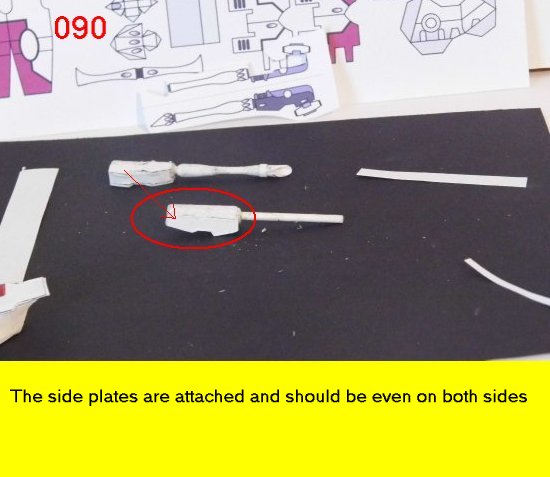

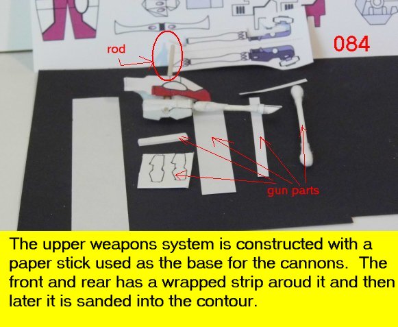

And now for more techniques and modeling tricks. The main housing of the cannons and the barrels are made by using regular bond paper. If you use heavier weight paper, it will tend to wrinkle and split. Be sure to glue all of the surface of the paper strip. If you use the glue sparingly, there will be dry spots and when you sand or file the part, it will rip apart at that point. It will tend to be messy, so keep a paper towel or rag handy to keep your finger glue free. If you do not keep your fingers clean, the excess glue will attach to the surface of the model and create smudges. Enjoy and see you all next posting.:thumb:

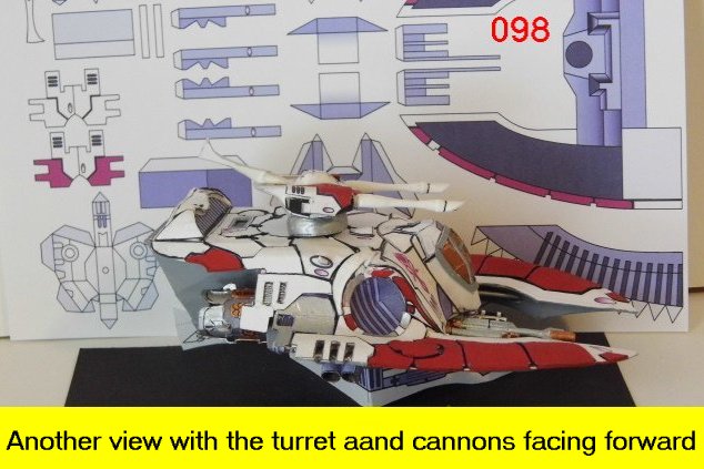

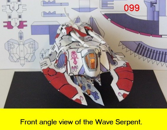

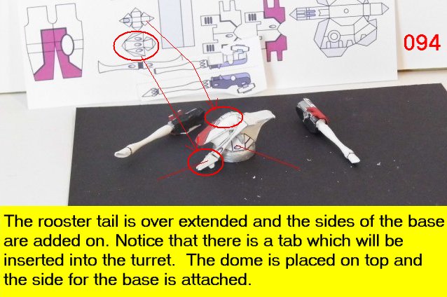

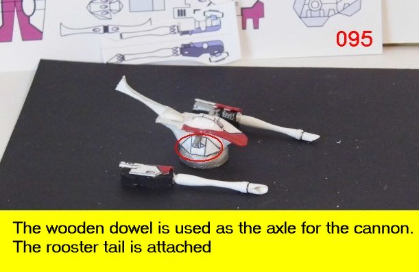

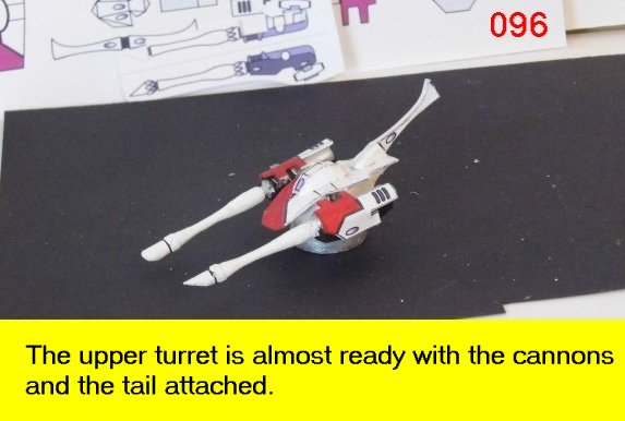

Here are some photos of the turret build. The eldar wave serpent by all accounts is finished at this junture but it needs more details. The plans do not call for a stand so that will be coming up shortly and the details for making the runes. Until then, see you all next posting.:thumb:

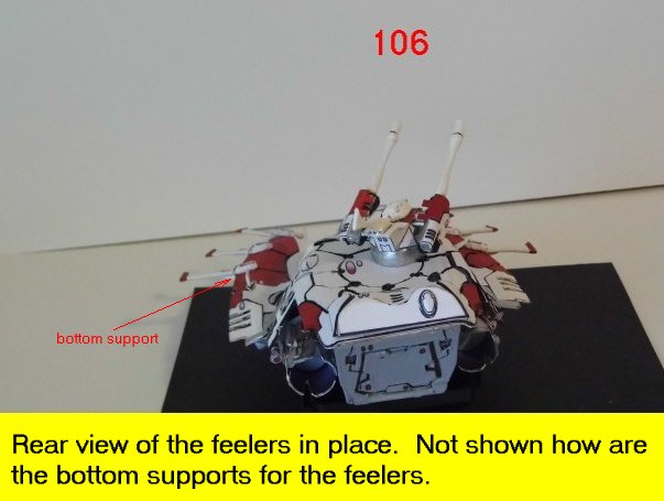

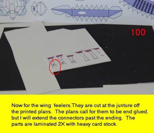

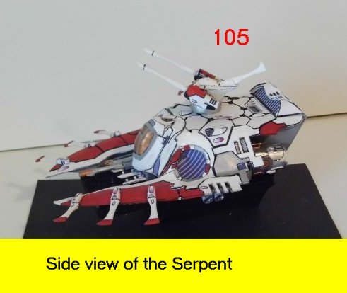

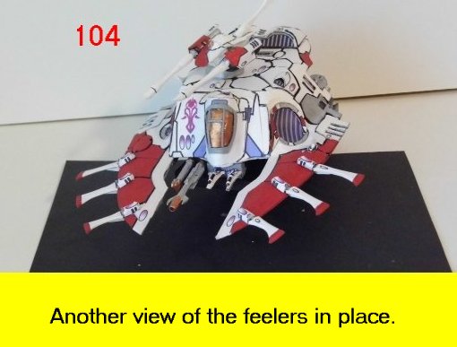

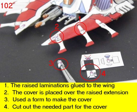

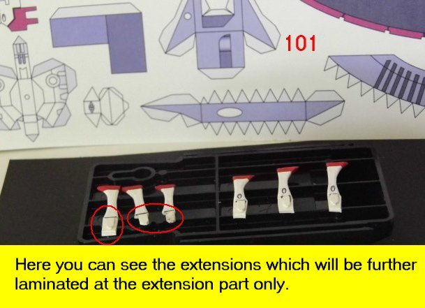

This is the section where I build the feelers. The plans have them being glued at the end tip, but I went and cut them of and made an extension for the ends. This part was laminated into a raised end at the glue point. it will help to hold the cover in place when it is placed on the wing connection point. The cover also was forced into a cup shape by using the tweezer point but a small rounded dowel or paint brush end could be used. I forgot to show the bottom support bracket but it helped in shaping the position for the feelers so that they will not droop.
Next on the build, will be a custom stand and finally the making of the runes.:thumb:

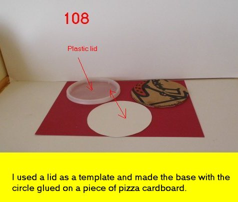

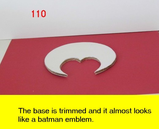

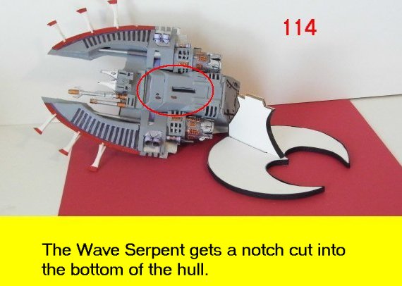

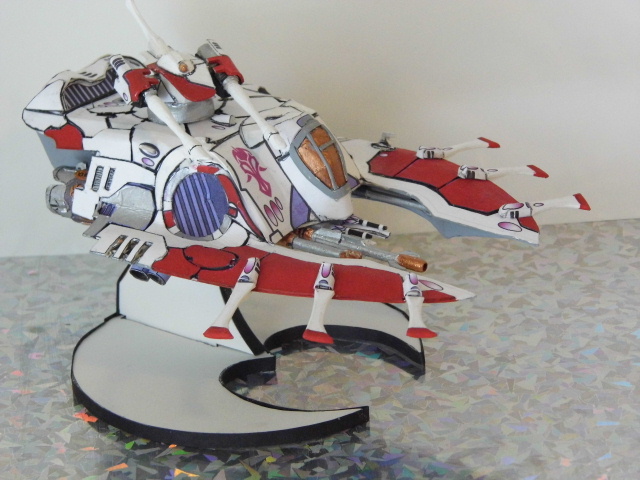

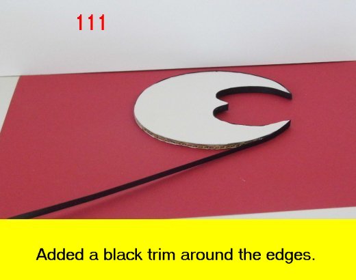

Here is the part on the base construction. Enjoy and see you all with the next posting on the making of the runes. The photos are slightly off sequence but they are numbered.

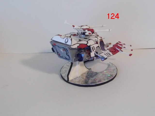

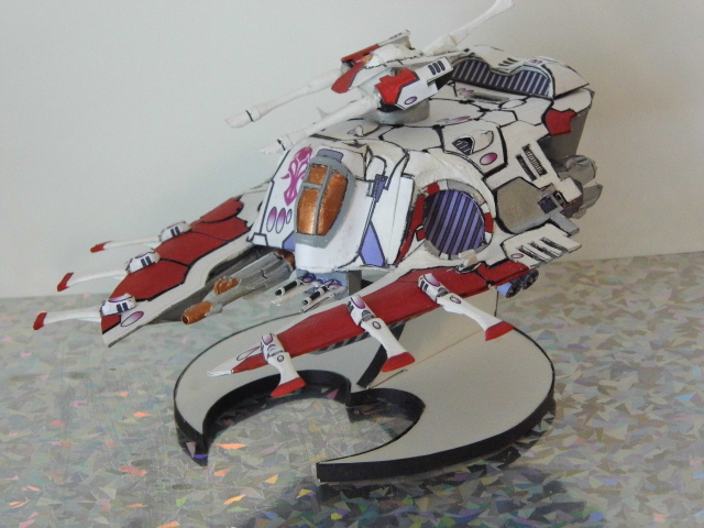

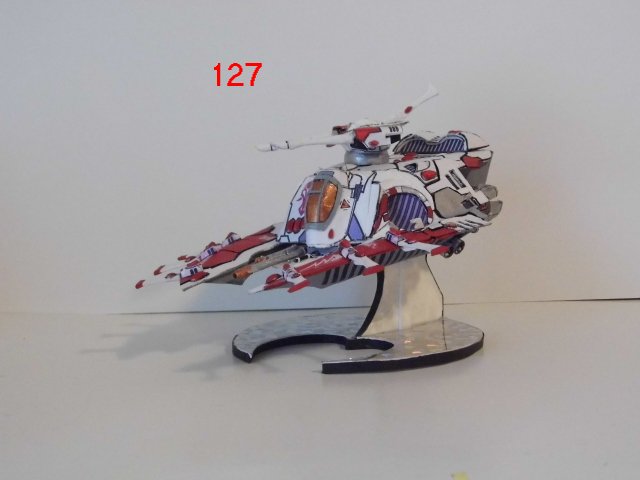

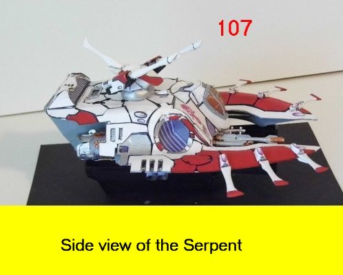

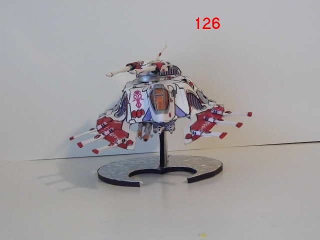

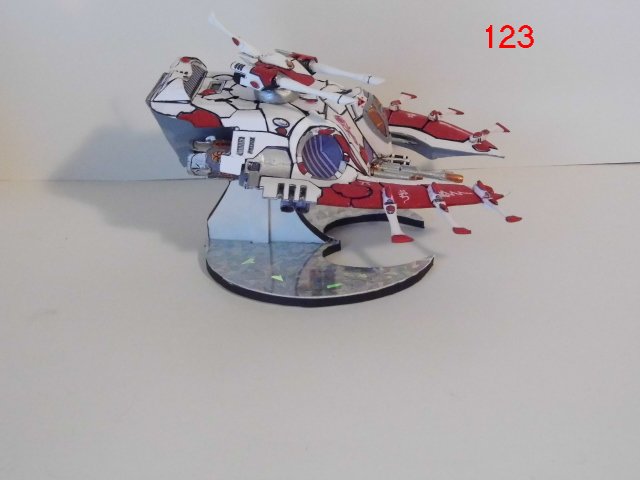

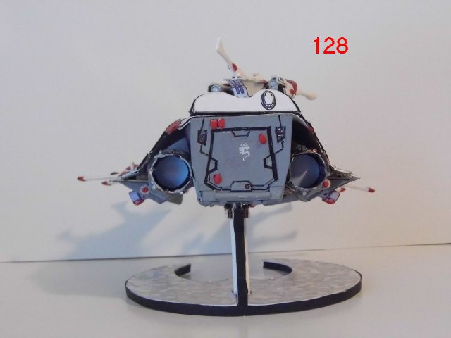

And now, the final sequence in the build thread. I hope that you have all enjoyed my build thread as much as I did in making it. If just one person learned something from my works, then it was well worth the effort. The next model is already in the works but I will not post until I am almost half way done with it. So until the next posting, enjoy and see you all around the forum.:wave::wave::wave:
