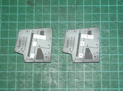

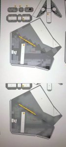

However, I encountered a tricky problem. Julius must have added a blur filter layer which could not be opened by InkScape. The texture became jagged and did not look very good. Hence I used PDFill to turn the pages into *.jpgs - with the same result! I tried Gimp and it worked finally. If you look at this picture you can cleary see what happened:
The first print is the one with the jagged texture, the second is the smooth one created with Gimp. Of course I'll be using the latter one. ;)

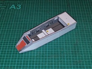

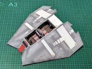

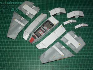

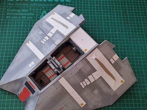

The side pieces must be flush with the bottom of the fuselage. Otherwise the wings will not fit.

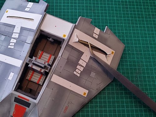

The wings are made of two pieces. There is a small gap between the halves which will be addressed later when I'm refining the bottom.
Thank you! :)

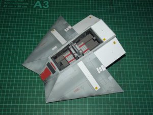

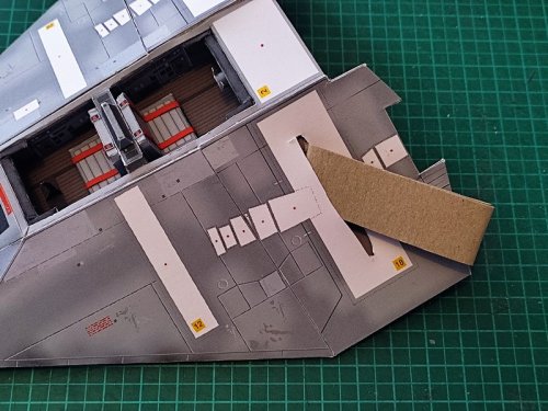

This is the first mod of the kit. I knew I should have reinforced the wings during assembly but I wanted to see how stable they are. Well, the front half is OK but the back half tends to bow in the middle. I cut a hole into the part and pushed some card inside. It fitted well and made the wing piece really strong. :)

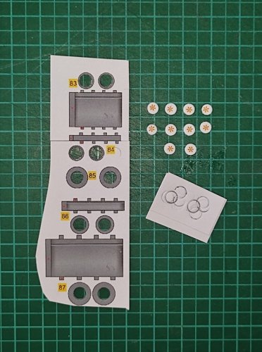

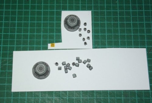

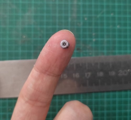

Next I assembled the parts for the cannons. You have to cut out several holes. These are very small, so I used a holepunch. This is the result:
Nice and clean. And YES, I used a HOLEPUNCH! There was no magic in effect but a small trick which I will not tell you. :Grin:
OK, I WILL tell you, but not here. I'm preparing a small and dirty thread in the tutorial section, so stay tuned! :)

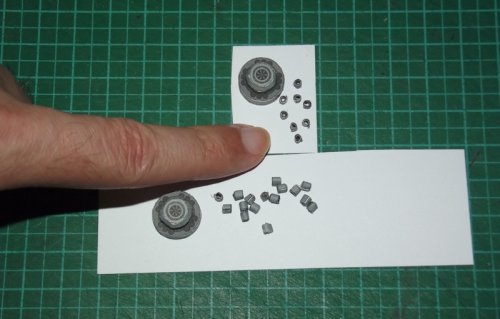

Of course this kit gave me my daily dose of self-torture, represented by this small cannon tip. :hammerhead:
There are two of them, so I had twice the fun. :hammerhead: :hammerhead:
All cannon parts in one picture. :)

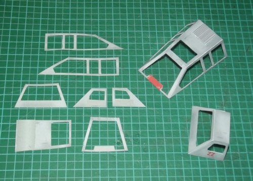

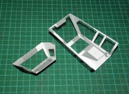

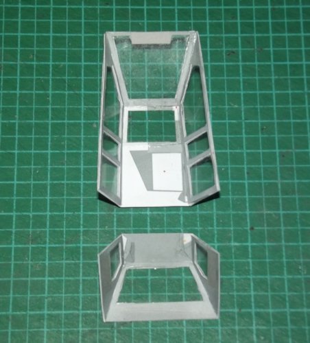

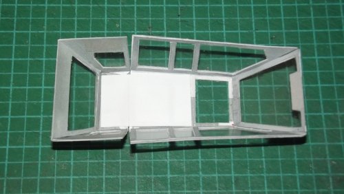

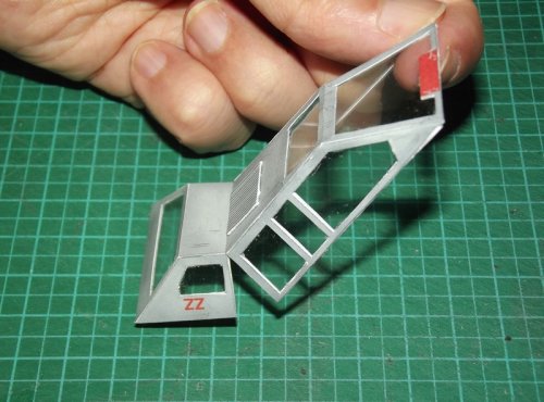

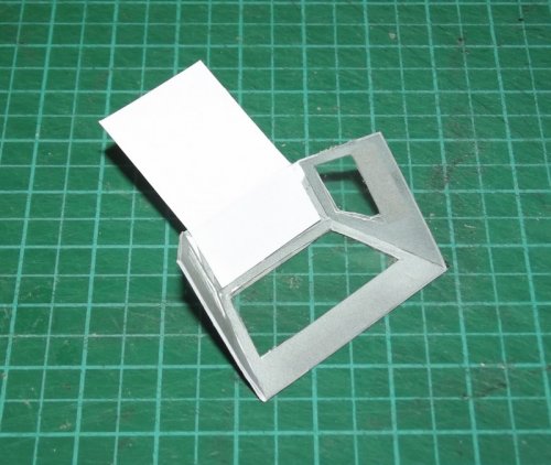

Next was the canopy.
I printed two versions but edited the pattern slightly to get all-grey plates without any markings.

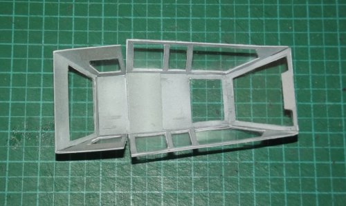

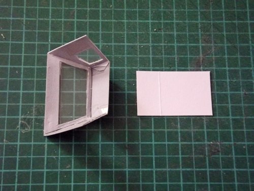

I attached some windows made of clear plastic.
A strip of left-over card was used to make a hinge.

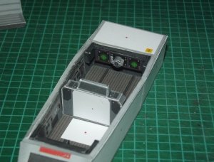

Then I covered all faces inside with the grey plates.

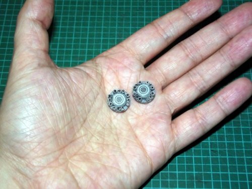

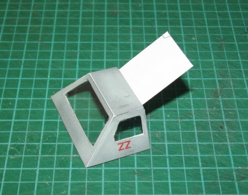

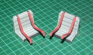

OH, I forgot to show you the thruster caps! They were pretty straight forward.
And of course, another dose of self-torture..! :D

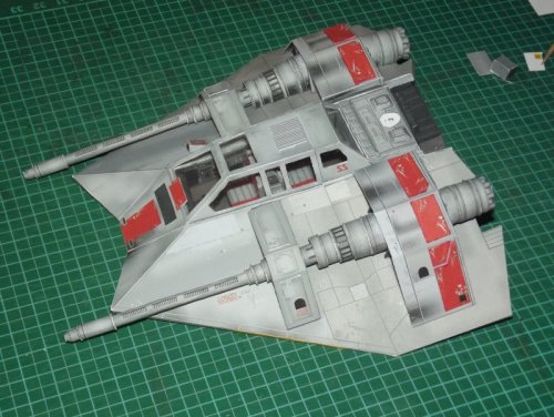

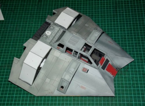

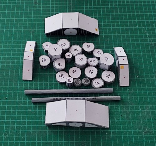

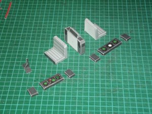

I continued with the detailing of the cannon and thruster mounts.
Julius really surprised me with this technique. To beef up the pieces he added flaps to the edges which have to be folded and glued to the back side. Usually you would simply laminate the pieces to another layer of card but I think Julius chose another approach to save paper. I haven't seen this on any other paper model. I had my doubts but amazingly it worked! :)
Another trick learned.

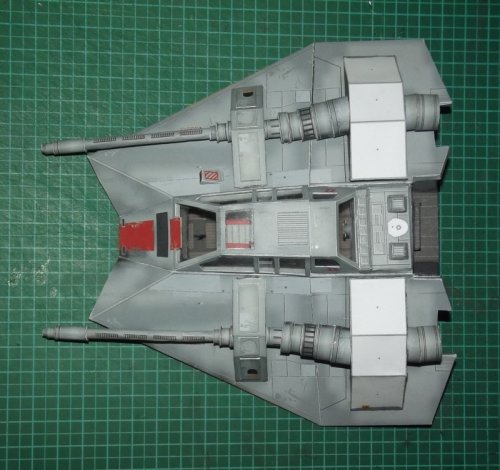

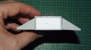

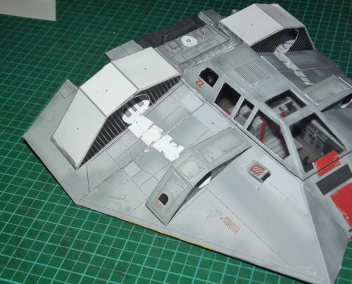

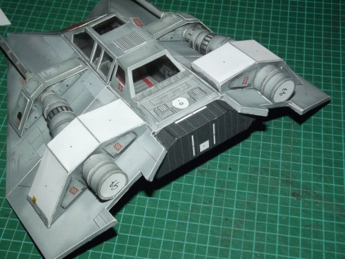

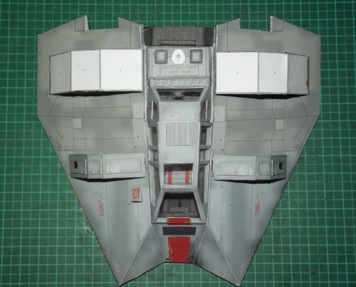

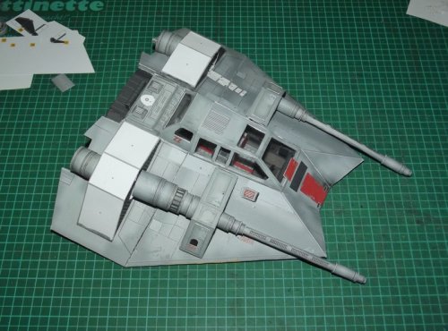

When I attached the canons and mount pieces according to the instructions and glue marks I got THIS result:
Do you see what I mean? If not, please take a look at this top view:
There is something seriously wrong here! And this was not the only issue.

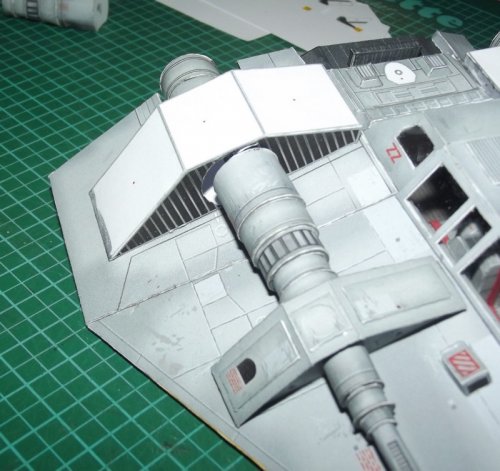

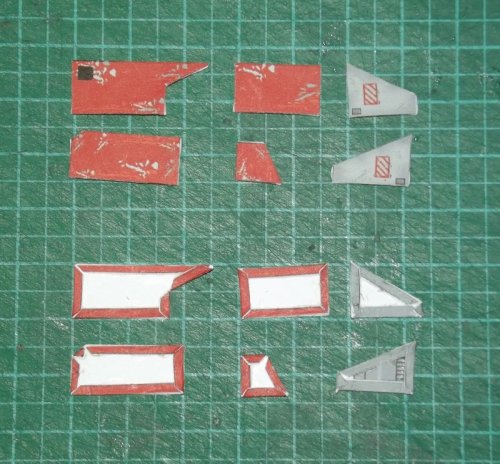

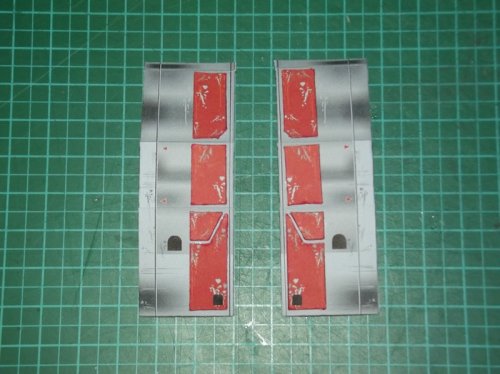

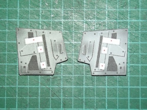

The braking flaps at the rear are the same whereas you should have one left and one right piece. Here you get two right parts.

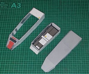

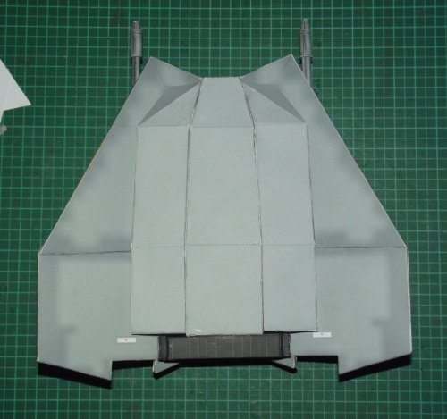

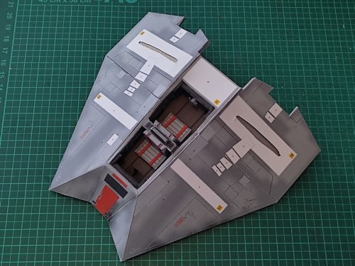

Whilst we are at the rear, the radiator block is suspiciously thin. I wondered why and turned the model around.
There is - nothing! Just grey all over. I was shocked. This was truly disappointing! :frak:
Correcting the wrong flap was easy. I printed a mirrored version of the right side and laminated it to the flap:

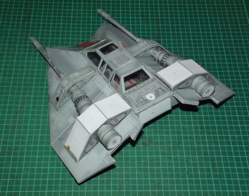

Correcting the bent in the cannons was a bit trickier. First I ripped everything off.
Then I realigned the position of the middle piece:
This image shows by how much the correct position deviates from the mark: almost 3 mm!
I moved the mark position in Gimp and restored the grill texture. Then I printed the front and back piece again and laminated it to the shoulder piece.

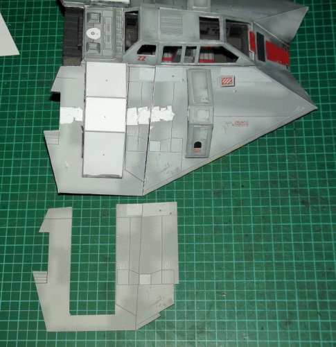

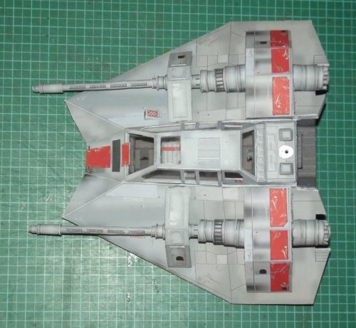

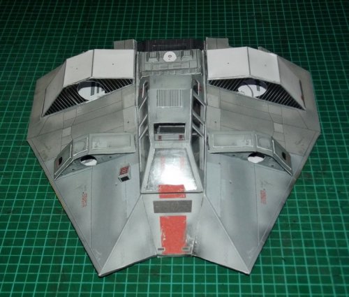

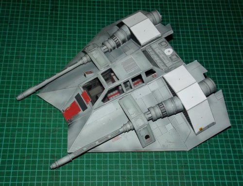

The wrong alignment marks on the wings had to be covered by a cleaned up version of the texture. This was printed on regular paper and glued to the surface. As a side effect this covered up the seam and combined both wing halves securely.
Now the cannons are straight! :)
