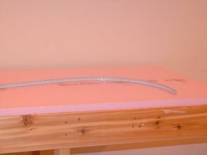

Until I invented the gizmo I did just that, using 2 inch dressmaking pins into the foam to hold the track along the center line.
When I put the gizmo on the layout lines, I wasn't impressed with the straight end of it laying parallel along the edge so I bent it into a very gentle curve and re-marked the center line of the track.
Relying on doctorwayne's evidence and realizing what I had unwittingly done, I now say yes, I do believe in easements.
Weasel clause: But I did it for asthetics adhering to a MRRing rule about avoiding track paralleling an edge.
