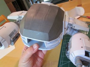

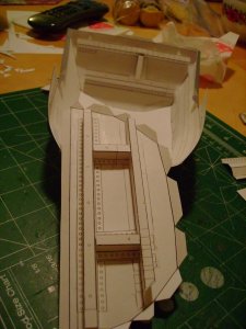

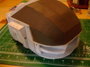

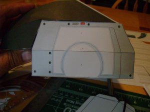

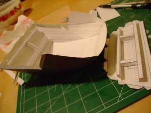

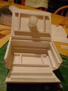

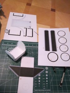

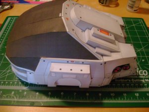

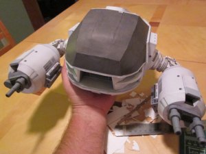

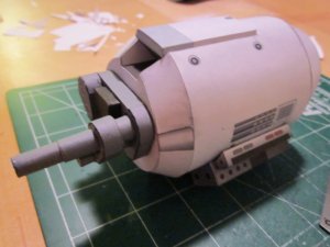

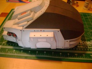

Alfadoc recently built Julius's Ed-209 and I liked it so much I knew I had to build it. I had been watching the design postings as they were being added, as soon as it was complete I downloaded it but had to sit on them a while as I was finnishing another big project.

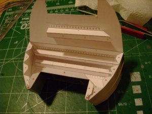

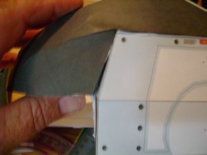

I thought I'd go into a little more detail on this build for those who may want to build it. I originally started with the main body and I guess what you'd consider the head. Be careful building the main body box, there is a difference in the angles for front and back, I didn't catch this untill too late so I had to start over and rebuild the head and main body box. Also take note, the parts are so broad there's no structural integrity,using 110 paper,(I'm building the 1/6 scale) you need to use pressure when gluing the part together, when doing so the boxes bow, bend and dent. Since I was starting from scratch I beefed up the interior of the large parts using the internal framing from the 1/4 merc capsule I recently finished, i strongly recommend doing some kind strengthening of these large parts.

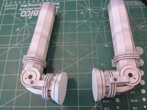

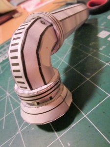

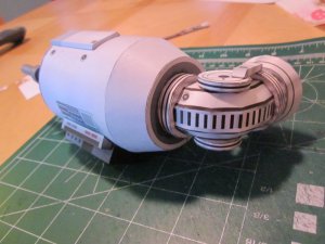

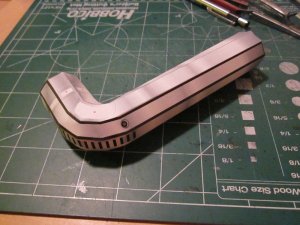

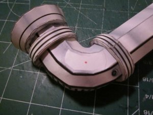

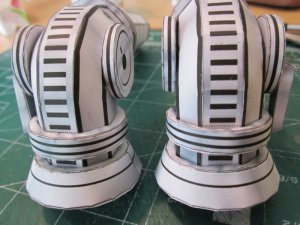

Slow going...I only have about 1 1/2- 2 hours a day to work but still making progress. Alfadoc mentioned having a slite problem with the fit of the main arm structure into the fore arm, taking this into account I made sure to build the MAS first then the rings that fit around it... good thing. I had to enlargre the holes in the rings by tracing the arm. The MAS is a bit of a challenge, it alone took over an hour, with what you see here has four hours vested. I'm sure glad there's only two of these to build.

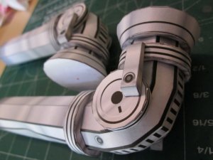

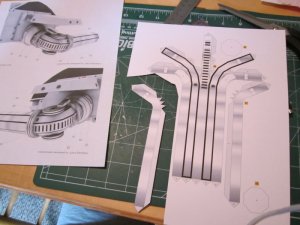

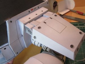

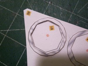

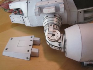

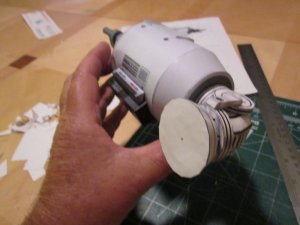

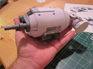

Building the MAS the second time went much easier...a heads-up for other builders, when building the MAS it consist of four pieces, the main part #'s 53,58 and three other parts, #'s 56,57,59. I highly recommend assembling the latter into one part then glueing this completed part to the main part#53-58. Models like these can be difficult due to not having an asssembly sequence. I originally built the main part first then glued in each of the other parts one by one, this is more difficult due to the angle of parts 56-57.
#2. I recommend gluing parts labeled 60-61 (arm rings) to scrap card stock to beef them up, you will need this extra stenghth when pushing the completed part onto the arm, remember these cutout lines are not an exact fit to the completed arms.
Just noticed a mistake while previewing the post, the small part attached from the elbow disc the the arm ring is placed incorrectly..easy fix.
Over all every thing is going well, it's turning out to be an enjoyable build. Will be moving on to the armaments to complete the arms.

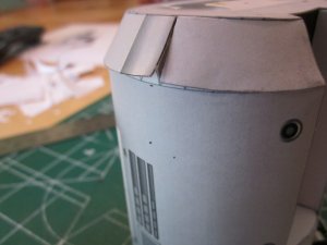

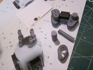

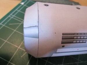

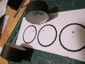

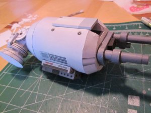

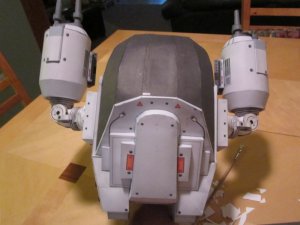

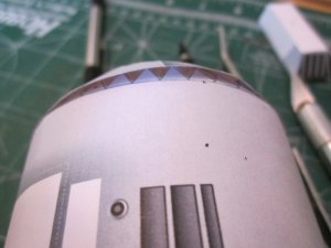

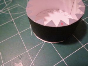

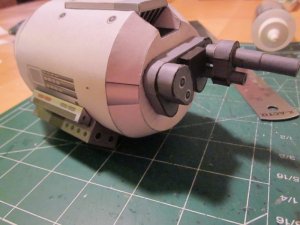

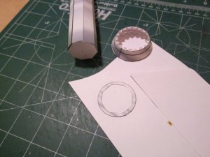

Fore arm armament complete, every thing went smooth for the most part. A few typical paper model snags, the first three pics show assembling the front cone, it was a bit big but an easy fix. In gluing parts like these together I do it in segments, by putting a split in the ring then over lapping.

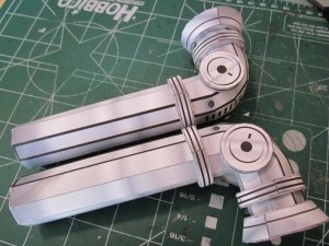

Pic #4 is the preceise reason I chose the 1/6 scale, the gun barrels and related parts are a challenge, I couldn't imagine doing this in a smaller scale.

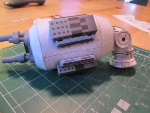

Moving right along. Every thing going together well. No problems with parts fitting together or structural integrity.

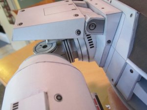

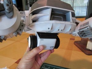

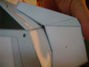

Shoulder flaps completed and installed, starting on the pelvis section.

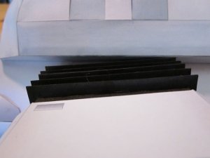

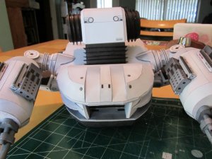

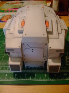

Pelvis section complete...piece of cake. The only problem I ran into was the outer circles for the hip joints, they'er a little larger than the circle strips they attach to. It's really not a big deal as they are glued to the main hip part and to the leg.
I doubled up on the bellows ribs which I highly recommend doing.
I originally thought there would be some pivoting movement between the upper body and the hip section, but as you can see the movment is minute, so I will be gluing this when complete.
