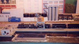

Here are some pics of what can be found along the river bank near Kings Port on my layout. First we see an RS3 setting out a short string of open hoppers to be loaded with coal by crane from the barge below. This company called Allied Bulk Commodaties (ABC) also loads sand and gravel as will be seen later. In the background is the famous Vandelay Industries.

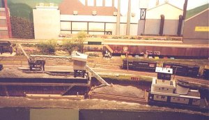

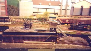

Moving to the right we can see the conveyor system for unloading sand and gravel with a barge of gravel below tied up and about to unload. Parts of Kings Port Steel are pictued in the background.

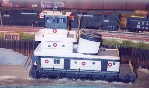

A close up of the Susan J. She's made of wood blocks, a plastic box that some screws came in, and a pair of hand held pencil sharpeners.

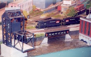

Moving farther to the right we see the Sumpter Ave. lift bridge and mouth of the Sawyerkill Creek that empties into the river.

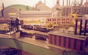

Finally, this shot gives a good view both of Kings Port Steel in the background and most of Mid River Power and Light up front. Hope you enjoyed the tour! :wave:

I really like your retaining wall, especially the second photo that shows the stairs. I'm going to need one of those for my harbour scene, and was wondering if you could tell us how you made it. Is it a kit or scratchbuilt? It sure looks good.

Val, I made the retaining wall out of wood and covered it with thin corrugated cardboard, the kind that is flexible enough to roll up. It seemed perfect as a sea wall, very like some I've seen in the real world. I spray painted the cardboard black prior to installation and used a ruler to help me mark a high water line that I represented with brown and rusty colored chalks.
The concrete section at the bottom of the stairway is just a piece of wood, smeared with joint compound, sanded smooth, and tinted with Woodland Scenes coloring.
A little strip wood was used as the top trim.
