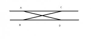

In the drawing below, there are four possible routes:
A-C & B-D (or reverse)
A-D & B-C (or reverse)

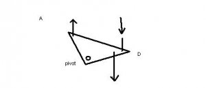

Turnouts A & D and B & C must always be thrown in those pairs, so... you need some sort of device to do this. I think it could be done with the "choke cable" approach, and a (large) triangular plate (or at least rigid wire frame) to provide the opposing movements that are required. I.e. A's points have to move "north" and D's points have to move "south" in order to make the crossover from one track to the other.
This approach would require two throws, but only one at a time would need to be activated to make a cross from one track to the other.

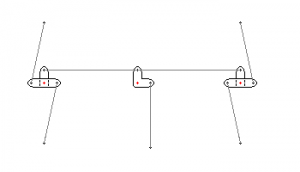

Building on Andrews approach, you could do it all with a single throw.

Err, looking back at my diagram, the cam on the left is hooked up backwards. The stiff wires should be swapped, so they are the same as the one on the right.
Hi,
With any mechanical set-up. as drawn by King (& revised), you have to make sure there is no "slop" in the linkages, and that you get some mechanical advantage by hooking up the "input" on the outermost holes of the bellcranks, and the "output" (the ones going to the turnouts) on the inner holes (closer to the pivot point).

steamhead said:
Hi,
Good luck!!!
If you use Peco turnouts as Miles suggested with AlienKing's sugesstion for a linkage, the Pecos will use the built in overcenter spring to lock into the correct position even if there is a little bit of play in the mechanism.
